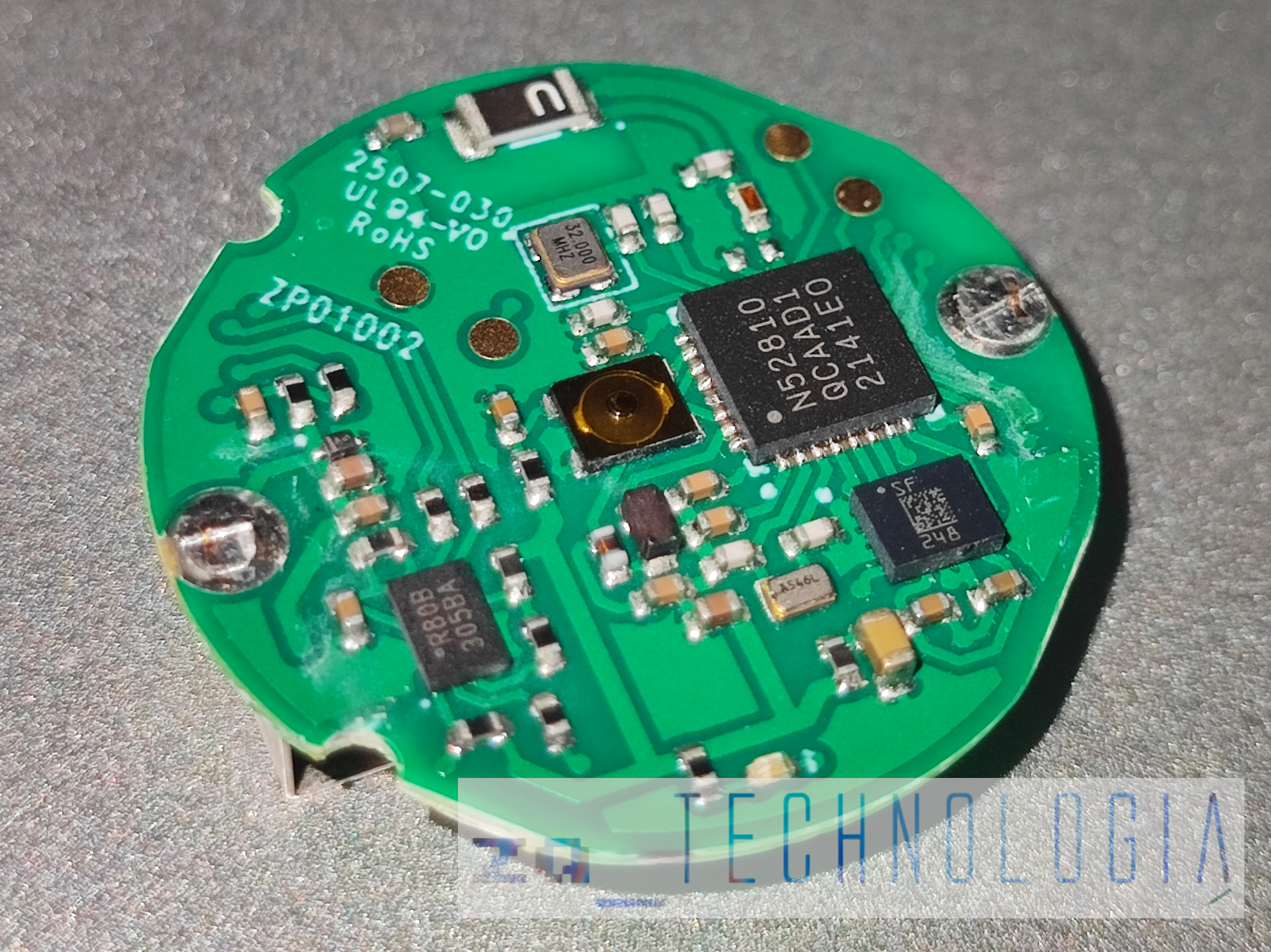

    Hi everyone, today I’d like to show you the inside of the controller Tricks , which has become the flagship product of the green amphibian retail chain. It allows you to play games via the chain’s dedicated app.
    Inside the Triki motion controller and a bit of reverse engineering

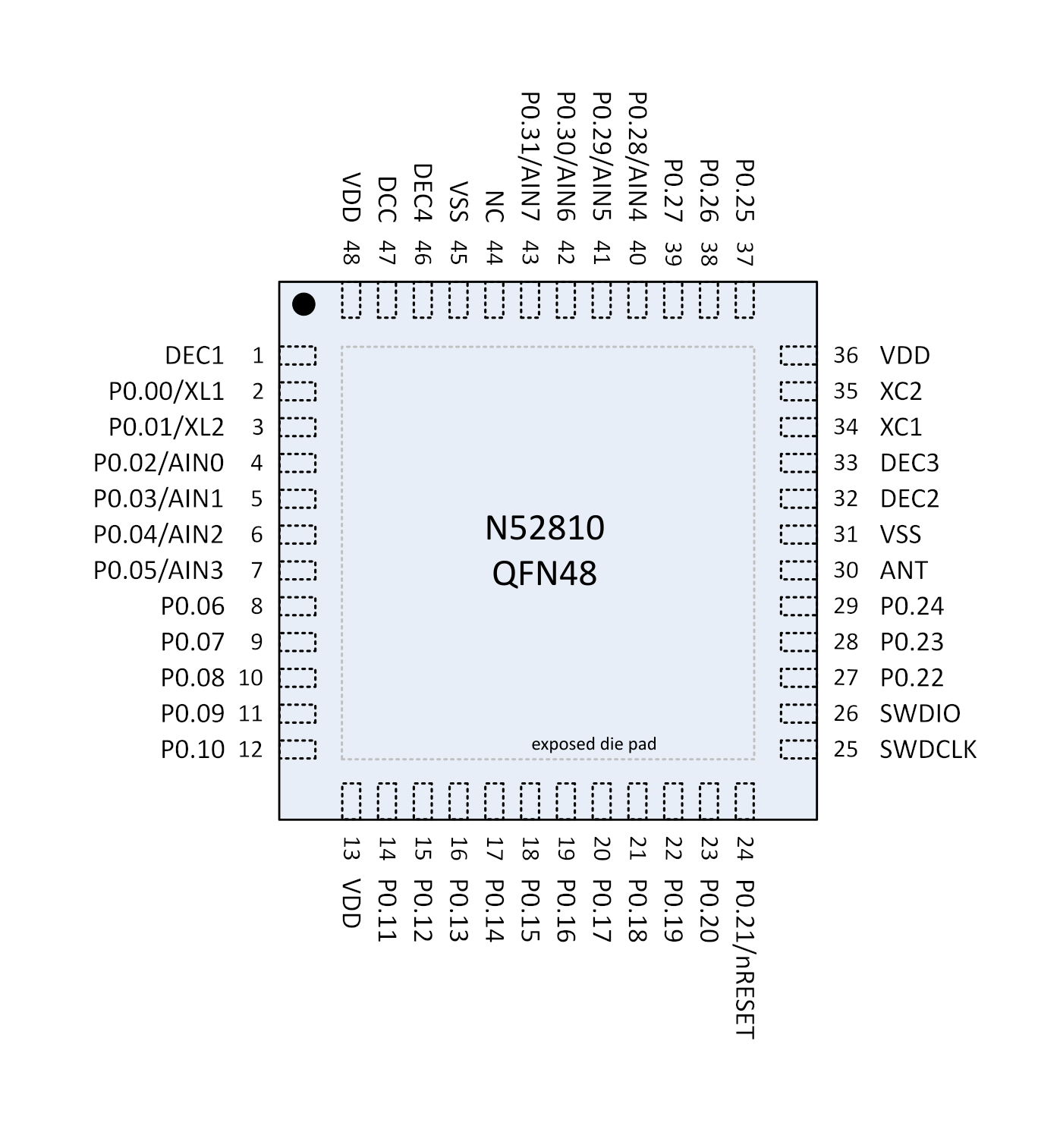

    As we can see in the photo above, at the heart of the device is the SoC chip nRF52810 from Nordic Semiconductor, an energy-efficient Bluetooth Low Energy (BLE) microcontroller based on the ARM Cortex-M4. It is very popular in small IoT devices and wireless accessories. The chip is locked, and to unlock it, you need to erase its contents.

    The MEMS sensor is the SF 248 (probably LSM6DSL)  , unfortunately, I haven’t been able to find any datasheet or even a mention of it online.

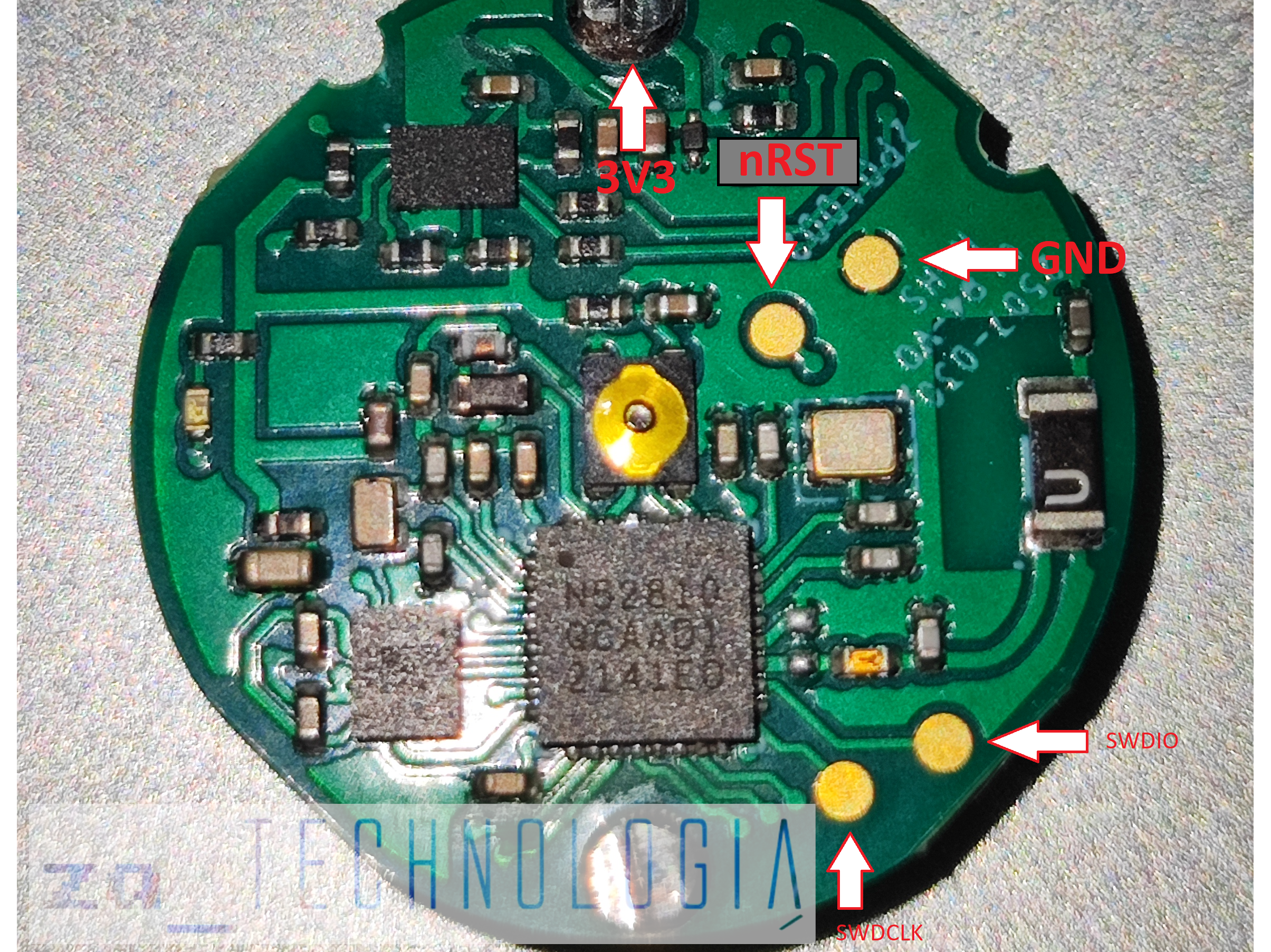

    On the PCB, there are exposed programming pads, Unfortunately, I don’t yet have a J-LINK programmer to confirm my speculations regarding the pinout, so please take this with a pinch of salt.

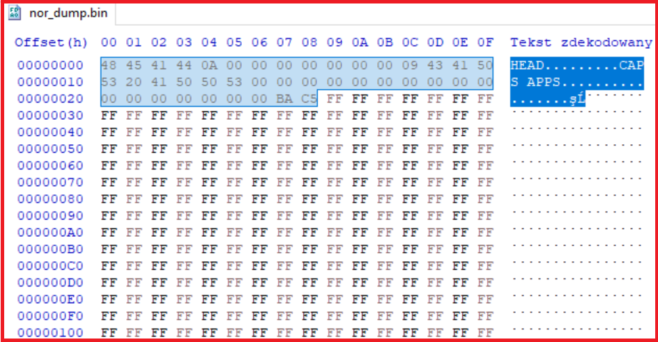

    Interestingly, the board also features a FLASH memory chip, according to a dump from the user’s GitHub Piwencjusz R80B..... R80X..... ( 1MB Macronix MX25R8035F ) with some very interesting content; apart from the header shown below, the rest is filled with nothing but ‘FFs’, which might give us plenty of scope for DIY projects.

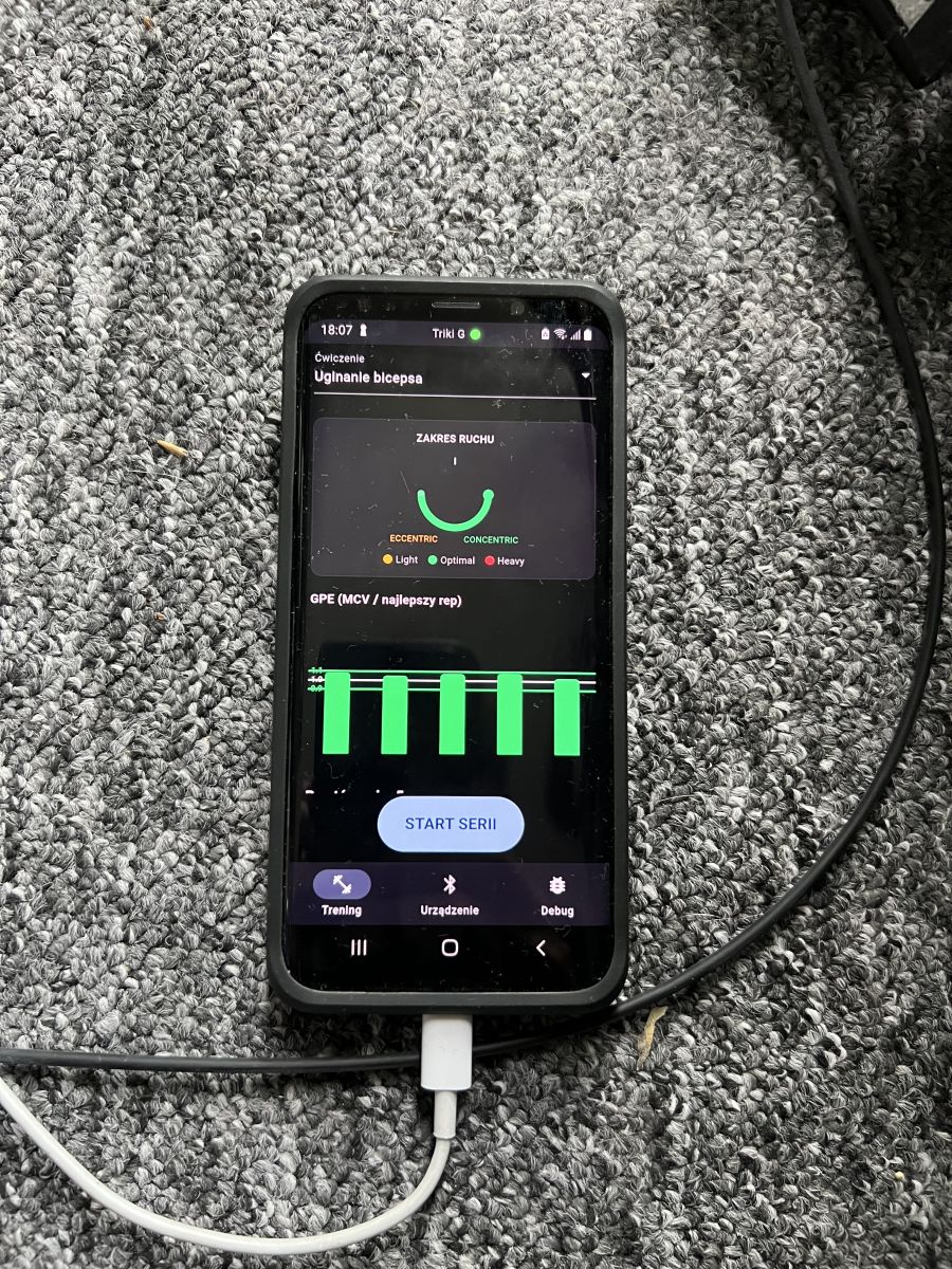

    Below are some example videos of what we’ve managed to achieve so far:
    I won’t hide the fact that I used AI whilst working on this issue, as I’d never had any experience with the Bluetooth protocol before, although it seemed to me that it would be quite similar to Wi-Fi. Attached is an example keyboard and an HTML5 car game, in case anyone fancies having a go. In the future, I want to create a library that interprets the data and make it available so that everyone can have a go, and perhaps find a creative way to use this interesting invention. If anyone’s interested, feel free to check out my YouTube channel: #ZaTechnologią
