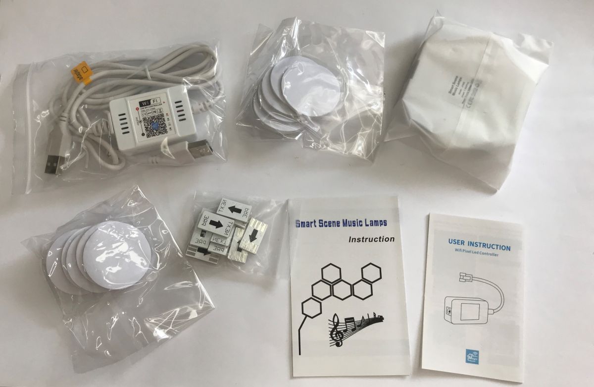

We imported the kit from China for just under 100 PLN. It would have cost considerably more here in Poland.

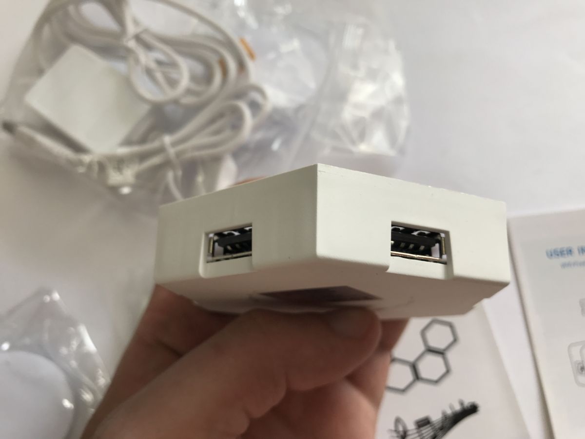

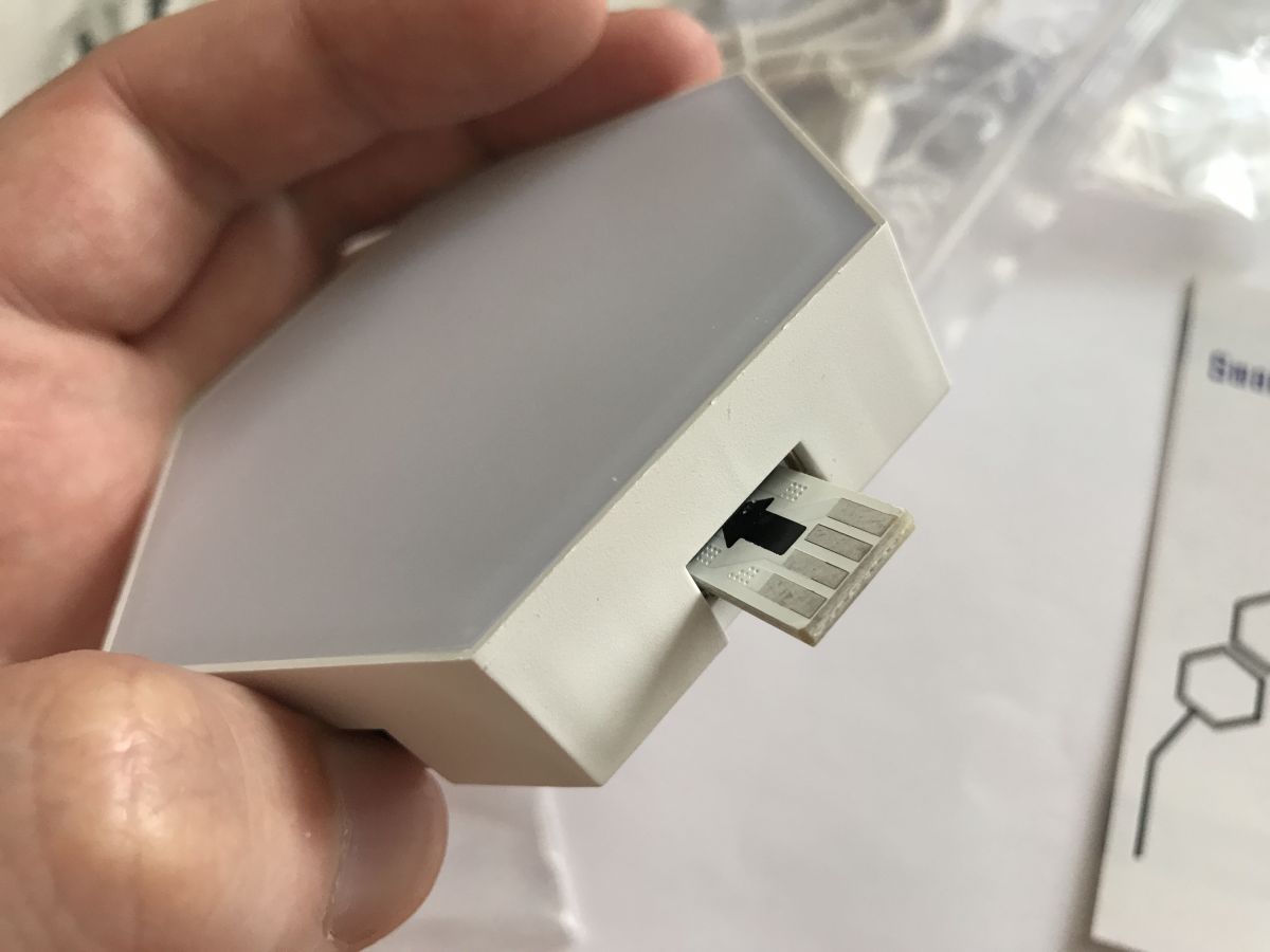

The set consists of panels measuring 88 by 78 mm and 18 mm thick. They can be joined along any edge, so you can build a wide variety of shapes with them.

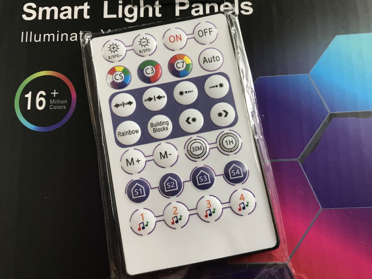

The set includes instructions, a remote control, a controller, connectors (12 pieces), mounting tape and LED panels (12 pieces – one is visible in the photo).
The first drawback that strikes me is the lack of buttons on the LED controller itself. So you can either control it via the remote or via Wi-Fi. Instructions:
The great thing is that you can ‘split’ the LED signal into several branches, as the instructions clearly demonstrate. They also mention pairing and the Magic Home app, which I decided to give a go.

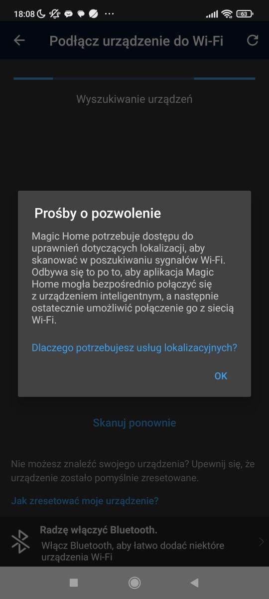

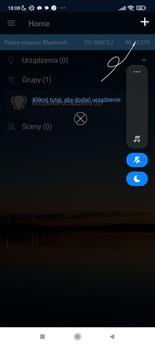

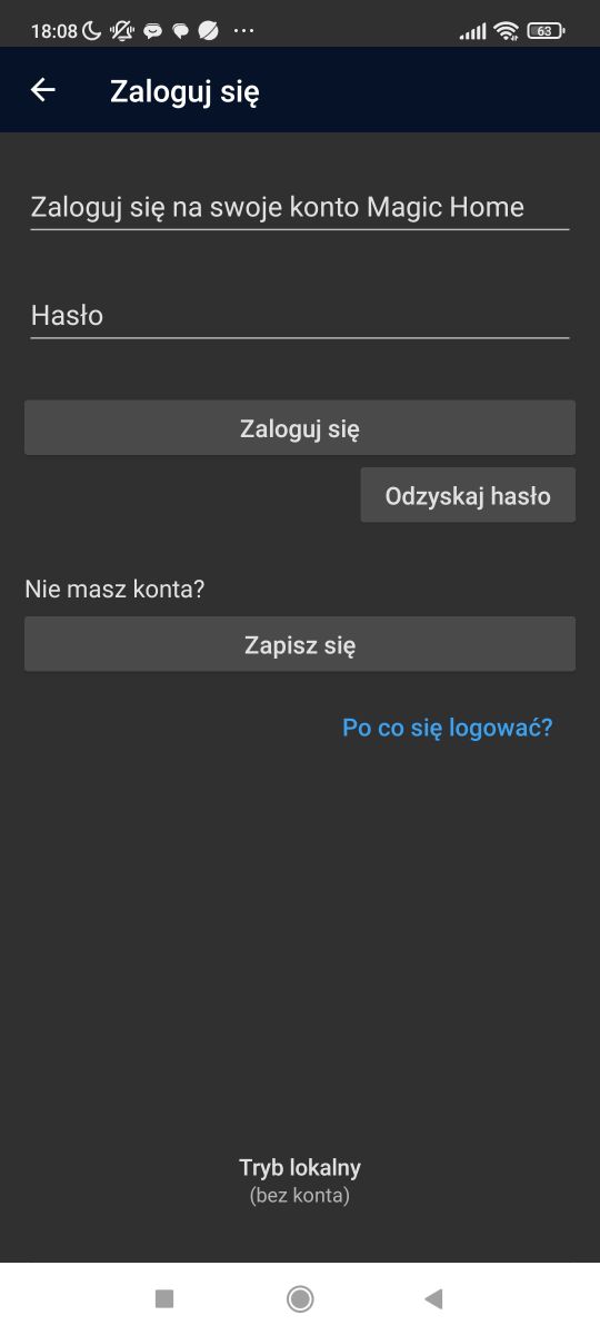

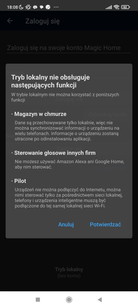

Unfortunately, and rather strangely, even after switching on Bluetooth and the device being detected, I am unable to pair it with Wi-Fi. To be more precise – the device connects to my wireless network and appears in the DHCP list, but the app reports a pairing failure and no longer detects it. I’ve tried pairing it again by putting the controller back into configuration mode via several power cycles, but to no avail. Incidentally, the LEDs in pairing mode will display a slow colour animation:
Discouraged by the pairing failure, I turned my attention to our Electrode firmware . It is uploaded via the USB-to-UART converter .

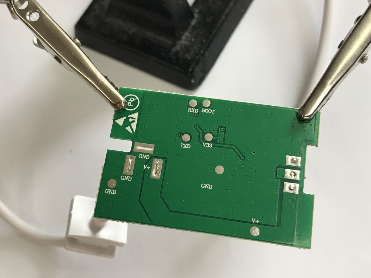

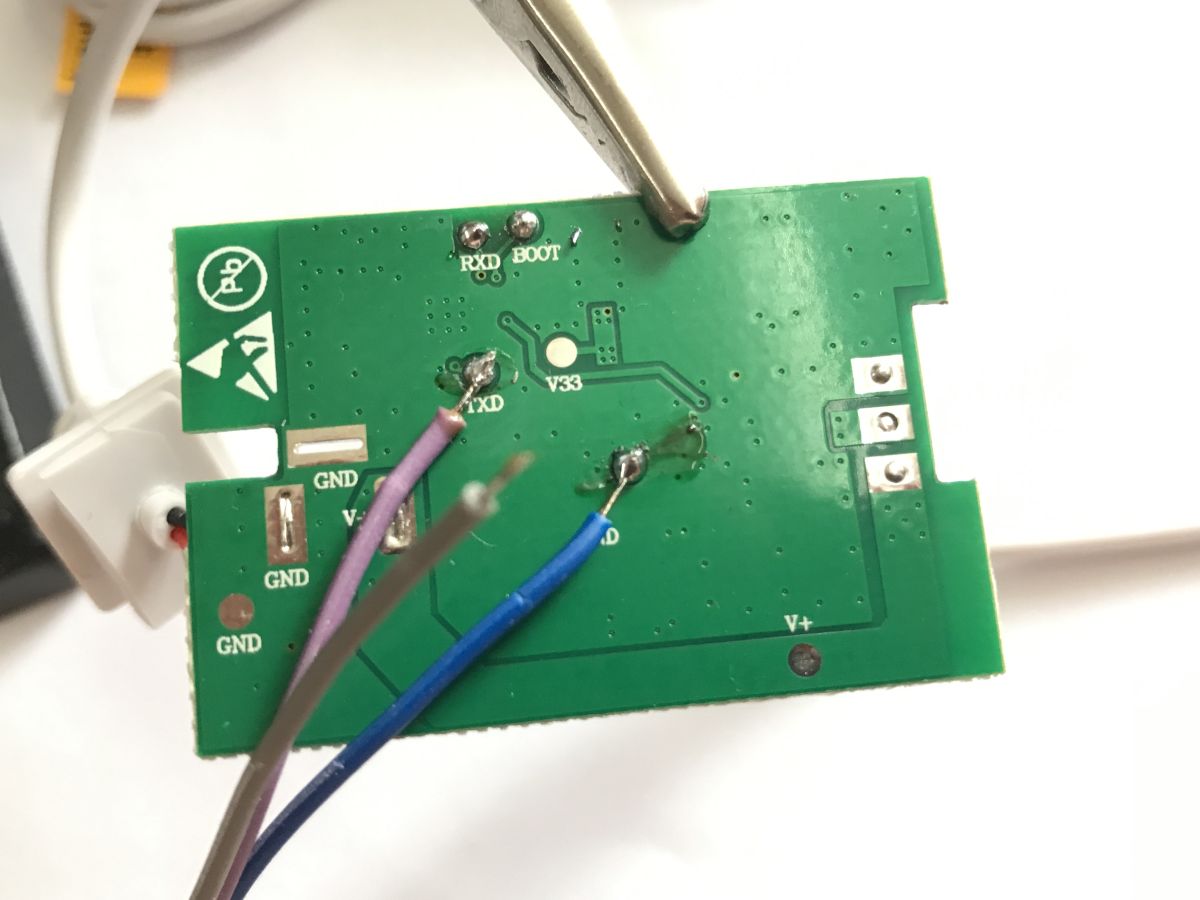

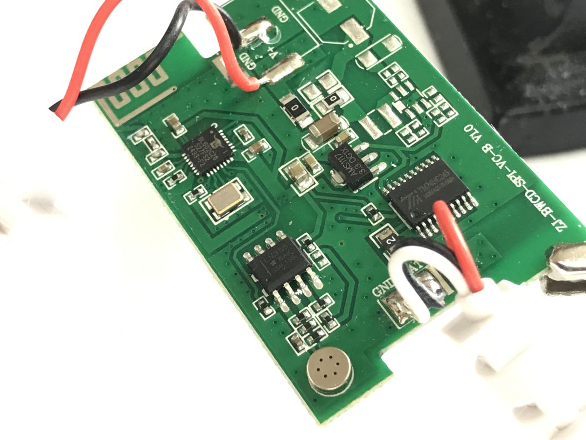

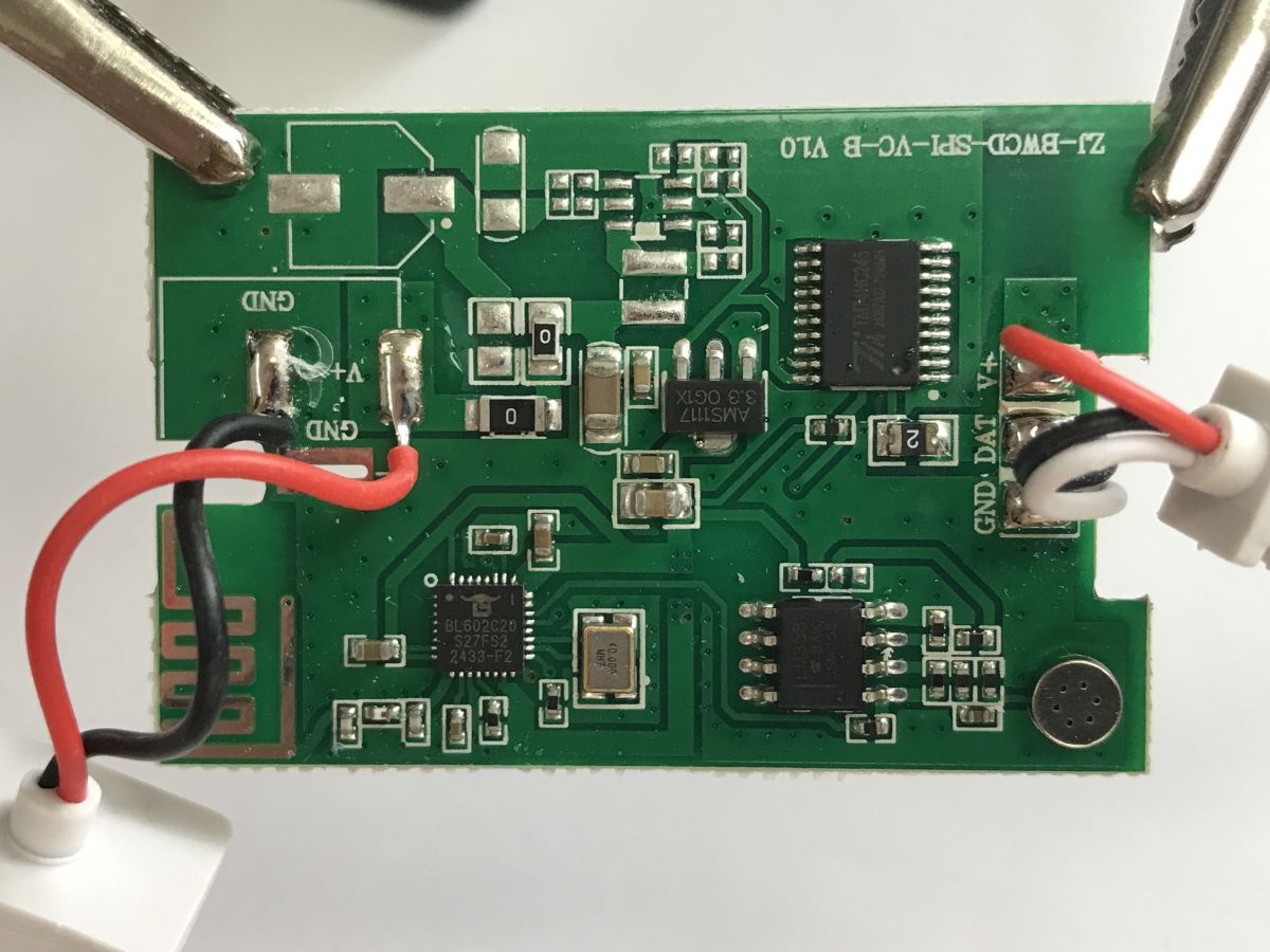

So I took a look inside – let’s see what controls the LEDs! You just need to pry open the casing; it’s best to do this where the cable comes out, as there’ll be fewer marks.

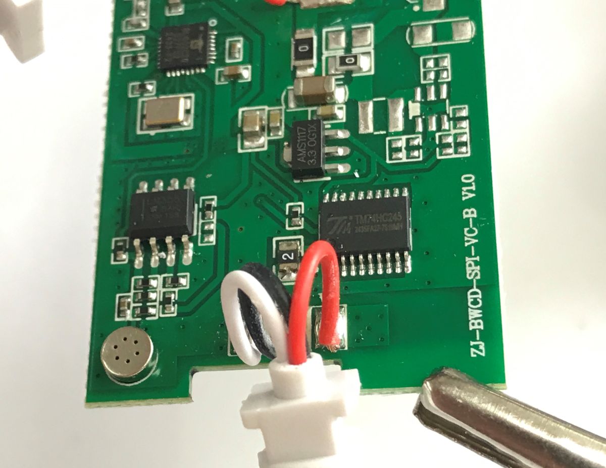

The controller is based on BL602 , meaning it’s supported by OBK . In addition, there is an AMS1117-3.3V to power the entire circuit – the designer was able to include this as the whole system operates at 5V. Furthermore, it is clear that there is space on the board for a DC jack and a step-down converter, so a 12V version may also be in production. Separately, you can see an LM358 operational amplifier, paired with a microphone, for reproducing lighting effects in time with the music. And right next to the LEDs is a 74HC245 buffer. PCB designation: ZJ-BWCD-SPI-VC-B V10.
There are three wires connected to the LEDs – ground, power and data. This strongly suggests that we are dealing here with some form of WS2812 – which comes as no surprise, as how else could such a large number of pixels be indexed?
PIC18F45K50 as a WS2812 LED strip controller (theory + library)
Furthermore, the SPI in the board’s name confirms this – these LEDs are best controlled via hardware SPI; in fact, SPI is used to simulate the generation of the control signal.
Controlling WS2812 LEDs via SPI with DMA – using MOSI to generate timing signals

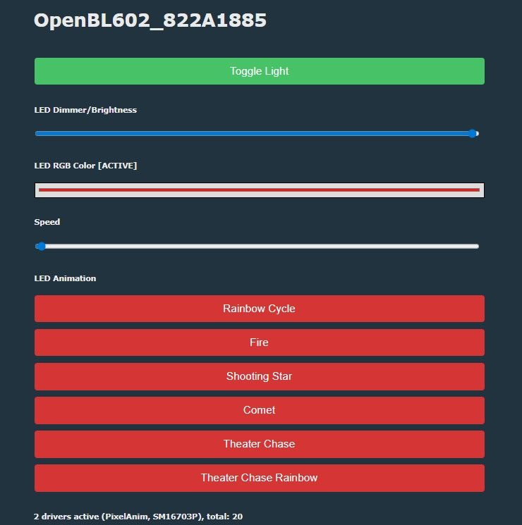

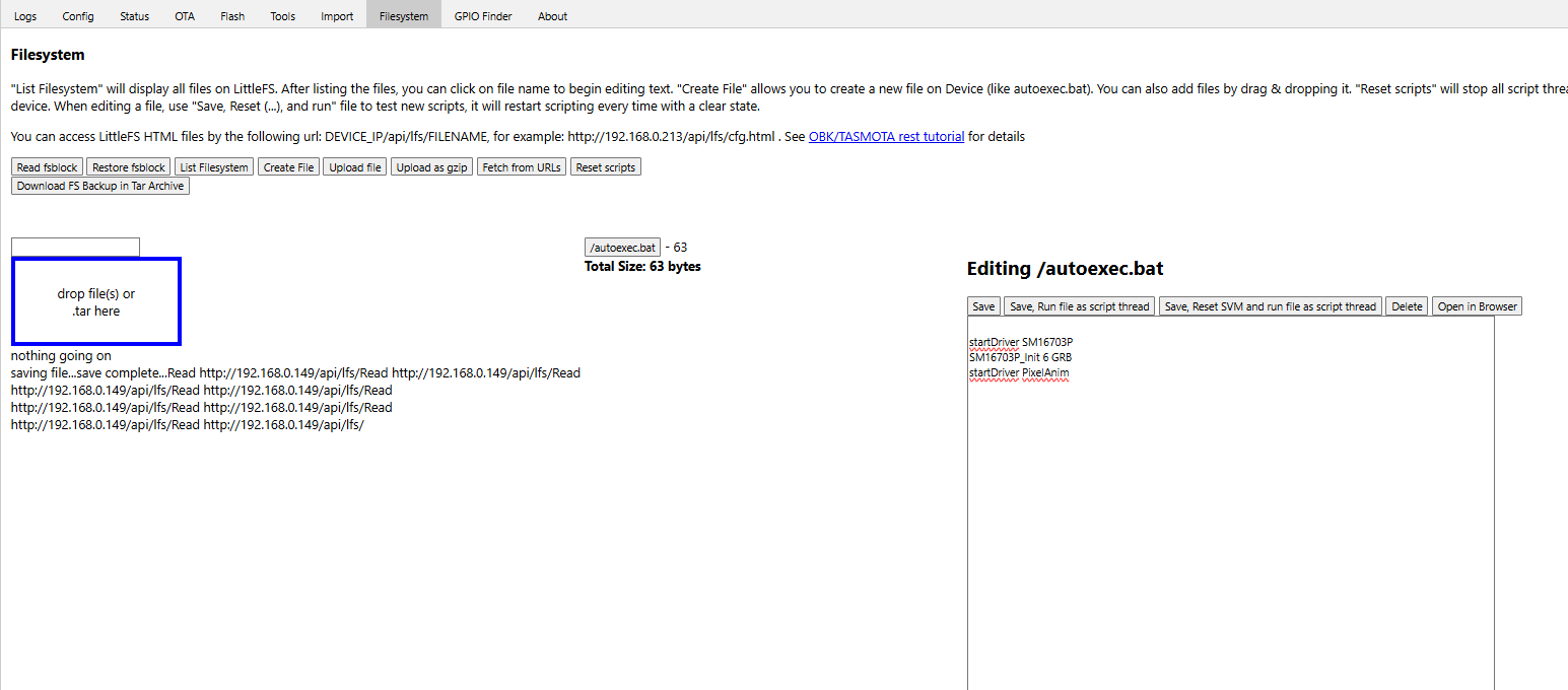

This is exactly how the WS2812 controller in OpenBeken works. Now all that remains is to flash the firmware. The pads for this are on the underside of the PCB.
So, according to our documentation: How to read and back up the flash memory of a BL602/BL702/etc device using BLDevCube?
Tasmo alternative for the BL602, programming, pairing with Home Assistant
The thing is, by 2026 we’ll no longer be using BLDevCube; instead, we’ll have our own solution for flashing the BL602 and similar devices:
Before that, however, I collected a boot log from the TX pin at a baud rate of 200000. Here it is, just after boot-up:

What’s more, you can see that the device then obtains an IP address from my router, so why isn’t the pairing working?
[data]: 0000-000F: 04 06 80 00 00 B9 BA 07  7B 22 63 6F 64 65 22 3A    ........{"code":
[data]: 0010-001F: 30 2C 22 70 61 79 6C 6F  61 64 22 3A 7B 22 4D 41    0,"payload":{"MA
[data]: 0020-002F: 43 22 3A 22 37 43 33 45  38 32 32 41 31 38 38 35    C":"7C3E82A1885
[data]: 0030-003F: 22 2C 22 69 70 22 3A 22  31 39 32 2E 31 36 38 2E    ","ip":"192.168.
[data]: 0040-004F: 30 2E 31 34 39 22 2C 22  4D 49 44 22 3A 22 41 4B    0.149","MID":"AK
[dat]]: 0050-005F: 30 30 31 2D 5A 4A 32 31  34 39 22 2C 22 4D 41 43    001-ZJ2149","MAC
[data]: 0060-006F: 49 44 22 3A 22 32 32 31  42 35 37 43 34 35 44 44    ID":"221B57C454D
[data]: 0070-007F: 43 46 36 31 35 41 32 44  45 46 35 45 38 31 46 37    CF615A2DEF5E81F7
[data]: 0080-008:: 43 34 35 36 36 22 2C 22  4C 41 4E 63 6F 64 65222    C4566","LANcode"
[data]:0090-009F: 3A 30 2C 22 57441 4E 63  6F 64 65 22 3A 31 2C 22   ::0,"WANcode":1,"
[data]: 00A0-00AF: 6C 76 65 72 22 3A 22 41  33 5F 35 32 5F 32 30 32    lver":"A3_52_202
[data]: 00B0-00BF: 32 30 38 31 36 5F 5A 47  2D 42 4C 2D 35 56 22 7D    20816_ZG-BL-5V"}
[data]: 00C0-00CF: 7D                                                 }

This didn’t explain to me what was going wrong, so I eventually flashed the OBK. A copy of the flash image:
https://github.com/openshwprojects/FlashDumps/commit/be57fdf1fdab3887ba84703bc2f69dc2a4963678
Once the OBK has been uploaded, an access point appears straight away and you can configure the batch as usual (192.168.4.1, then enter the WiFi SSID/password, select the pins):
You still need to configure the pins and autoexec.bat – you can do this following the tutorial .
OpenBeken (OpenBL602) correctly supports these LEDs via the SM16703P (WS2812) controller, which ultimately proves their compatibility with this popular protocol. You can now connect further sections and play your own animations directly from the device itself , HA or via DDP .
It’s also a no-brainer to add the missing button – after updating the firmware, this can be easily configured via the UI:
You can also add an IR receiver and control it using your TV remote:

divadiow 25 Jun 2026 21:16
paired OK for me https://obrazki.elektroda.pl/8418491000_1782414976_bigthumb.jpg [Read more]
p.kaczmarek2 25 Jun 2026 21:27
Did you log in? Maybe I should have logged in first, but still, it supposedly works without an account... [Read more]
divadiow 25 Jun 2026 21:30
I appear to be in local mode. not logged in https://obrazki.elektroda.pl/5286137800_1782415833_thumb.jpg [Read more]
p.kaczmarek2 25 Jun 2026 22:13
Strange, and you did it via Bluetooth? I tried like 3 times and gave up. [Read more]
divadiow 25 Jun 2026 22:16
negative. joins with bluetooth disabled. Wifi AP 'LEDnet...' broadcasts [Read more]
p.kaczmarek2 25 Jun 2026 22:18
Ahhh.... I was referring to Bluetooth pairing. That's what I tested and used. I was able to see it received my WiFi SSID and password, and joined it briefly enough to show up in DHCP, but then was dis... [Read more]
