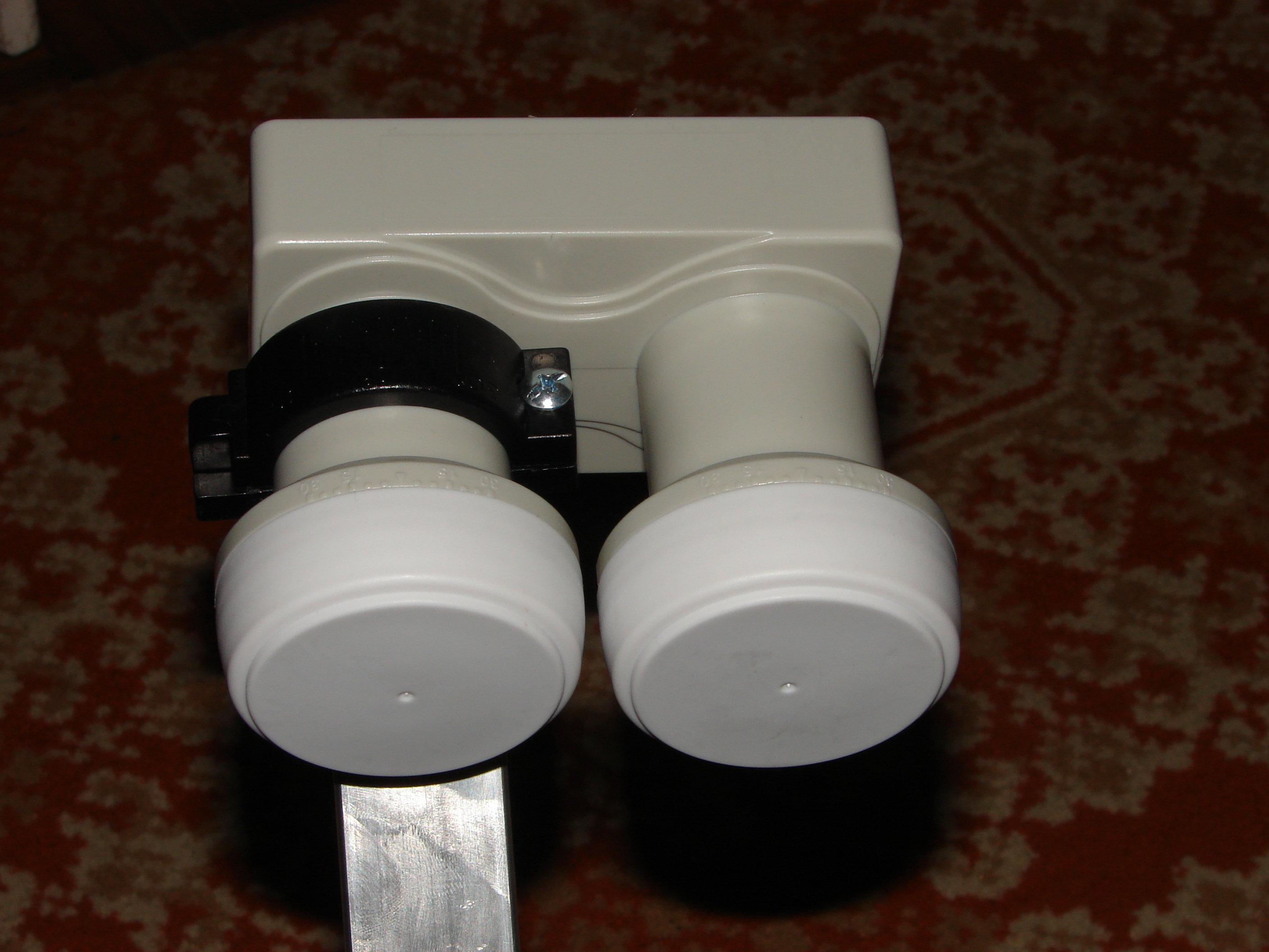

    Zbyszek_59 wrote:
    I had the antenna tuned to HB. I bought a monoblock twin converter and I receive HB and Sirius without turning the antenna. What to do to receive HB and Astra?
    Thank you in advance and ask for advice.
    You probably screwed the monoblock wrong, the main one on the left on the HB and on the right on the Astra (standing behind the antenna).

  • #33 7169884
    pajo21
    Level 35  
    Posts: 2257
    Help: 259
    Rate: 173
    You have mounted the monoblock not for the "eye" you need, as mentioned by your colleague above.
  • #34 7172804
    Zbyszek_59
    Rate: 19
    When facing the plate, it is mounted on the left side
  • #35 7172937
    pajo21
    Level 35  
    Posts: 2257
    Help: 259
    Rate: 173
    Mount it on the right.
  • Monoblock alignment requires an 80 cm dish for 6-degree spacing
    #36 7199283
    piszcza
    Posts: 97
    Help: 6
    Rate: 12
    You did not catch this "neck" ;) If you catch the latter, you will have HB and Astra. HB is still centrally positioned. Twin monoblock is adapted to antennas fi 80cm (+/- 5cm) - then there is a difference of 6 degrees between the satellites. If you're 60, you might have a problem.

  • #38 7564520
    jugo18
    Rate: 7
    Hello!
    I am starting my adventure with satellite TV and I am asking for some necessary advice ... :)
    I bought a TNK starter and their decoder, a fi 85 antenna and a monoblock conventer .. I want to receive programs from HB and asters on this set .. How would someone write what angles to set the antenna with and how to set the conventer (I'm from Rzeszów) for which head to catch and does it have to be in the center of the antenna? I'm sending a photo of how I did it temporarily at home.
    Setting Up Satellite Dish: HotBird & Astra, Ferguson FX-6600 Tuner, Golden Interstar GI-201 LNB
    best regards and please answer me quickly, Michał
  • #39 7564561
    dzac4
    Level 36  
    Posts: 3041
    Help: 236
    Rate: 229
    You mounted it well.
    You need to set the correct operation of the switch only in the decoder settings.
    And when you do the search option, you will find what you need.
