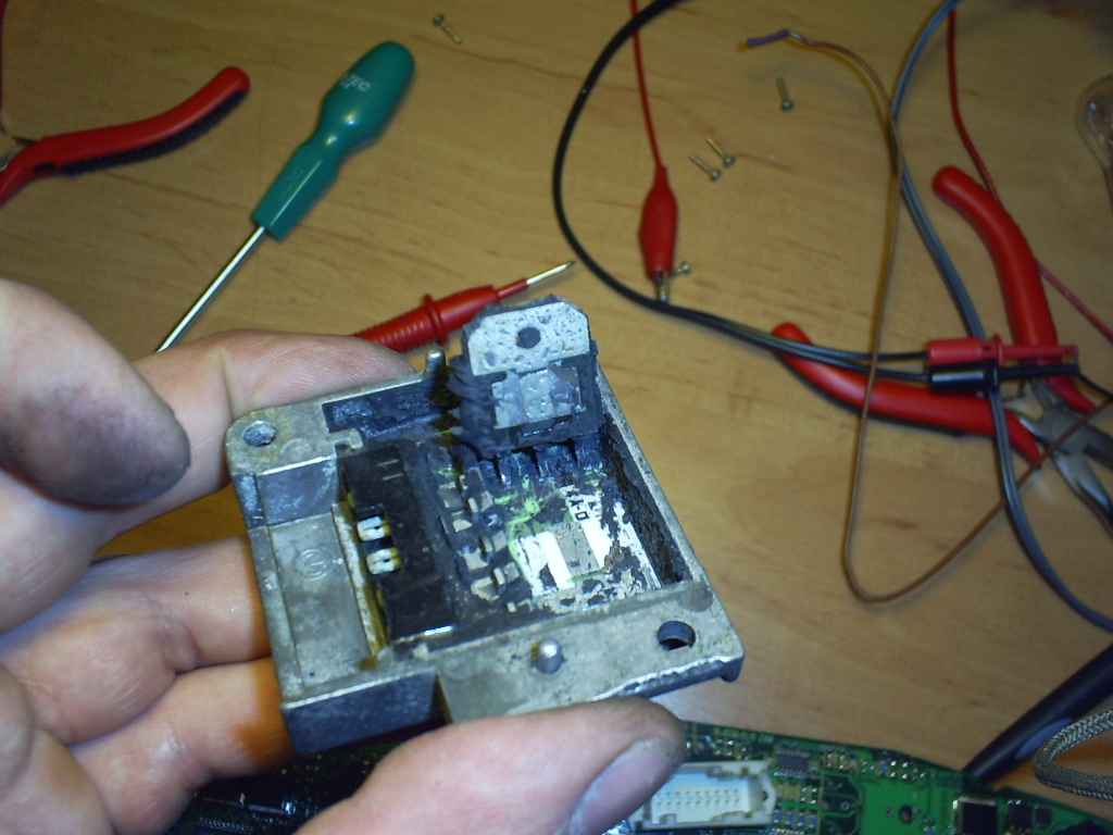

    Recently, I fixed the module in my uniak.
    Maybe the komus will be useful as it looks inside.
    Module UNO 1.0 BKL44 Internal Components: Transistor BU931ZP & L484 System in Uniak Repair
    Transistor BU931ZP and the L484 system are probably the most important elements.
    Symptoms of bad work: After heating, the car could go out in idle mode eg under the lights at the intersection and I could not run it for example a minute before it cooled down a bit.
    I improved February

    was this module flooded inside?

    covered with silicone or rubber, I had to scrape it.

    Once I repaired I was repairing polonez modules, they were quite easy to repair and were also flooded with some strong silicone and a lot must be naskubać, so I asked out of curiosity.

    The module works, so in spite of the time devoted to picking out the rubber and improving solders, I did not incur any costs. The pen was left in your pocket :-)
