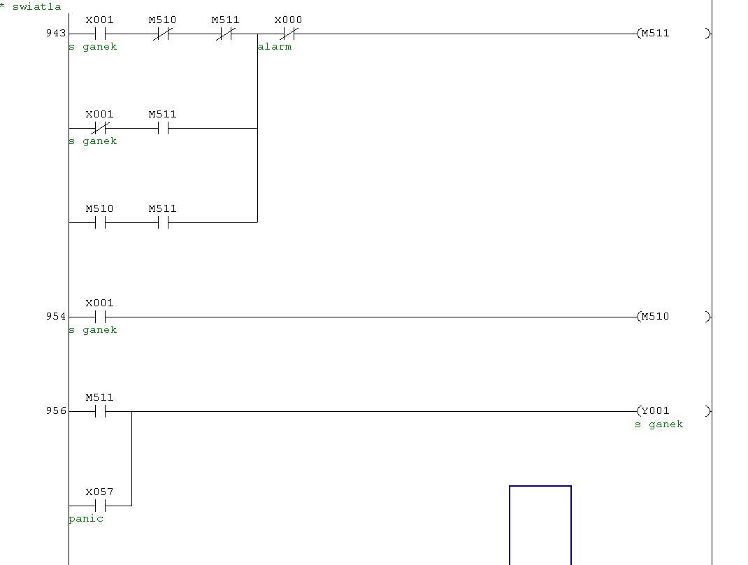

    The delay works brilliantly; I had to set the timer to 2 seconds (at 0.5 seconds the relays were cutting out)
    I’m starting to connect everything and more problems have cropped up:
    when the alarm is armed (x6 active), the lights cannot be controlled; whereas when the alarm is disarmed (x6 inactive), the roller shutters cannot be controlled using their individual buttons

    Two seconds is quite a long time. What happens when controlling the blinds using the buttons, if you quickly press a button twice whilst the blind is moving in one direction (i.e. stop and then move in the opposite direction)?
    The alarm functions are triggered upon detection of a 0→1 or 1→0 edge on the alarm status input. Once the state is stable – whether it’s 0 or 1 – it shouldn’t affect the operation of the rest of the system. Check that you’re definitely using flags (m something) everywhere, rather than just the alarm state x6 itself.

    jestam wrote:
    2 seconds is quite a long time. What happens when controlling the roller shutters with the buttons, if you quickly press a button twice whilst moving in one direction (i.e. stop and move in the other direction)?
    Stopping and immediately reversing direction could, in theory, also damage the relay.
    The inability to control the roller shutters when the system is disarmed was due to the common ‘neutral’ being connected incorrectly; I’ve connected it correctly now and it works fine – just the lights left to sort out. as you’ll recall, I’ve set it up so that when the alarm is armed, all the lights are supposed to switch off – and they do – but it’s not possible to switch them back on at that point (which is needed when arming the alarm at night whilst the family are at home)

    In August you wrote that the lighting was working – has anything changed in the lighting control system since then? Please paste the relevant section of the programme (make sure to label the variables!), and I’ll have a look at it.

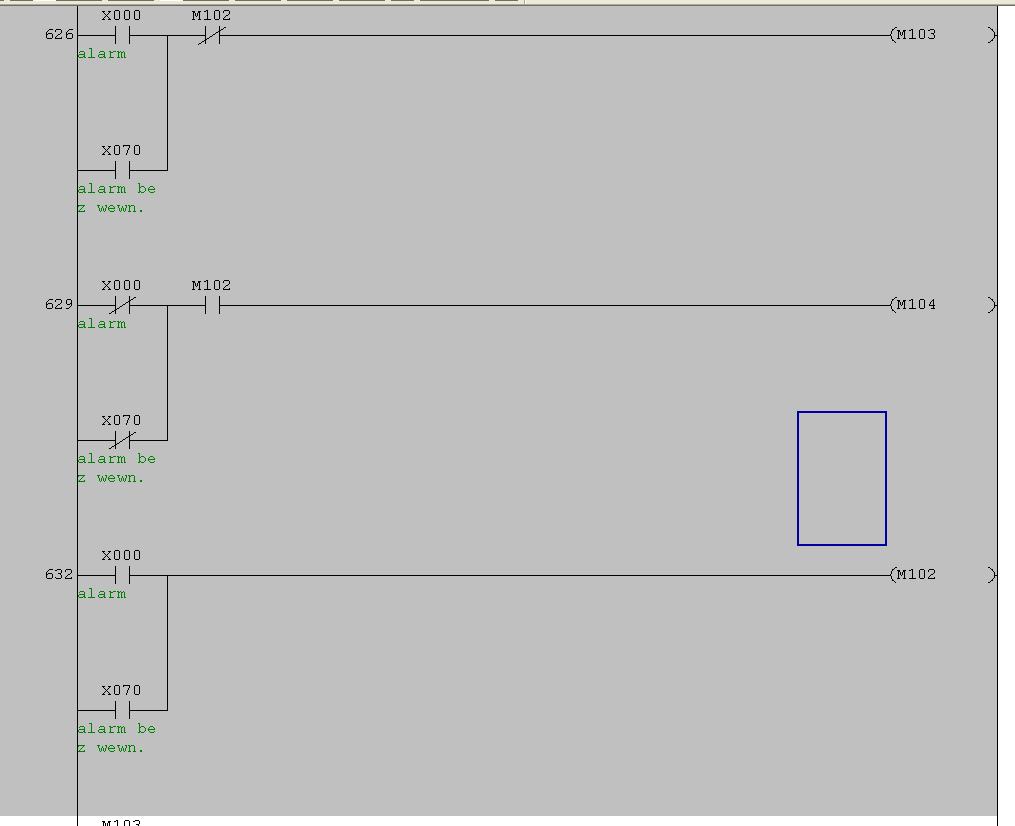

    In August, I only tested on the test bench whether the lights switched on individually and whether the alarm input switched them off; I didn’t check what happened after arming the system. It’s only now that I’ve got round to connecting the system at home :)
    So I think I’ll use two outputs from the alarm control panel; one will work just as it does now (arming the system turns the lights off) and I’ll programme this in the alarm control panel to be active when the whole system is armed, whilst the second I’d programme to be active when the system is armed without internal lines (i.e. at night, when the household members are at home), and then the roller shutters will also lower and raise via this input, whilst the lights remain unchanged. In my overall programme, the alarm input when the system is armed is X0; however, let’s set, for example, X70 as the alarm input when the system is armed at night with the household members present (without internal lines)
    then the lights:
    Lighting and socket control using a Mitsubishi FX PLC – pulse switching
    and can I control the roller shutters with this additional input as follows:
