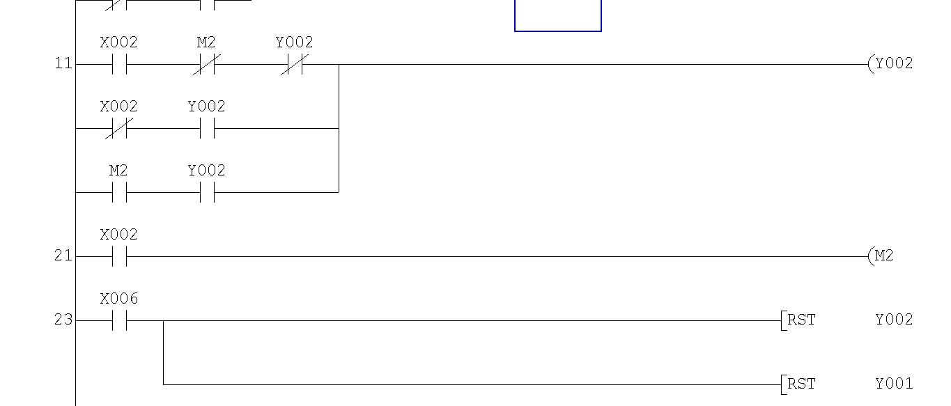

    I have a Mitsubishi PLC from the FX series, and I want to use it to control the lighting in my home, as well as to control sockets and so on.
    The problem I’ve come up against is as follows:
    is it possible to control an output, e.g. Y001, in such a way that a single pulse on input X001 turns the output on, whilst the next pulse turns it off? How do I do this in the ladder diagram?

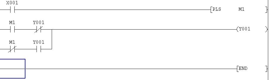

    e.g. like this:
        x1              m1
        m1     y1   |   y1
        m1     y1
    the ^ symbol denotes an upward-pointing arrow
    at the first level, it detects a rising edge (pulse) on x1 and sets m1 to 1 for one controller cycle
    at the second level, it sets y1 to 1 when:
    - m1 = 0 and y1 was 1 (hold)
    - or m1 = 1 and y1 was 0 (turn-on)
    edit: readability of the diagram

    I’m currently trying to follow these instructions, but in MELSOFT GX DEVELOPER the ‘rising edge detection’ option isn’t highlighted – could it be that the FX-128MR doesn’t support this function?
    Edit: My PLC doesn’t support this function :/ Is there any other way to achieve this?

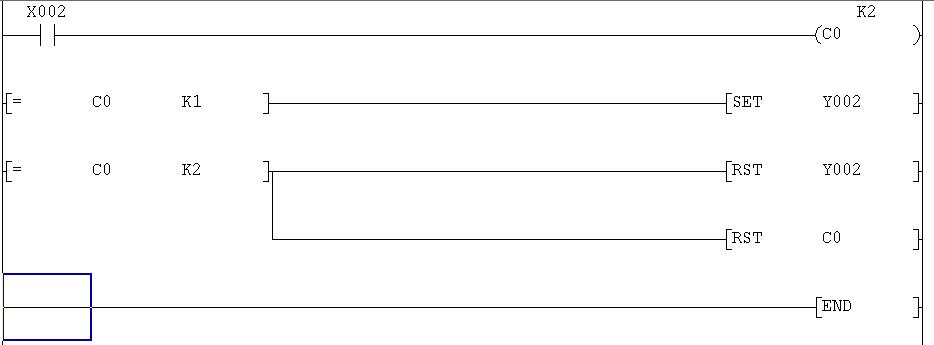

    I don’t have the manual for this controller, so I don’t know if it has a PLS function. It works in the same way as a rising edge.
    Lighting and socket control using a Mitsubishi FX PLC – pulse switching
    And if you don’t have that function, you can use a standard counter and comparators: when the counter is at 1, turn on Y2, and when the counter is at 2, turn off Y2 and reset the counter.
    This is a programme written for the FX1N in GX Developer; I don’t know what you’re using to programme it, but the principle is the same :d
    Best regards.

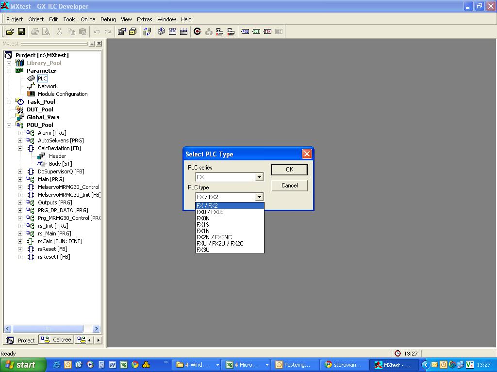

    Which group does this driver belong to?
    I might also try ;)
    Unfortunately, I don’t actually have one of these to test (I only have the Q02)
    What’s more, I don’t have the standard GX developer, only the IEC version.

    Without edge detection
        x1    m1     y1   |   y1
        x1    y1          |
        m1    y1
        x1                    m1
    Operation:
    m1 contains the x1 value from the previous cycle (as specified in the last line)
    y1 should be switched on when
    1. There is a rising edge on x1 and y1 = 0, i.e. x1 = 1, m1 = 0 and y1 = 0 (turn-on)
    2. y1 = 1 and there is no edge, ~(x1 = 1 and m1 = 0) (hold)
    Rewriting
    y1 = 1 and ~(x1 = 1 and m1 = 0) <=>
    y1 = 1 and (~x1 = 1 or ~m1 = 0) <=>
    y1 = 1 and (x1 = 0 or m1 = 1) <=>
    (y1 = 1 and x1 = 0) or (y1 = 1 and m1 = 1) – the second and third levels.

    papajondro wrote:
    The only difference I can see is that in the IEC version you have standard function blocks, and you use mnemonics as normal, which speeds up the work because you don’t have to use the mouse.
    The differences are huge. The whole project, from start to finish, looks different. The IEC version complies with the IEC 1131.3 standard, and you write the project as if at a higher level, only compiling it for the CPU afterwards. In theory (I’ve never checked), a project written in IEC can be recompiled for controllers from other manufacturers. But you also have to (just as in C++, for example) declare all global and local variables and the libraries used yourself.
    I haven’t managed to find out which group this controller belongs to.
  • Adding reset and panic inputs to override lighting outputs
    #10 6942979
    phonex
    I might also try ;)
    Unfortunately, I don’t actually have one of those to test (I only have a Q02)
    What’s more, I don’t have the standard GX Developer, just the IEC version.
    I’m here; I’ll get straight on with the programming. The controller is in the FX/FX2 group
    papajondro wrote:
    I don’t have a manual for this controller, so I don’t know if it has a PLS function? It works in the same way as a rising edge.
    I have the PLS function and it works as it should according to the diagram provided :)

    Now let’s add some options: I want one input to act as a reset, i.e. to switch off the specified outputs (e.g. I arm the alarm, send a signal from its outputs to the PLC, and the controller switches off all the lights in the house), and the second input acts as a PANIC function, meaning that when a signal is sent to it, it switches on all the lights (specified outputs)
    Please check if this is possible (input 6 switches off 1 and 2); I’ve read that one should avoid sending the same output signal multiple times

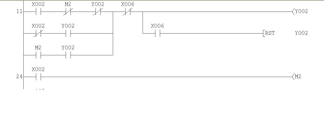

    It works, but this kind of coding is not recommended in view of future modifications. The general rules are as follows (though there are, of course, exceptions)
    - write -()- or -(/)- to the output in a single location
    - set SET and reset RST so that they are visible on a single screen
    - do not combine -()- and SET/RST on a single output [this is the rule most often overlooked ;) ]
    In your case, you can add a negated x6 -|/|- in series after three parallel branches, and the PANIC function (which I assume is more important) is another parallel branch following the added x6. This is a good time to name your variables and separate the functions into distinct levels of the programme.
    What should happen after the alarm is deactivated (do the lights remain off or return to their state before the alarm was activated) and after the panic function is deactivated (do they remain on or return to their previous state)?

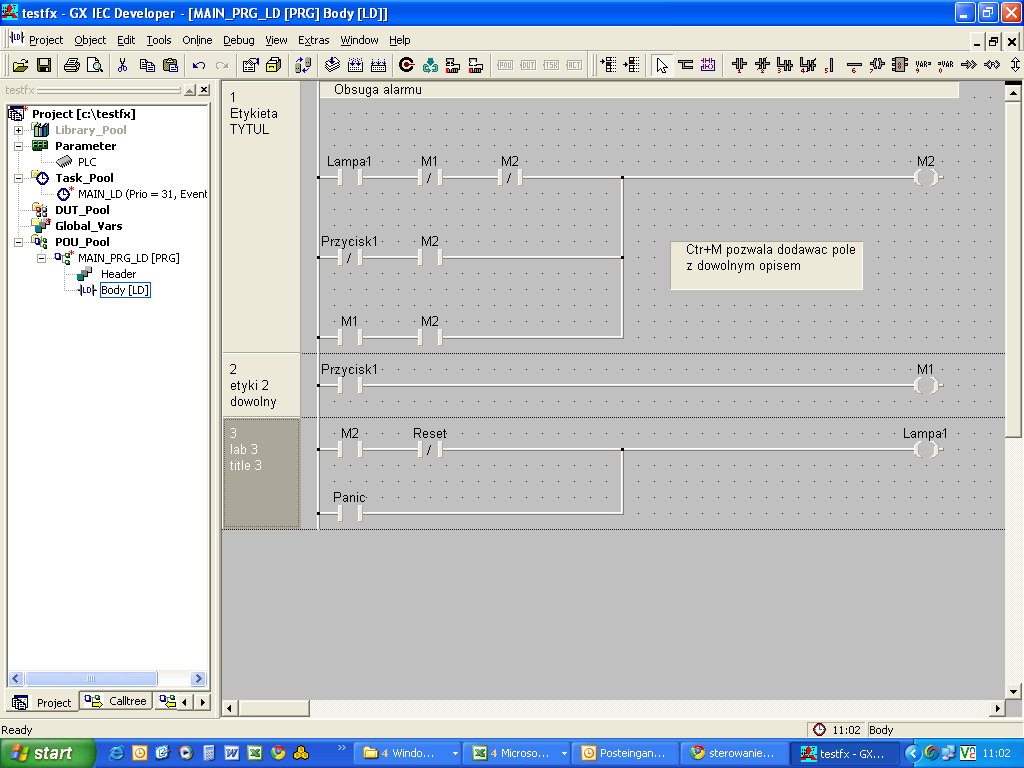

    I’m not sure if it’s the same in the GC Developer, but in the GX IEC Developer you can create global and local variables and names.
    e.g. X1 button 1 y1 lamp 1 x7 panic x6 reset
    and then use these names in the programme.
    In addition, you can give each network a title, and Ctrl+M allows you to add your own comments anywhere in the programme

    Narciarzr wrote:
    I’m not sure if it’s the same in the GC Developer, but in the GX IEC Developer you can create variables and global and local names.
    e.g. X1 button 1 y1 lamp1 x7 panic x6 reset
    Additionally, you can give each network a title, and Ctrl+M allows you to add your own comments anywhere in the programme
    Ctrl+M doesn’t work, but as you say, you can create variables, their names and aliases globally, and these aliases will be displayed next to the ladder diagram

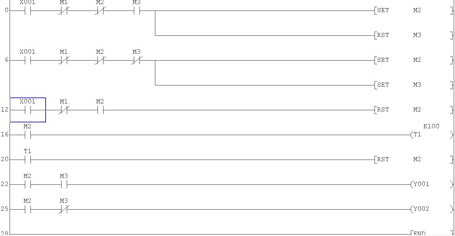

    Great, I’ll do the sockets in the same way too. Now I’d like some help with the following task:
    electric roller blinds, single-button control: press once to lower the blind, 2 – blind stops, 3 – blind goes up, and then the same sequence again; plus one central switch that controls all of them, and one that controls a selected group of blinds

  • Checking FX timer support and input limitations
    #23 6948033
    phonex
    Posts: 364
    Help: 6
    Rate: 30
    jestam wrote:
    Check which timer modules are available.
    Under this link is the documentation for Mitsubishi FX controllers; have a look at subsection 2.16 (page 44) and check whether the sample programme provided there works with your hardware. A detailed description of the timers can be found in Chapter 4.9, from page 89.
    Mitsubishi FX-128MR-ES
    but according to this diagram there are 5 inputs, and I’d like to control two outputs (roller blind down, roller blind up) using a single input
    P.S. I have this documentation in Polish, in case anyone’s interested

  • Questioning negated input states preventing X1 response
    #29 6952270
    phonex
    Posts: 364
    Help: 6
    Rate: 30
    This is what I did:
    and there’s no response on X1
    In the first line, I’ve set all the variables to their negated values (in theory, applying a pulse to X1 should activate the Y2 output, but it isn’t working)
    Tell me, because you’ve set the p input states to negated everywhere – as if they weren’t there at all – is that how it’s supposed to be?
  • Add missing p1 edge-detection instruction between program lines
    #30 6952832
    jestam
    Automation specialist
    Posts: 1799
    Help: 210
    Rate: 145
    If p is to be set to 0, this is the previous state of the input. The programme is to respond to the edge, just like the lighting control programme, i.e. x = 1 and p = 0.
    There is one more instruction missing from the programme
    |---|we1|----------(p1)----| (zmienna p1 ma u Ciebie adres m1)
    Place it between lines 12 and 16 in your programme
    Be careful with the variable addresses. You’ve already used m1, m2, etc. to control the lighting.
