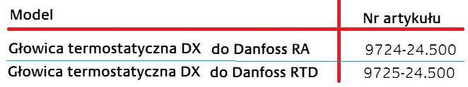

    I found a competitive Heimeier company that has a head for the RTD-N valve and the connection is the new RA (I did not mention these, although I like them on average, it's a waste of money because they work somehow).
    The head that fits on the RTD-N is the DX head
    Replace Danfoss 3120 Thermostatic Head: Compatible Alternatives without Changing Valve
    Finding the code numbers was difficult because I couldn't find the website of the company recommended by the wholesaler, but I did. Heimeier is in a group with other companies and does not have a direct site, only a joint one.
    I paid PLN 31 for it and finally I have peace of mind.
    The page where there is more about this head is:
    link
    It works and the headache is gone, but it wasn't easy.
    best regards :D

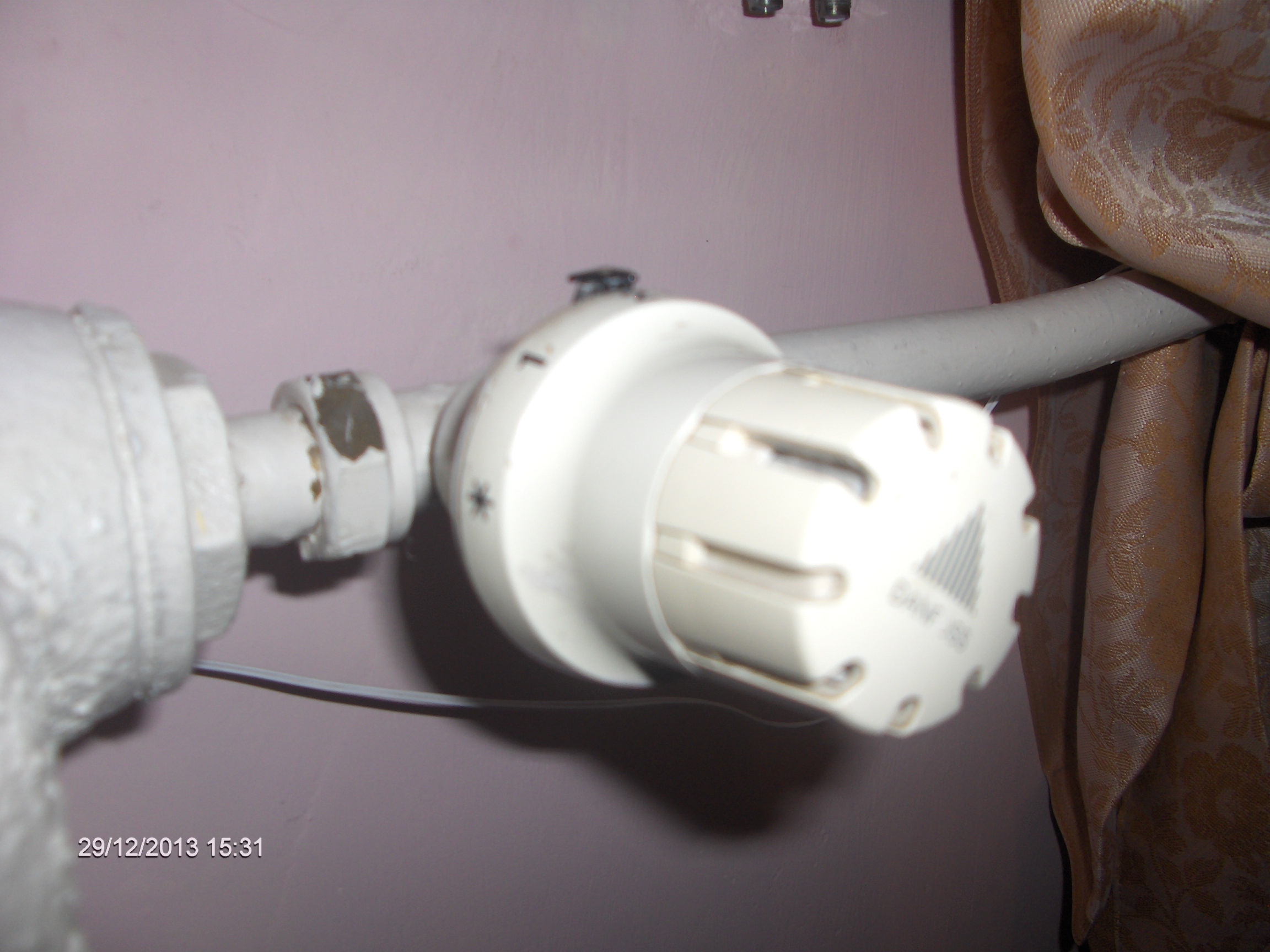

    I have these old Danfoss thermostats.
    Replace Danfoss 3120 Thermostatic Head: Compatible Alternatives without Changing Valve Replace Danfoss 3120 Thermostatic Head: Compatible Alternatives without Changing Valve
    One of them has a broken leg (the one that goes under the nut and holds the thermostat straight) and now I had to tie it to the radiator with a string to make it work properly. I have a question what model it is and possibly what I can replace it with (because I probably won't find one because it's too old), because I have no idea about it. I will be grateful for your help.

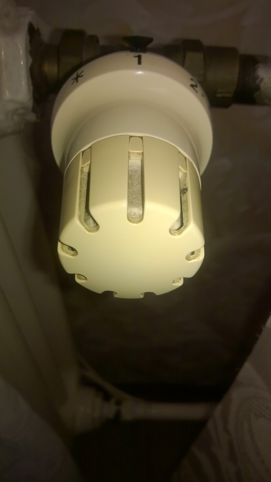

    I have a question about the Danfoss head.
    It was damaged and I would like to replace it, it was installed over 12 years ago
    I don't know what model it is or what to replace it with.
    From the photos from the Internet, it shows that it is a Danfoss 3600/3610
    Please advise.

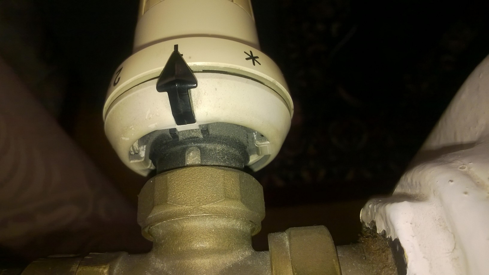

    I have such a head
    https://www.google.pl/search?q=RTD+3100&clien...LsAhVq-SoKHUFMCGEQ_AUoA3oECA4QAw&biw=412&bih= 643#imgrc=ze1or1CFuUpNjM
    My plastic is completely cracked and I have to replace it, and since it is the heating season in the block, I will not replace the entire valve, only the heads. What can I replace it with because I can't find one and other companies don't like it.
    rtd3100.
  • #49 18989351
    Zbigniew Rusek
    Posts: 3613
    Help: 394
    Rate: 1542
    It can be replaced with a head service RTD 2945 (note that it is threaded, i.e. RTD and not RA). It fulfills practically all the functions of the old head, except for the "memo" ring, which it does not have (it is possible to lock the adjustment ranges, although it is done a bit differently than in the old heads). I have one screwed to the valve (I replaced one of the heads, as in the picture, with the RTD 2945. Then I bought it via Allegro. It is worth looking for it on Allegro or in good installation stores, or on the Internet.
  • #50 18995962
    krzychuuu80
    Posts: 27
    It fits and works perfectly
    Thanks
