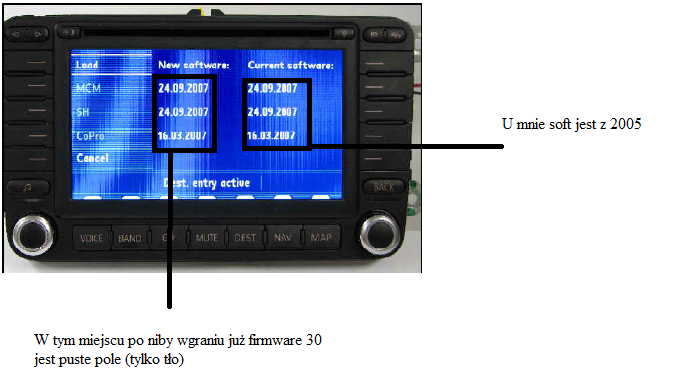

  • #51 8121692
    sosek87
    Posts: 11
    I have such a problem. I have a vw passat b6 (2006) car imported from the USA and I would like to use navigation in Poland, but I only have a CD with maps of North America.
    1) I tried to upload firmware 30
    After a long time (uploading) a screen popped up (info in the attachment)
    2) I ran unlock anyway
    3) I put a DVD DL disc and nothing :(
    I took the necessary things from http://peb.pl/wbudowane-systemy-nawigacyjne/794521-rapidshare-hf-vw-mfd2-dvd-soft.html
    and I did one more operation with the engine off.
    Should I upload the firmware 50 (to the states)? -> will this navigation go then? If not this, where to get the soft Polish map from the states?
