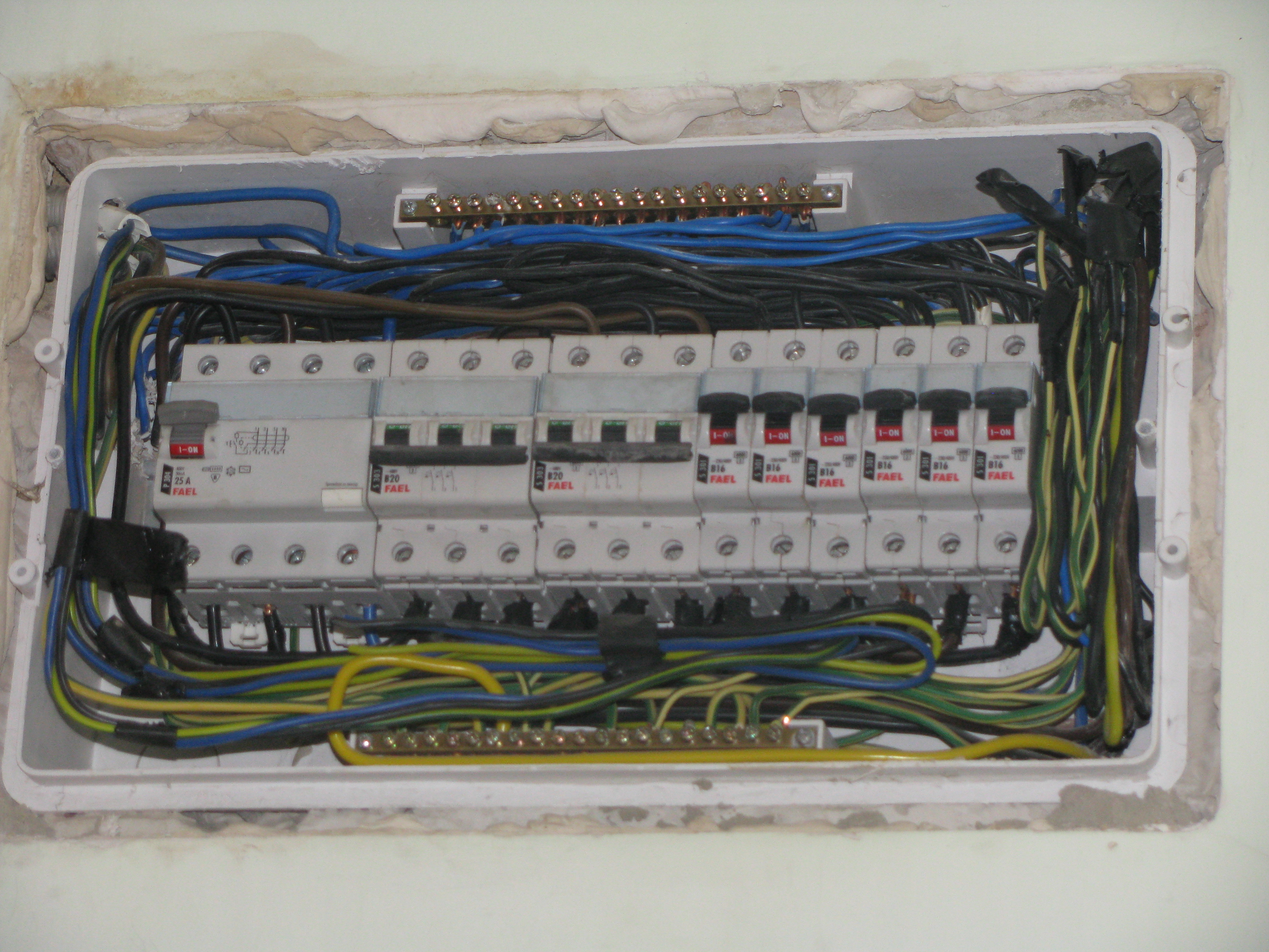

    Kolega retrofood wrote:
    a rule has been in force for a long time that the switchgear can be no more than 2/3 full, and one third of its capacity should be left as a reserve for future expansion.
    E, probably not - my last photo "catch" while checking the installation:
    How many differentials should be used at home for convenience?
  • #33 7917106
    retrofood
    Posts: 31317
    Help: 1140
    Rate: 4788
    And that's not my fault anymore.
    But I see that the fitter had problems since filling the switchgear ...
