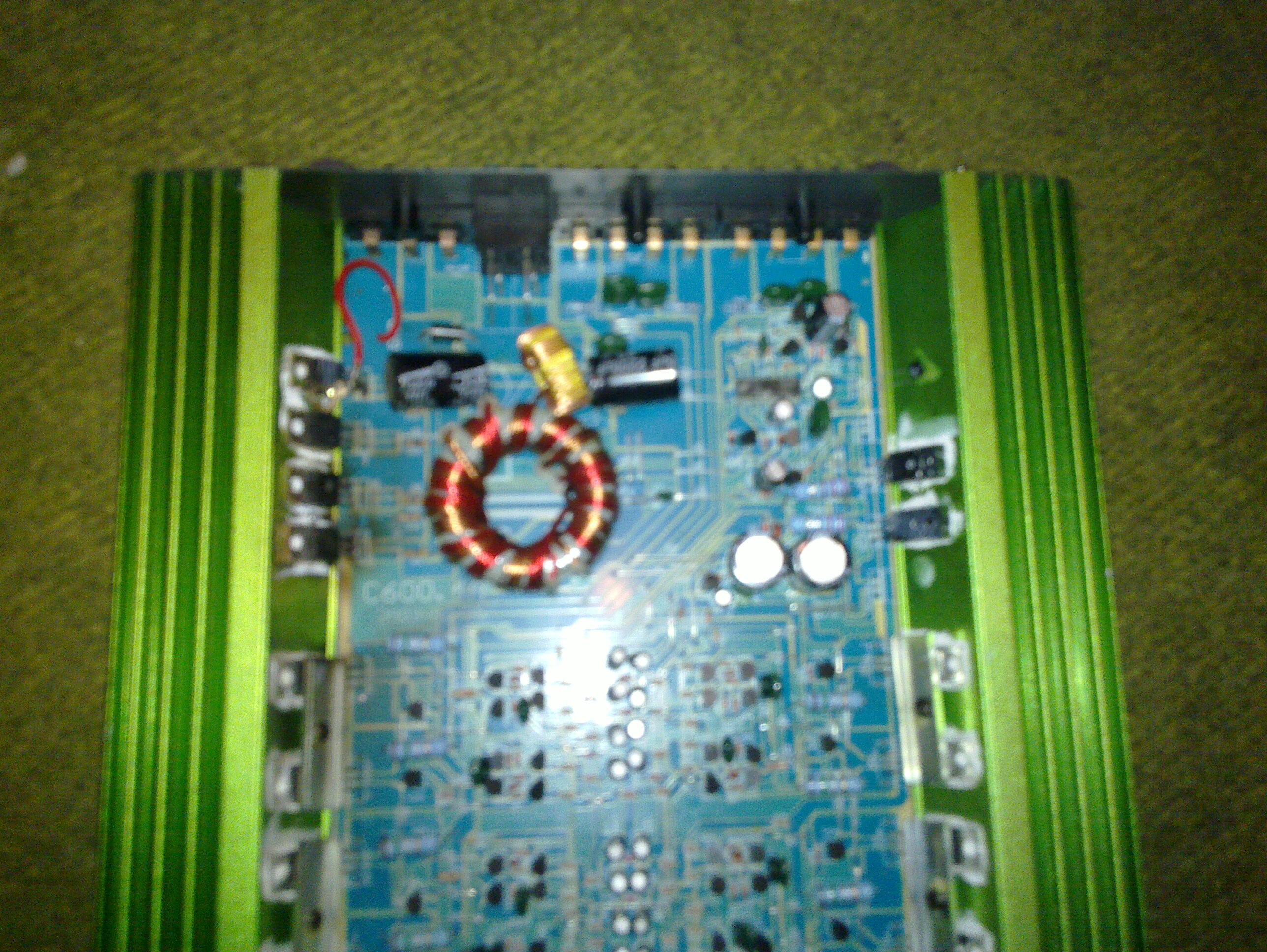

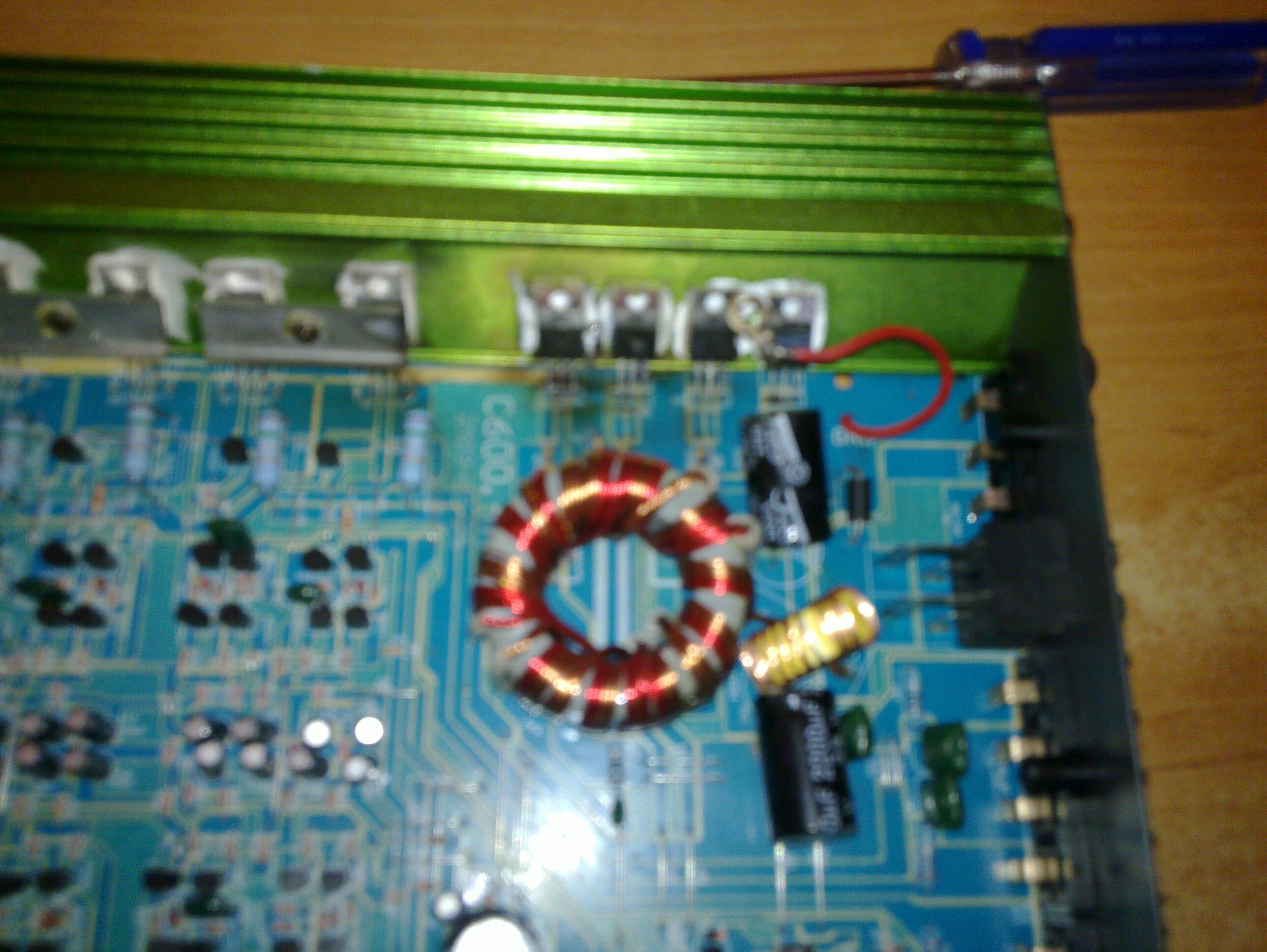

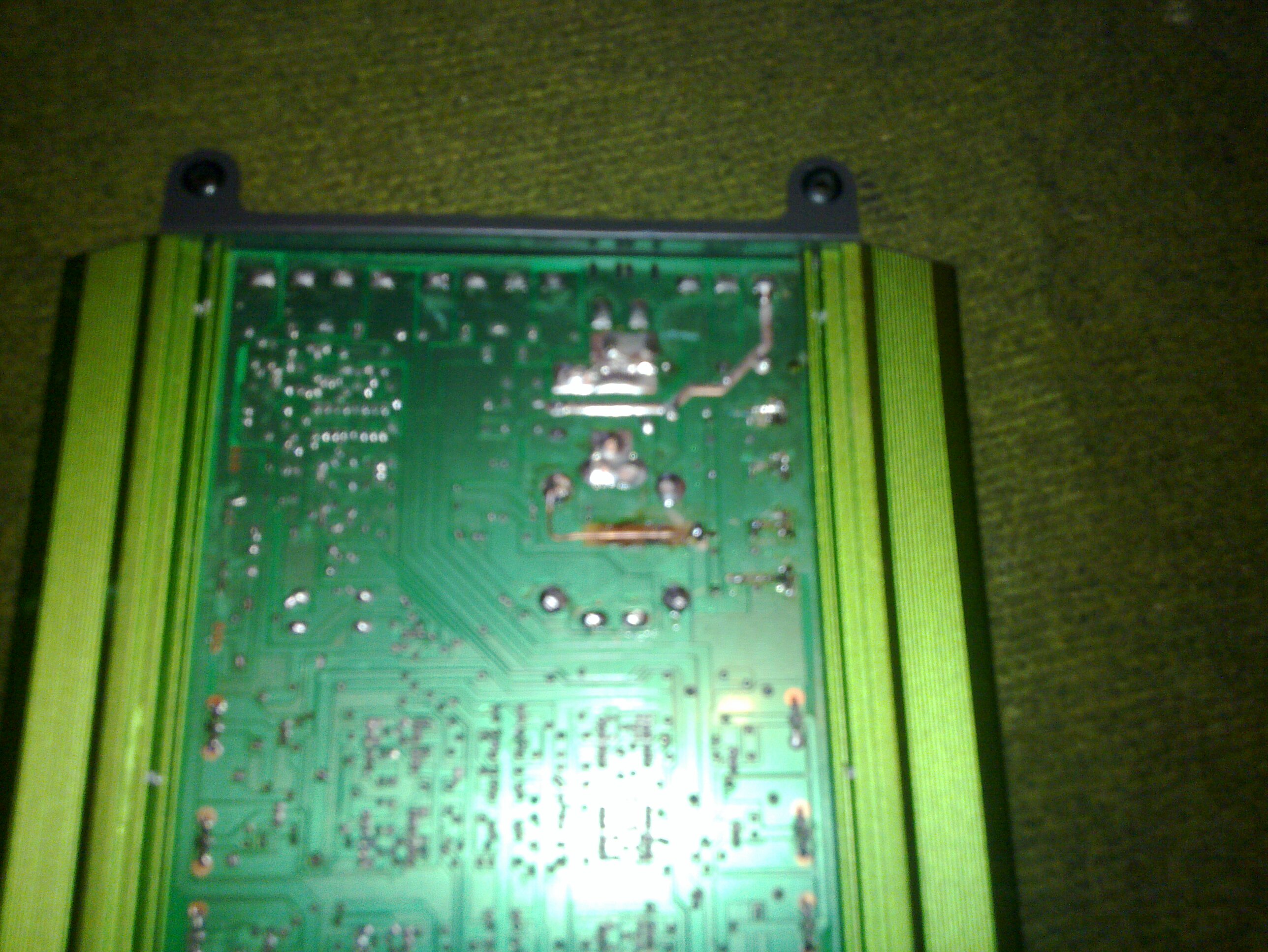

    Hi, I have a problem with the amplifier COUGAR 2000W 4 channel amplifier I bought it abroad beautifully played in a Honda Civic car until I connected the tube and burned the speaker and with it amplifier namely burnt parts IRFZ 44N such symbols were given to the site they made works but when I connect it in a car is a game but only with the engine turned off when the car ignites, the same parts are burning and the track was checking the current in the car and there is a good second amplifier playing and this one is burning what can it be?

    Apparently a slightly higher voltage from the alternator will damage the transistors in the converter. It looks like it has not been repaired on the website until the end. There is still something damaged in it.

    Start by answering my question. It will tell me whether this is the effect of security measures or the inverter's fault. As for the latter, write immediately on what layout it is built. Tl494 or maybe SG3525, or something similar?

    The amplifier plays beautifully after connecting the front speakers and tubes cleanly and reliably for an hour I was listening and nothing was even warm enough to ignite the car and go smoke from it burn parts and path when the burned path will not be soldered this amplifier plays but the power amplifiers quietly do not burn only inverter in the inverter are 4 IRFZ44N transistors and one D5KC20R another I can not read but these are diodes

    How are you guided mass? With a car body or a separate battery wire?
    I see (although poorly on bad photos - use macro because they are very blurry), that the transducer made as in Magnat or transistors without good protections (it will not choke just blow up transistors).
