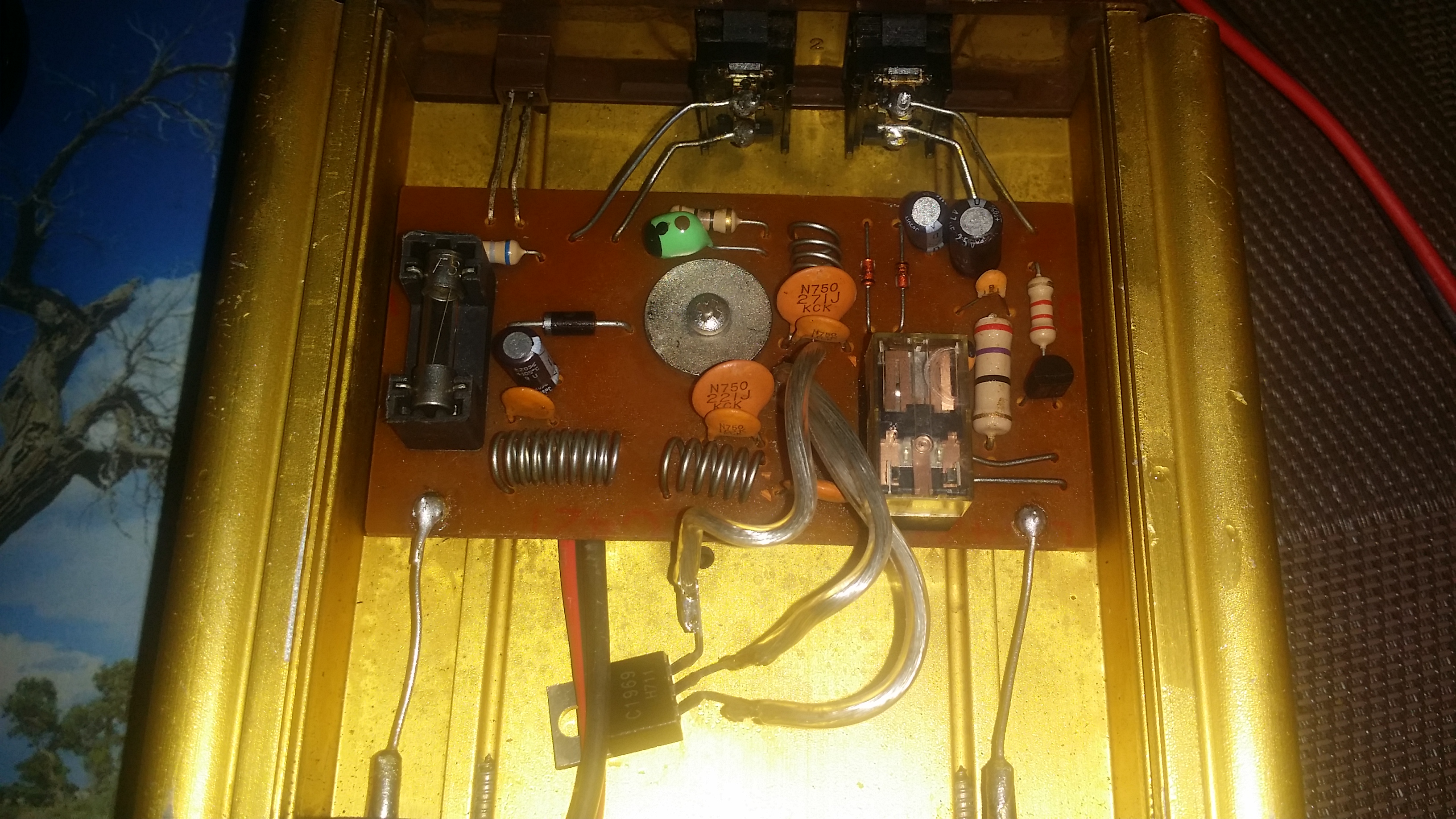

  • #14 14258013
    kisiol
    Level 20  
    Posts: 1650
    Help: 36
    Rate: 468
    The other parts are used a little differently. I took a picture of the middle.
    • Zetagi B47 Amplifier Issue: Signal Weakening Despite Power Amplifier Replacement & Relay Activation 20141226_202344.jpg (1.91 MB) You must be logged in to download this attachment.

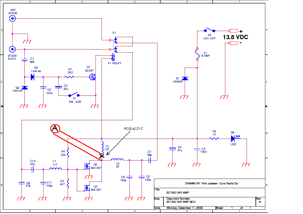

  • #15 14258459
    kriss51
    Posts: 5630
    Help: 672
    Rate: 482
    This transistor, however, looks like the so-called Coloring. The amplifier will not work on it. I suggest inserting IRF520 and measure the quiescent current in the drain circuit. It will be above 100mA so you have to adjust the pre-gate control circuit a bit. Please see how it looks in such an amplifier on two IRFs. It's about two resistors R3, R4. They ensure proper control of the goal. As R3, you can insert a perek to set the quiescent current.
    http://elektrotanya.com/PREVIEWS/63463243/23432455/egyeb/zetagi_b47_sch.pdf_1.png

  • #18 14274118
    kisiol
    Level 20  
    Posts: 1650
    Help: 36
    Rate: 468
    Hello, I bought the transistor original and not painted and the amplifier works. Thanks for help. Maybe someone will tell you how to entrust this quiescent current and exactly at which points to take measurements.
  • #19 14276836
    kriss51
    Posts: 5630
    Help: 672
    Rate: 482
    It's a slightly different model of the amplifier, but the principle of measuring the quiescent current is the same. You have to disconnect in your case the collector supply of the final transistor and connect the Ammeter exactly as in the picture. You can even directly disconnect the collector from the rest of the system and connect the meter there. Only do the measurement without turning on the radio, and preferably do not connect it to the radio. The amplifier must be without control.
  • #20 14276885
    SP5IT
    Posts: 11602
    Help: 1298
    Rate: 1687
    A bit not so kriss.
    Bias here is determined by the divisor r3 / r4
    Poor solution, better to do on zenerce or LM317.
    In addition, the colleague has 1969 and the taste probably works in class C.

  • #21 14277016
    kriss51
    Posts: 5630
    Help: 672
    Rate: 482
    I guess it works linearly because its model is probably from SSB. If not then class C.
    The second thing is:
    So I showed. Another thing is the fact that Bias in the presented diagram is implemented on the divider, and not more professionally on LM or zenerka. Let the author write if his amplifier has an SSB switch then everything will become clear. Best wishes and happy new year wish you.
