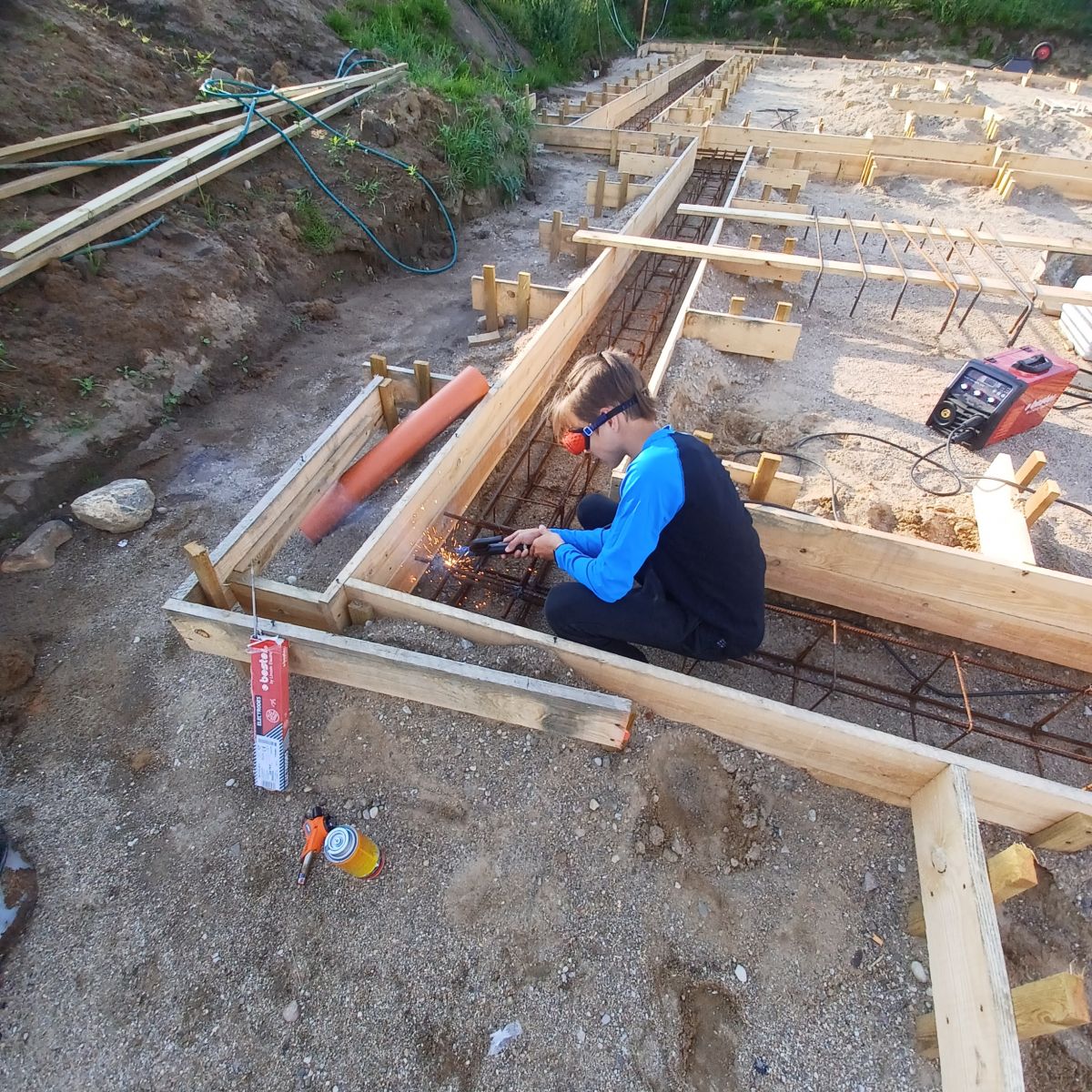

    #35 20671903
    Parowy
    Level 22  
    Posts: 955
    Help: 55
    Rate: 227
    @Wojteksw49 Sorry I'm just replying, I must have overlooked your post 🙄
    I looked here on the occasion of wanting to show off my talented son, a 12-year-old decided to learn how to weld with an electrode, bought a handle (in my Bester it was only for blinking) and glasses, he runs like an old welder :D
    A boy wearing safety glasses welds rebar at a building site foundation.
    And even more by the way, my Bester MMA method works great :)
    PS Did you buy a welder?

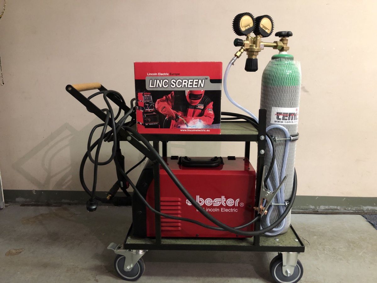

  • #36 20727772
    Wojteksw49
    Posts: 196
    Rate: 37
    Congratulations to your son.
    I also haven't looked at this topic for a long time, I bought a Bester 190c Multi and I am satisfied.
    Bester 190c Multi welder on a cart with a gas cylinder and accessories.
    I made a suitable cart for it myself and now it is mobile.
  • #37 20728533
    Parowy
    Level 22  
    Posts: 955
    Help: 55
    Rate: 227
    Wojteksw49 wrote:
    I made a suitable cart for this myself and now it is mobile.
    I too, only mine is primitive, plywood, wheels and handle from an old pastry cart :D
    I have the same set :) .
