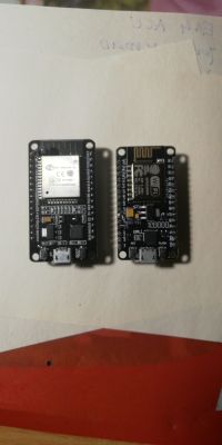

    I am trying to program two ESP 32 modules and during the upload when it finishes the write process I get this error :
    Failed to connect to ESP32: Timed out waiting for packet header”
    On YouTube and websites I found a description of how this problem can be solved. I soldered a 10 uF capacitor between pin E and GND but nothing helped. The Arduino I am using i.e. the software is version 1.8 and Win 7. The drivers are correctly uploaded.
    The modules I am trying to program are these :

    This is what it looks like:
    Failed to connect to ESP32: Timed out waiting for packet header” .
    Now I upload to the module , which is on the left in the photo
    The program is Wifi scan
    Interestingly , it used to be to the module , the one on the right , I uploaded the program to Blynk to switch the relays and it worked. Now I try to upload it again and get an error

    Now this is how it looks like , The module on the left side , I marked it with number 1
    In the manager I had a mouse driver error , it was displayed twice , one OK and the other with an error and I deleted it
    Now it looks like this
    Module 1 is working , this is how the reading from the port looks like

    This is what it looks like now that modulus number 2 is connected
    It detects it as a mouse
    This is how it is after uploading to module number 2. I have not changed the module type in the tools , it is still saved as ESP32 Dev Module
    After connecting this module , there is a blue Led on the top right . The second led , also blue , next to the usb connector lights up but very weakly . After compilation during uploading both LEDs turn off.

    Both have the same CP2102 chip, now when I buy I will choose another, the CH340
    After connecting , in the manager after updating it shows that the driver is installed. Now I will do the same in Arduino, looking for a library

    And here after uploading the example skech as it is in the Arduino program and it works. So in the earlier one something is not set right
    I am now going to upload my program to Blynk to control the relays. This program has worked correctly before
    Added after 4 [hours]:
    After struggling with the program for a few hours, I finally managed to connect to both one and the other module.
    Thank you for your help
