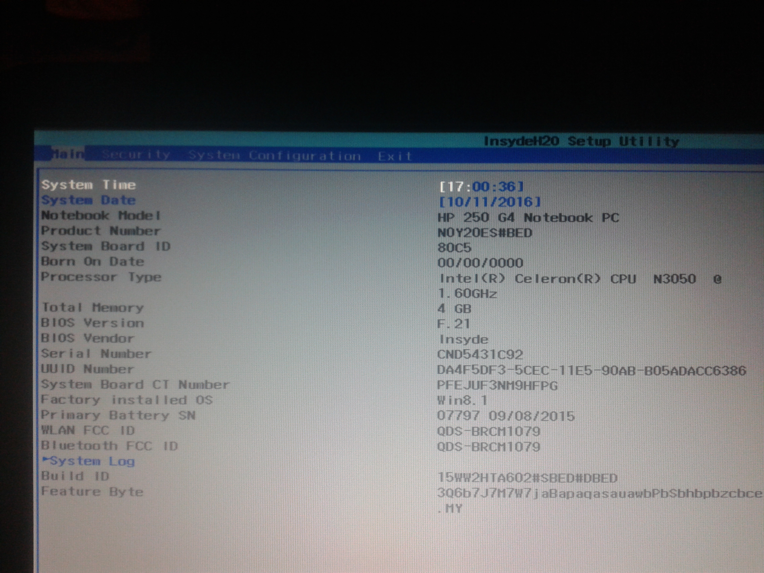

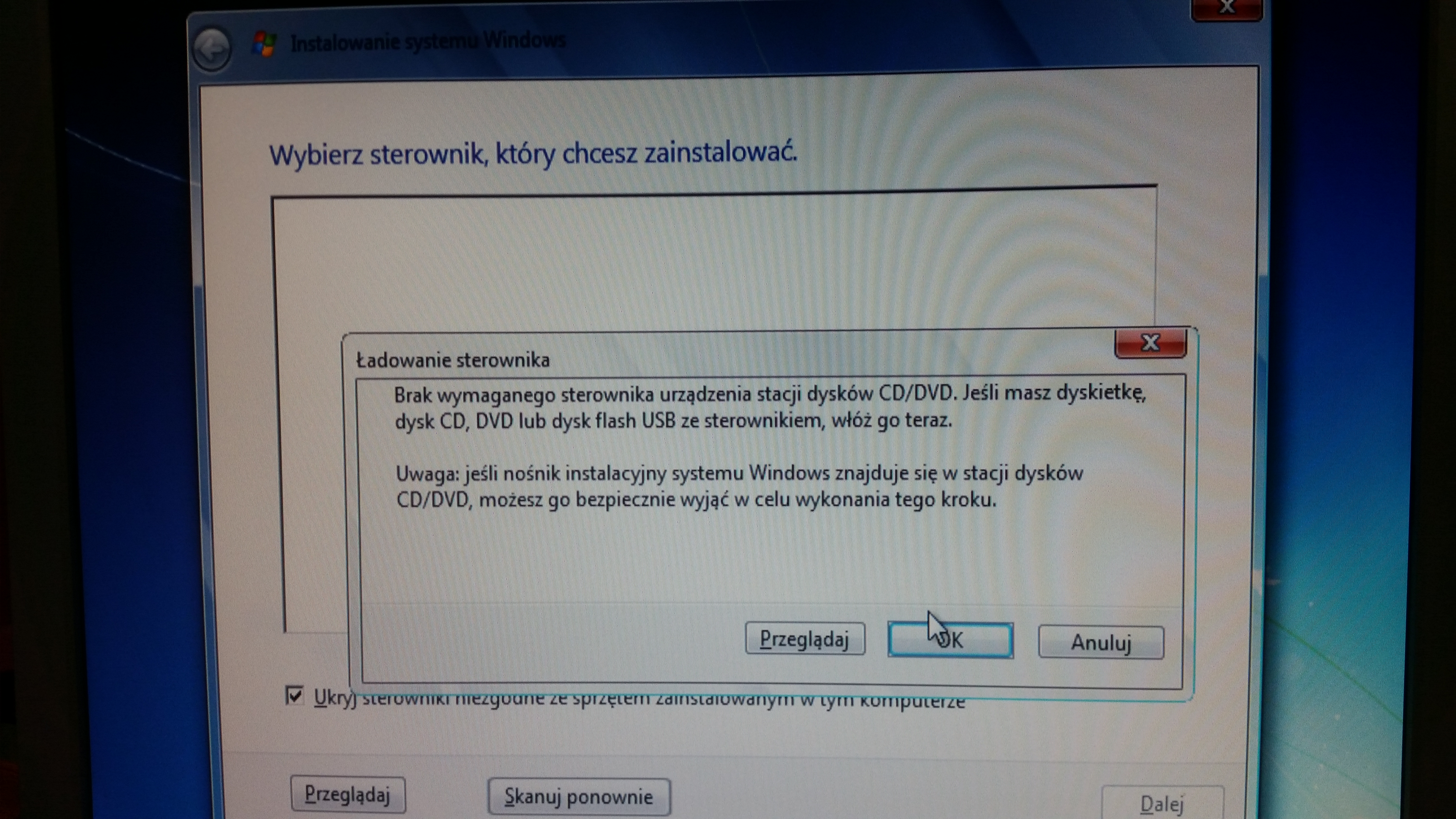

  • #36 15988310
    #maciejo#
    Posts: 11

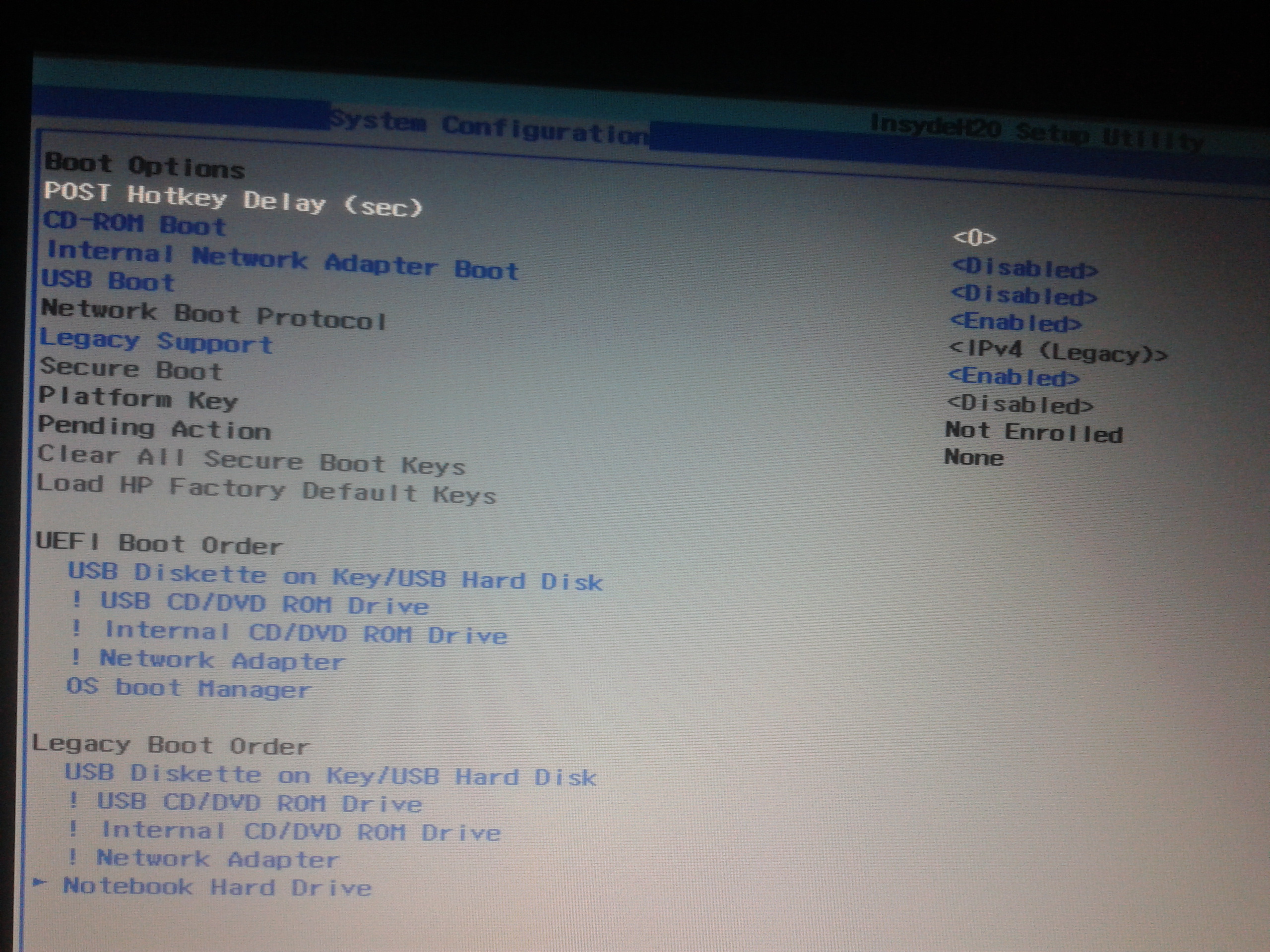

    I have a similar problem and I don't know how to go about it.
    - Intel Celeron DualCore processor, 2.1GHz
    - BIOS InsydeH20 Rev. 5.0
    - Broadwell 2015 architecture
    - two cores, two threads
    - 4GB DDR3 RAM memory
    - 500GB SATA hard drive (HGST HTS545050A7E680)
    - Intel HD Graphics
    - WiFi wireless internet
    - Bluetooth 4.0 module
    - 2 USB 2.0 ports, 1 USB 3.0 port
    There is no way to change the IDE / AHIC operating mode in the BIOS, I switched the WIN7 booting in various ways. The image is good because the installer starts up elegantly on another computer. I would like to add that the computer is new - I bought it without a system, without a CD / DVD drive.
    One thing is interesting to me - in the first tab of the BIOS there is something like "Factory installed OS" set to "Win8.1" - doesn't it mean that I can only install WIN8.1 ???
    Below I am throwing photos of the BIOS and the error message.
    Basically, I haven't tried an external CD / DVD drive along with making the image onto the disc.
    What do you think about it ? Missing CD/DVD Drive Device Driver: Factors, Solutions- ISO Image, Recording Speed, BIOS Update Missing CD/DVD Drive Device Driver: Factors, Solutions- ISO Image, Recording Speed, BIOS Update Missing CD/DVD Drive Device Driver: Factors, Solutions- ISO Image, Recording Speed, BIOS Update Missing CD/DVD Drive Device Driver: Factors, Solutions- ISO Image, Recording Speed, BIOS Update

    I would leave one drive in the laptop for the duration of the installation. Select Legacy mode. What exact version of Windows are you trying to install? Windows 7 x64 SP1? Original disc or recorded image?
    Today I was "struggling" with a similar situation - I had two freshly recorded discs, one at 12x speed, the other at 4x speed - both with the same system image. Perhaps it is the fault of the damage. motherboard, but on the first each time the error as in the title, despite changing various settings in the BIOS and external hookup. DVD drive. I recorded the same with 4x speed and it went right away (both from the built-in and external DVD because I checked it specially)
    If you do not come up with anything, try to follow this trail and post pictures of this BIOS, we will look.

    Stock up on a plate and an outside. DVD drive - in BIOSI-e Legacy Support Enabled and it should go. Do not suggest "Factory OS installed", it is not related to the version of Windows that may be installed. However, before trying to install an older system (Win7), it is worth making sure that the appropriate drivers for download are available.

    This is the Windows 7 64 bit SP1 version - the system was downloaded from the student account - but I will mention here again that the installer started correctly on another computer. As for the drivers, I downloaded them from the HP website before I was going to install the system, so there should be no problem with that.
    I will do as you suggest [kitty34] with external drive and Legacy setting, I will write what the result will be. I do not know how long it will take because I do not have this drive. Thanks for the express reply.
  • #39 15991232
    #maciejo#
    Posts: 11
    I made a Windows 10 CD image (student version), booted from pendrive (usb 2.0 port) and installed WIN 10 as if nothing.
    As for WIN 7 SP1, I even tried to enter the option Computer repair -> command list -> running DISKPART. Appropriate commands changed the disk from MBR to GPT - it did not affect the launch of the WIN 7 installer but it could help in starting WIN 10. I can not say that anymore.
  • #40 16114237
    hanibal0
    Posts: 77
    Old but current topic, the solution is to modify the win7 install using the program from ASRock's website ;) (by the way, the msi modifier doesn't work, it's a waste of time because ASRock's patcher works at 100%)
  • #41 16502040
