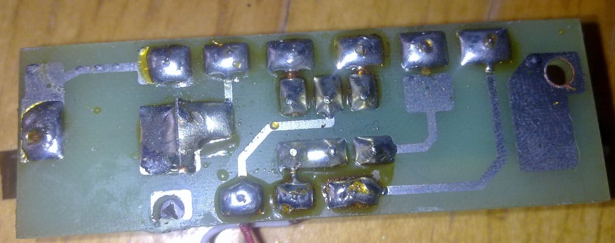

    You must decipher the old one, i.e. determine what is what in it, and then no voltage measurements will be needed. We measure voltage only when we don't have an old unfon, but only the cables themselves.
    If you can't do it, post a picture of the board from the other side. Then I'll help you.
    So far it can be seen that the two lower pins are the button for opening the lock.

    Now everything is clear. The installation is 5-wire.
    From the bottom of the board or otherwise from the left in the previous photo:
    lock
    lock
    call
    earphone
    microphone
    mass
    There is a bridge between the ground and one end of the lock.
    From the handset (in the old one) there are three wires, one of which broke off. It's white from the microphone.
    In the new one, you need to remove the right jumper (jumper) and connect the wires to 1,2,3,4 and 6.
    You have 2 white wires that you should mark beforehand.
    On 1 you give the call, i.e. beige.
    On 2 you give mass, i.e. green.
    On 3 you give the handset, i.e. white (the right one, see the description of the old one).
    On 4 you give a microphone, i.e. white (the right one, see the description of the old one).
    On 6 you give blue.

    From 1 to 4 played, the bolt, however, did not work with blue on 6 and with the right jumper removed, only on 5 with the right closed and the left open. In the meantime I achieved the same on the secondary button, which is green on 7 (bridged) and blue on 8.
    I was generally confused by this mass on green, especially since I had a voltage of 7V connecting white to green and white to blue, I did not come up with the idea of measuring blue with green, which would enlighten me, especially since white with green also opened the bolt.
    So, on behalf of my mum, I would like to thank zybex for all the help.
