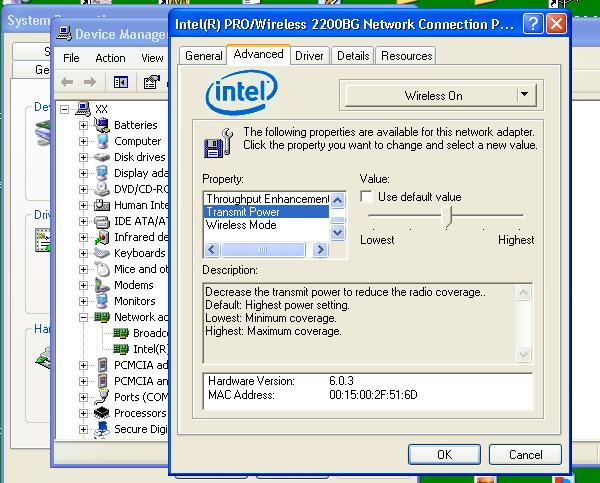

    I have a laptop with W7 and poor signal strength in the neighborhood WiFi network.
    How can I improve the signal without buying any goodies?

    In the device manager, in the properties of your card, you should be able to manage the power.

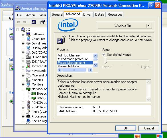

    Maybe not every card does, but it is possible!
    • Improving WiFi Signal Strength on Windows 7 Laptop Without Purchasing Equipment da się 2.JPG (72.23 KB) You must be logged in to download this attachment.
    • Improving WiFi Signal Strength on Windows 7 Laptop Without Purchasing Equipment da się.JPG (74.82 KB) You must be logged in to download this attachment.

    It does not matter, the device manager is the same whether it is XP or Win 7.

    Advanced tab :D
    Since the author of the thread has a weak signal from the hotspot, I would not expect miracles after increasing the transmission power of the card in the laptop. If anything, I expect an additional reduction in receiver sensitivity ;-)
    Read (you) carefully what @ Mleczyk89 wrote. This is basically the only method. At the beginning, I suggest buying a WiFi-USB card * (necessarily with an external antenna, preferably a detachable one) and possibly a USB extension cable. Install Inssider, measure the signal (you can also use the card itself in the laptop, now).
    Alternatively, the Airlive G.DUO-style wifi "amplifier" (or its substitute made of two APs) placed on the windowsill should probably do the job quite wirelessly - but the cost is higher. However, no one will give a 100% guarantee that these solutions will work immediately without additional investments (e.g. purchase / installation of better antennas) - you just have to try. Therefore, it is good to get along with the seller about the possible return of the equipment.
    Anyway, IMO without buying "different things" is impossible - because as it is commonly known such things only in the Era, or rather now in T-Mobile ;-)
    Greetings -
    Stanley
    * for example, I use Pentagram P6132-10 (5dBi omnidirectional antenna included) with 3m USB extension cable (for this "set" I paid about PLN 70: about PLN 50 card, about PLN 20 cable). The Tplink TL-WN422G card on Atheros (WN722N) was often recommended on the forum.
  • #12 9855258
    1st
    Posts: 719
    Help: 59
    Rate: 169
    paweo12 wrote:
    so where should I look? Improving WiFi Signal Strength on Windows 7 Laptop Without Purchasing Equipment
    But that's not really your WiFi card!
    What's the difference? ;-) After all, increasing the transmission power will not increase the signal level received .
