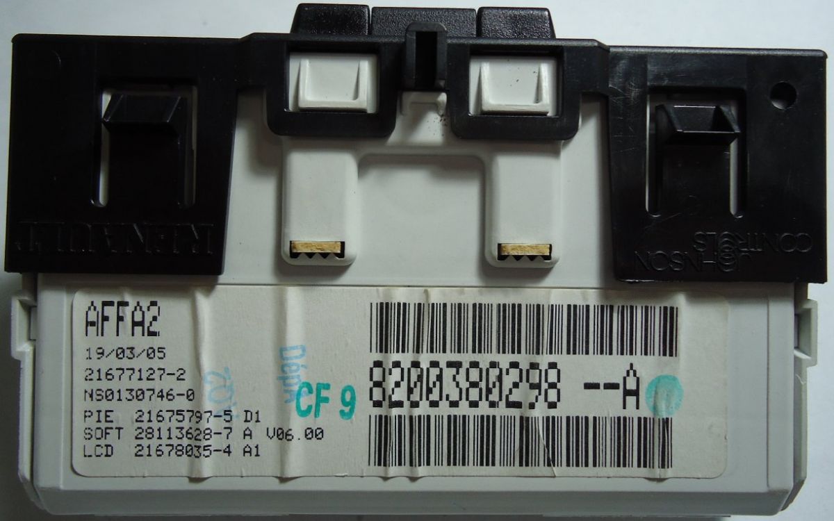

    I have car radio display Sagem AFFA2 and want to connect it with RENRDW380 (for repairing purposes). Here is picture of display and connection diagram.
    I downloaded connection diagram and this pinout is not working or it`s bad.
    MASA (GND) is not on pin 20, GND is on pin 18! Now I can turn on display but do not have communication with car radio.
    Also, C1 connector pinout:
    1 DTA
    2 CLK
    3 MIRQ
    4 n/c
    5 Radio ON
    6 GND
    On connection diagram for AFFA2 display pins 2 (CLK) and 3 (MIRQ) are connected together?!
    Do You have 100% correct and checked pinout for Sagem AFFA2 display?
    Thank You!

    So, communication is via 2 pins (different from TUNER LIST displays where communication is via 3 pins). Now is much clearer!

    All is working now, I have communication.
    Error in connection diagram is that GND (MASA) is on pin 18 (not on pin 20!).
