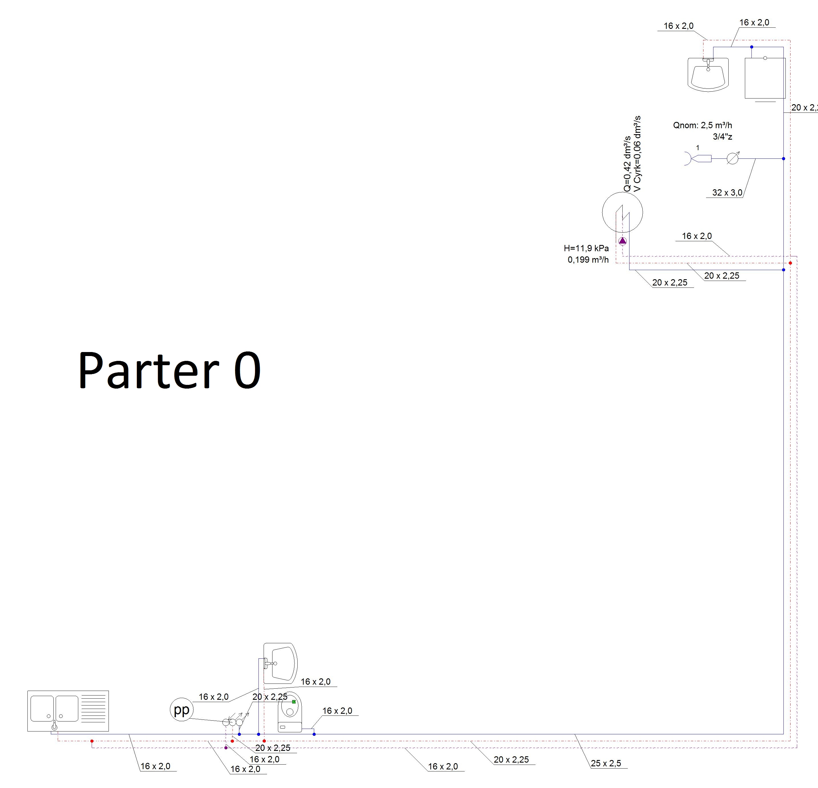

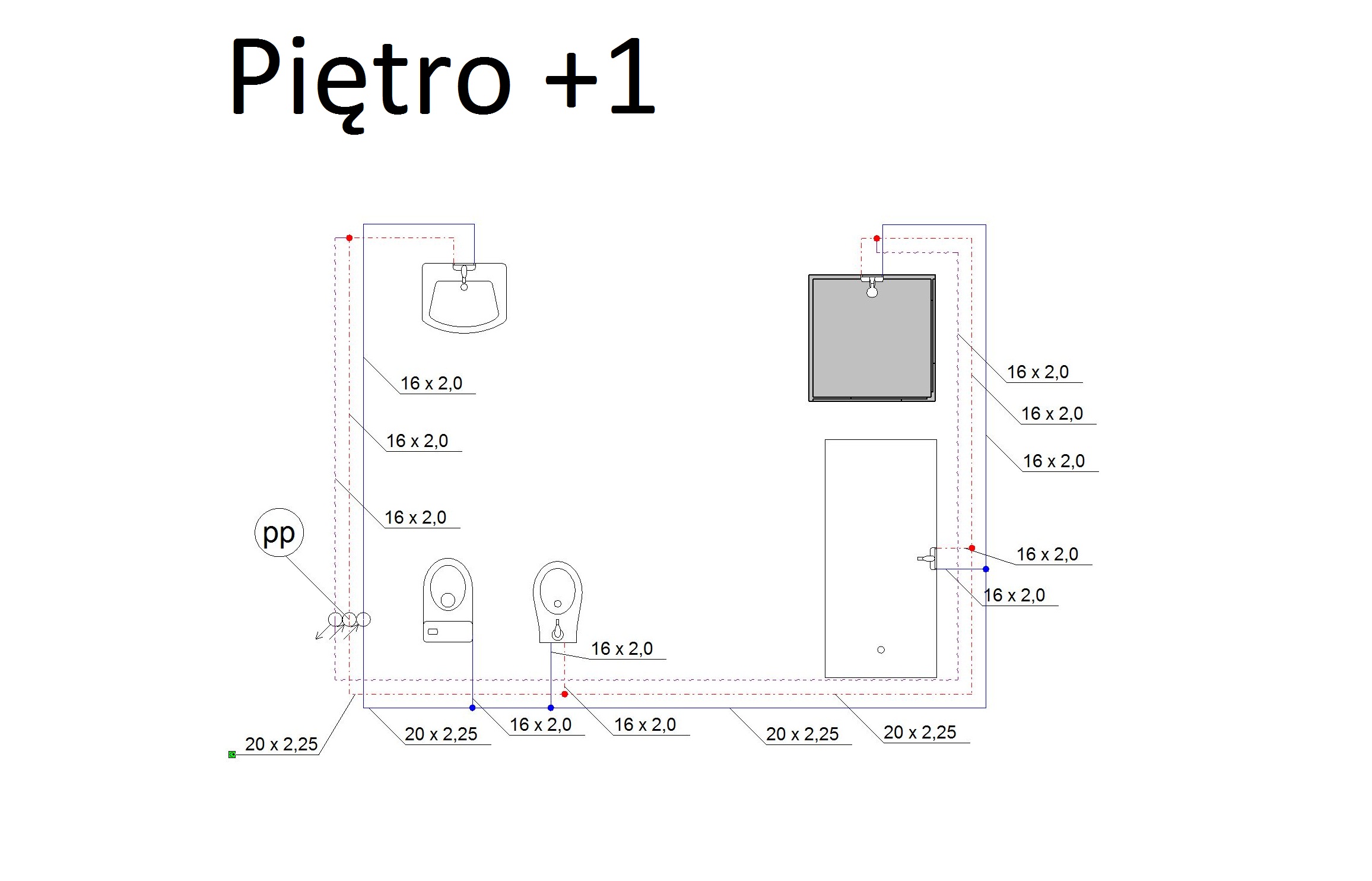

    Good day. I need help choosing the diameter of the pp pipes in the water system. I am asking for advice.
    1. From the main connection to the boiler
    2. Cold supply to the riser
    3. Power supply of hot to the riser
    4. Circulation
    5. Cold riser (bathtub, shower, washbasin, toilet on the first floor)
    6. Heat riser (bathtub, shower, washbasin, toilet on the first floor)
    7. Power supply of the basin battery
    8. Powering the sink faucet
    9. Toilet power
    10. Washing machine power supply.
    11. Floor shower supply
    12th floor bathtub power supply
    To illustrate the installation, I paste photos.
    Choosing PP Pipe Diameter for Water System: Boiler, Riser, Faucets, Toilet, Washing Machine & More Choosing PP Pipe Diameter for Water System: Boiler, Riser, Faucets, Toilet, Washing Machine & More

    The installation is not large. If you are making a tee system, send cold water to the DN25 riser, divisions DN20. You can approach the devices and the last point to DN16,
    Hot water riser DN20 approaches DN16 and it will be fine :)
    circulation as low as possible

    I would give a diameter of 25 from the water meter to the boiler and to the water tee for the garden. The rest of the 20
    Whole warm water 20.
    if you do not have experience in welding, make the circulations also in the 20th smaller diameter, it is very easy to clog during welding.

    Colleagues, you describe it very nicely.
    Niceshoko. nice design only i not exactly marked on the ground floor there is a shower in the vestibule. Won't the diameters change when you include it?

    No, it won't.
    PS. I wanted to point out that what I drew corresponds to certain conditions in the installation (slightly higher flow velocities and greater pressure drops, therefore smaller diameters). So it's a bit schematically done.

    Did you choose the diameters according to the established norms and nomogram? In my opinion, the diameters are too small, they will be too high speeds.
    Connections to houses are usually 32 in diameter, a 3/4 or inch water meter is mounted if you have a large garden for watering. the rest as I wrote above.

    1. Your suggestions are similar to mine :)
    2. In this case, the speeds are slightly higher than the old PN 01706 (according to the manufacturer's recommendations).
    3. The diameters of PP pipes depend on the working pressure. PN10 have smaller diameters than PN16 or even PN20.
    4. The nomogram is largely obsolete, it is better to use the Colebrook-Whit formula

    The diameter of the tubes and their wall thickness are bothering me. Which pipes should be for cold and which ones for warm, and then you can specify the INTERNAL and not the outer diameters.

    I personally would use PN20

    I was thinking of Mon10 for cold and Mon16 for warm or all of Mon16
