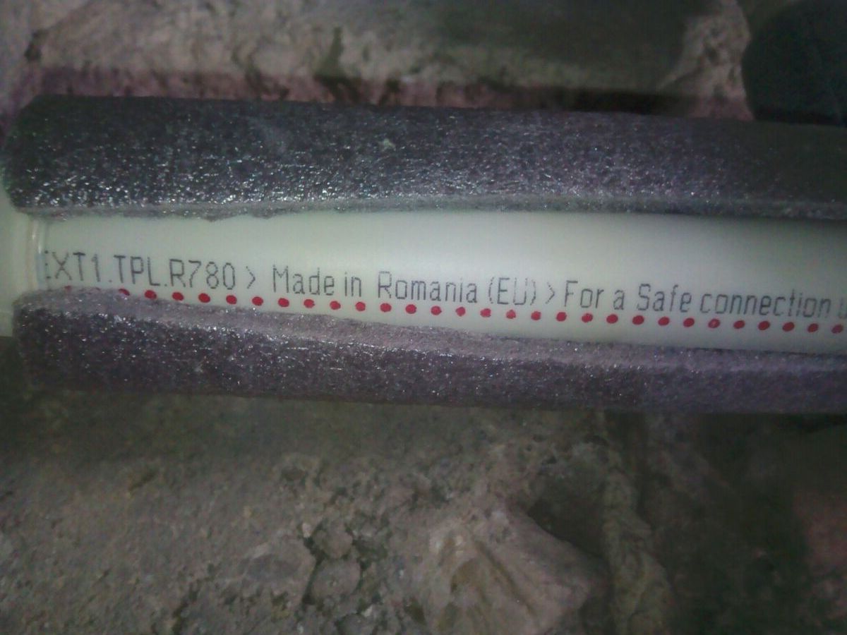

    ziomekorko wrote:
    andrzej lukaszewicz - what are you nonsense you write !!! Each PPR pipe stabilized aluminum must first be machined with a tool called a scraper. First, you strip the aluminum layer with the outer material to the length of the weld, then the welding process takes place and the last to cool down. All pipe diameters are made of aluminum, regardless of the manufacturer, i.e. from 16 to 110 mm, they must first be machined with the appropriate diameter with a stripper.
    Recently, I made water at home - I dumped steel pipes and made PP. I used Romanian stabi pipes for hot water. Connecting a bathroom radiator, what PP pipes should you choose? Connecting a bathroom radiator, what PP pipes should you choose? Connecting a bathroom radiator, what PP pipes should you choose? Aluminum inside, no stripping required. I did "20" and "25"
    Added after 7 [minutes]:
    ziomekorko wrote:
    Once again, aluminum stabi pipes must be scraped off
    And once more: do not have to be ripped off if the aluminum is inside (between layers) Connecting a bathroom radiator, what PP pipes should you choose?

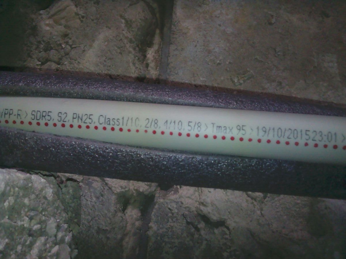

    sebaele22 wrote:
    But as far as I know, PN25 is not there
    And what is that? Connecting a bathroom radiator, what PP pipes should you choose?
    Bought in a store in Poland.
    Show white and say black.
    Added after 5 [minutes]:
    sebaele22 wrote:
    WELDING pipe 20mm STABI aluminum PN25 "does not require a scraper
    sebaele22 wrote:
    But PN25 I think there is no such thing anymore?

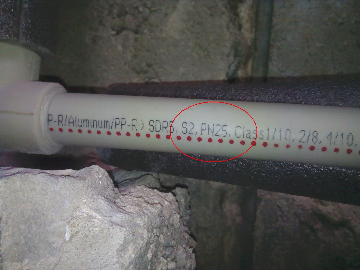

    And there is no PN 25 http://www.pipelife.com/media/pl/p DOWN/k_PP-R_Pipelife.pdf
    As for these connectors to buy some special or no matter if it was fi 20?
  • #14 16275295
    Wawrzyniec
    Posts: 4006
    Help: 392
    Rate: 1075
    From what they told me there are no special ones, but it was not a big store and they could be wrong. I did ordinary. The connectors are thick, so they probably do not require additional stabilization, but choose the uniform ones because I saw them and those on the knees (arches) were thinner than on a straight section (what is welding).
    Added after 18 [minutes]:
    And here it is: http://www.sigmali.pl/system-sigma-li-pp-r/rury-pp-r/rura-stabi-pn-25

    Wawrzyniec - I assure you that SIGMALI does not produce such pipes as you showed in the picture. Anyway, you have the answer to one of them where this invention comes from and you know it, just do a test laboratory in your home is it good? Time will tell. I asked my friends plumbers and wholesalers from the installation industry in Wroclaw and no one has heard about it and certainly does not trade. I recently made installations on SIGMALI stabi pipes in diameters 40-75 mm and it was necessary to scrape on each diameter.
    Out of curiosity I will say that not long ago I tried another invention with a sanitaire - copper fittings joined with soft solder. On ten knees purchased online and soldering them according to the attached instructions seven leaks. So I thank inventions of unknown origin. I prefer to stick to old, proven materials and technologies.
    You don't have to reassure me because I know that. Stabi pipes are available for these and sigmals. Sigmals have to be ripped off. Interestingly, the store has fittings only from sigmals, and regular and stabo pipes from sigmals and Romanian stabos (more expensive than sigmals). Installers prefer Romanian because the job goes faster (no need to rip off).
    Restrain yourself with such opinions because you still have a lot to see and learn as you can see.
    Just because you use aluminum on top does not mean that there are no others: aluminum between layers.
    Col. @Wawrzyniec showed on one of the photos how it looks.
