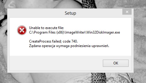

    malutka860306
    Posts: 6
    Believe me, if I had to buy an oven for the second time, I would buy the most ordinary one, because this is my ass, I wanted to make my life easier, and I only made myself uphill, well, a wise man after the damage ...
    I have a problem with this program to unpack the files you sent me ...
    An option pops up as in the picture
    • Oven Amica EBI81074 ERROR CARD SD problem.jpg (33.79 KB) You must be logged in to download this attachment.

    Rate: 4487
    This is interesting. So it doesn't start?
    • rufus-2_4.exe (824.41 KB) You must be logged in to download this attachment.

  • #5 15082197
    malutka860306
    Posts: 6
    Not. Nothing happens, I can't even find the file in the folder. Despite the fact that I will go through all the stages of the installation and at the end I get such a message, the file is nowhere to be found ... strange

  • #7 15082207
    malutka860306
    Posts: 6
    If I simply unpack the file via Winrar, it pops up saying that the file is corrupted.
    I normally spread my hands.

  • #8 15082218
    Piotr2608
    Posts: 5386
    Help: 851
    Rate: 4487
    I will say this - it works for me, I just recorded an image on an SD card using the program from the second post. Update WinRar from there, just in case.

  • #10 15082229
    Piotr2608
    Posts: 5386
    Help: 851
    Rate: 4487
    No - these 3 files are one file. Due to the fact that the electrode upload accepts files up to 50MB, I had to divide the file. You download all 3 files and by clicking on the file named hns_part01.rar you extract it.
    You will see a "system" image of about 2 GB and you upload this image to the SD card using the program included in the 2nd post.
