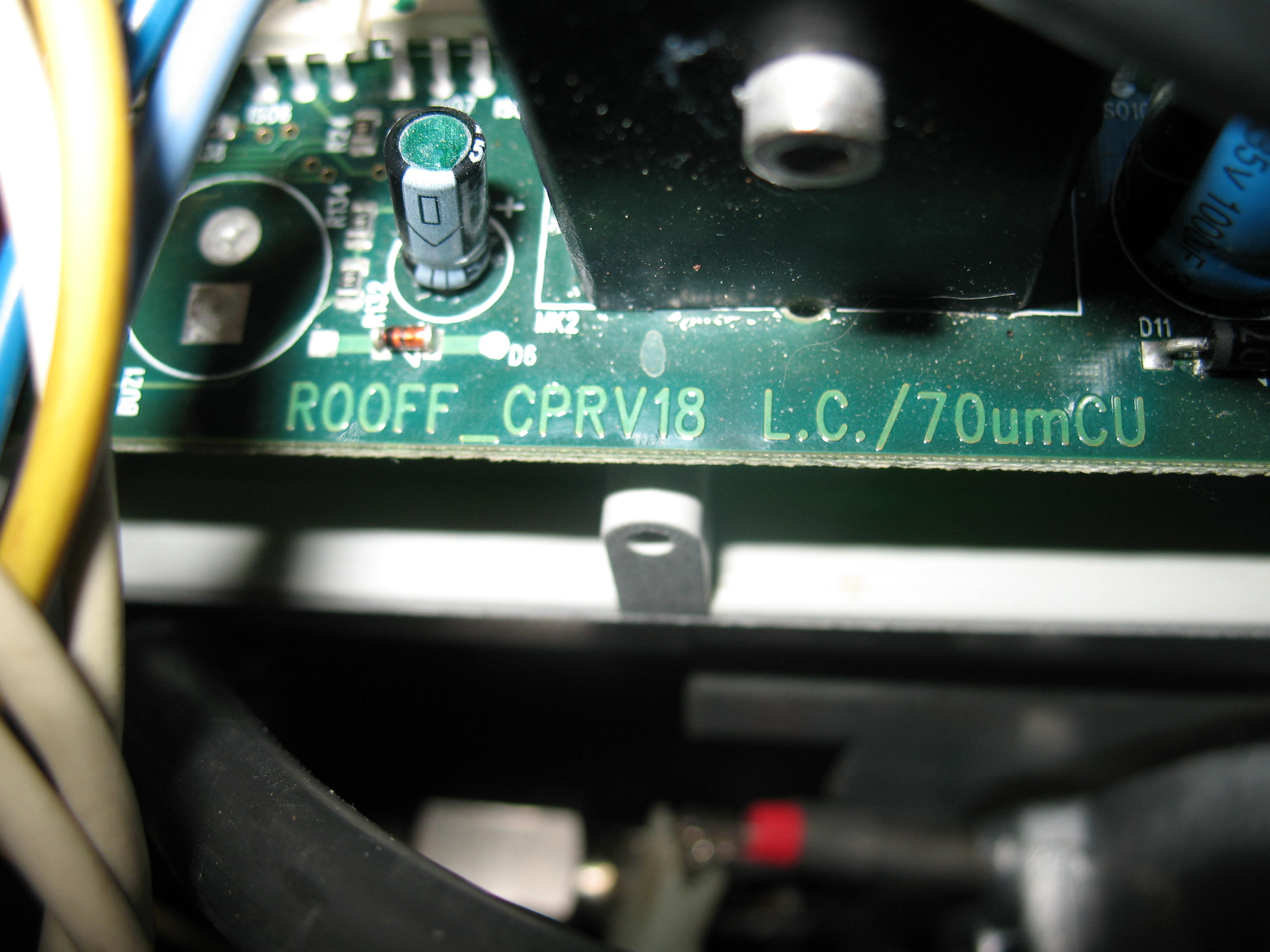

    I put Saeco coffee machine on my feet and another problem appeared. Namely, when the test is done, the text pops up to bleed and immediately afterwards an inscription will pop up to fill the water tank. Unfortunately, even after pouring water, the message does not go out. I'm not sure I connected everything right. I got it quite a long time and it was repaired several times and not completely removed. After all, despite the system of control I have made myself, I'm not sure anyway, because not everything was previously harassed.
    If someone had a diagram, or picture of connecting the control module, then I would be grateful for the release. Well, unless the reason lies somewhere else.
    The control module is on the ROOFF CPRV 18 LC board

    I am one step further. The reason for the continuous display of the message FILL WATER TANK were badly supported cables. The wiring diagram would still be good.

    As for connecting the disc, I'm not sure myself, because I got this machine from a colleague who can not tell me who was buried in front of him. I have already detected three connection errors, so I was looking for a connection scheme (name of the board in the first post of ROOFF CPRV 18).

    The problem was solved. The cables from the pump and solenoid were replaced. As I wrote, somebody confused it.
    The scheme you sent at first glance looks right, but I will check it tomorrow and also take pictures.
    If everything is OK, we will close this topic.
