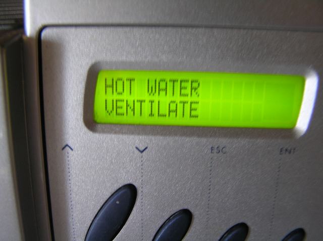

    The screen fired - I even put in a little coffee - but it seems to me that the pump sits down. It was better than usual and I can not vent the system.
    There is a Ventilate sign and it should be vented with a nozzle from the steam - but the pump is standing - it does not give steam.
    I checked the pump for "short" - and there is also a hot water button.
    Royal Professional Saeco SUPO16E Not Powering On - No Screen Reaction

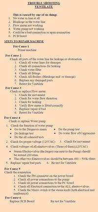

    When hot water flies and should be vented ....... and I do not want to. In the manual it is written to vent with a round valve to the steam (photo 1) but to create it you need to go further in functions - you must work to make it-think ..... :|
    I turn on the machine and the password is right- Ventilate :cry:
    Ps.Schematic to type RE 120V but you can orientate - 8 pages
    http://www.partsguru.com/user/Royal%20Prof%20120V%20Old%20&%20New%20Boiler%20SUP016RE.pdf " target="_blank" rel="nofollow noopener ugc" class="postlink inline" title="" > http://www.partsguru.com/user/Royal%20Prof%20120V%20Old%20&%20New%20Boiler%20SUP016RE.pdf < br />

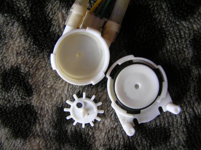

    Is this the sensor?
  • #20 4909919
    crazy_phisic
    Posts: 2244
    Help: 278
    Rate: 131
    Yes, sometimes the turbine in the middle can "hang" or the magnetic field sensor has moved inside.

    I blew into the tube and the turbine rotated.
    There is a millimeter hole from a plastic latch, and there you can see a magnet. You do not know what voltage is going in there to check if it is turning under voltage? And in front of me it is loosely packed and has two such posts. Where is its place? And is this sensor demountable?
    If the blowing nozzle works, it is possible that the flow sensor (99) has hung up.
    This nozzle does not work. You probably have to touch the button 7
    Only hot water button 5 works.
    Bugs but for a newer machine and 120V

    There is a millimeter hole from the plastic latch and you can see a magnet there. Do not you know what the tension is going to do to check if it is under voltage? And in front of me it is loosely packed and has two such posts. Where is its place? And is this sensor demountable?
    What you see through the hole is a Hall sensor, the whole flowmeter is the most detachable. You unclip the snakes and unroll the contraption, you can see the hooks on the bottom, just turn a centimeter and the sensor will spread out. In the middle is a turbine with magnets and a gasket.
    Just remember that the water hoses are connected correctly, there are arrows pointing to the water flow direction on the sensor.
    I have just a similar machine in the workshop so I will check the connection carefully.
    These white tubes are made of Teflon and there is a small chance that without any outside help one of them will start to leak, for example.
     After placing the sensor again - during the operation of the hot water button appeared the inscription - it was not there before.
    And besides, the detail has not changed.
    I wonder if sometimes on the site - someone did not rummage? But did not display his screen ......

    IT WORKS!!!!!
    This plug with a question mark goes to the socket with the symbol JP8 and the socket is behind the plug no.12 with a red marker !!! And not as in the photo.
    Almost this plug can not be seen - you can see the yellow and green wire (brown can not be seen) - three wires.
    Can not be too beautiful. He made one coffee and the end.
    Probably a matter of setting.
    When I choose coffee, the mill grinds the coffee (they have a lot of it) - two times - it should "wet the coffee" but it sounds like it tried to do it but after a while goes to the function - pick up coffee - not brewing it.
    Like the pressing functions of ground coffee, water flies but as if it did not make coffee, i.e. brew it once, and later clean water flies despite pouring ground coffee.
    In service 1 to the end and later 4 and 6 - everything flies nicely.
    How does the test before coffee - a bit like the "clutch" had a harder time doing it, it seems to me.
    Maybe I changed something when I turned this machine?
    Or maybe this resistance burned the transformer I replaced?
    Greetings
