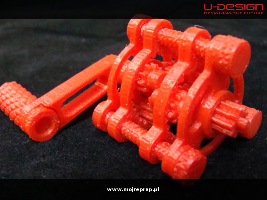

    I'm attaching a photo of a small double planetarium I printed out today (a bit bigger than an SD card). Link to the project
    http://www.thingiverse.com/thing:23030
    A video I took while printing an earlier planetarium with one section - printed on this very printer from the topic
    http://www.youtube.com/watch?v=6kspYjYA_ng&feature=plcp
    A video of the printing and operation of the planetarium powered by the screwdriver :)
    http://www.youtube.com/watch?v=hMQNO2vjUPA&feature=plcp
