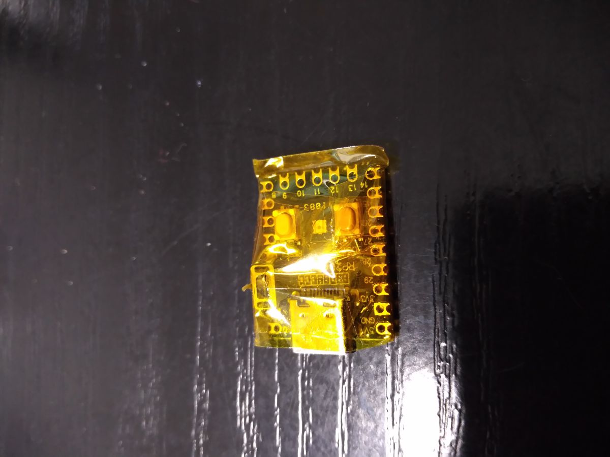

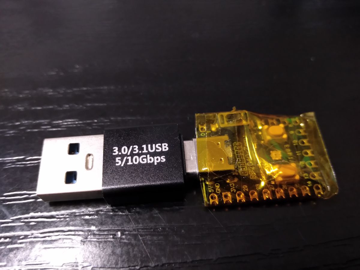

    Nothing special to brag about. However, here is a project I made. The device moves to the right by 5 pixels every 1 minute, then back by 5 pixels. Written in Arduino for a Raspberry Pi Zero (RP2040) board. You may ask, why make this when you can buy something like this? And this is for 2 reasons:
    1. cheaper,
    2. in bought ones the mouse pointer goes crazy on the screen like abnormal, which is very annoying.
    This way, the system will not go into standby mode after detecting prolonged inactivity.

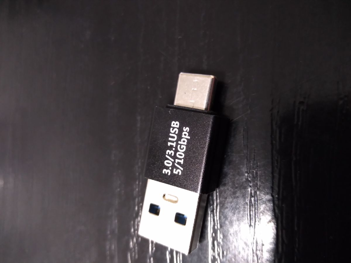

    I additionally use an adapter.
    USB-A to USB-C adapter labeled 3.0/3.1 5/10 Gbps on a black surface

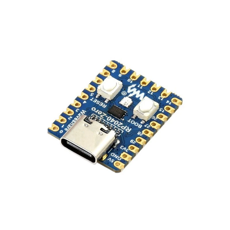

    A button has to be soldered in for activation and deactivation. Unfortunately the existing button cannot be used.
    The button needs to be connected to pin 1 a GND. To make life easier, the processor puts out a low state on pins 0, 2, 3, 4, 5, 6. This allows you to solder a small button between pins 1 and 3. Simple and no combination. The installed RGB LED will show the current operating status of the device. All in all, there is not much more to write about here.
    Uploading the code is trivial.
    In Windows 10, plug the board into a USB port with the BOOT button pressed. A folder will open and into it copy the file RP2040_simulation_motion_mouse.ino.uf2
    That's the whole philosophy.

    janchar wrote:
    Unfortunately, the existing buttons cannot be used.
    An additional button is not necessary.
    Note that if you use the Arduino board package called "Raspberry Pi Pico/RP2040" (not "Arduino Mbed OS RP2040 boards", because that's grandpa), there are additionally various very interesting and useful things available. And there is, among other things, a BOOTSEL object with which you can read the state of the BOOT button from the program:
    https://arduino-pico.readthedocs.io/en/latest/bootsel.html

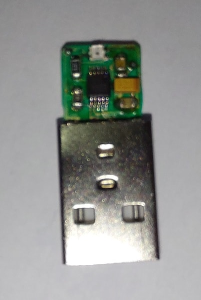

    Some time ago I assembled something like this, only based on the CH552E controller
    The worst part was the board.... it was 10x10mm long.
    Source project reference: https://github.com/wagiminator/CH552-MouseWiggler
