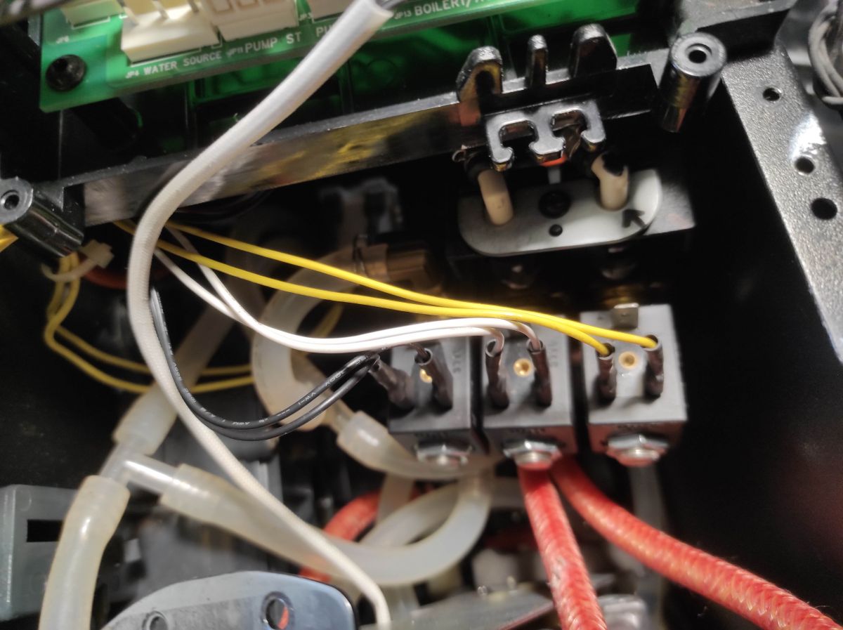

    Hello Dear forum members. And after 5 years of using Saeco Exprelia 8856/09 I got error E05. After turning on, Ekpsres tries to complete the water circuit, but it fails and E05 appears. Previously, there were problems with rinsing after switching on. The whole cycle was not always followed. On hearing it looked as if something was blocking the flow and the rinsing process started again after a while. Sometimes several times.
    I analyzed this thread and proceeded to review the individual elements.
    1. The dry flow meter does not drip on it, it is clogged and rotates nicely
    2. Nothing is dripping, silicone tubing is filled with water, no air.
    3. I pulled out the coffee heater. It is free, it can be purged.
    4. I pulled out the steam heater. And here I have a question. Should it be unobstructed, or is there a solenoid valve at the entrance? When I put a thin screwdriver in the exit, it goes deep inside. When I put it in the entrance, it reaches the maximum depth of the inlet connector + 2mm and the end. I marked the red line where the screwdriver is reaching.
    Saeco Exprelia - Filling the water circuit and the message restart the machine
    When I turn on the coffee machine, it tries to fill the circuit, the pump starts to work and the sound is as if the pump was blocked at the output. I just don't know if it's the steam heater (through the blocked heater, or the bigger one that pushes the water to the coffee heater - the heater itself is obstructed, but I don't know what is next.
    What do you think about it ? Steam heater or look further? For example, a valve behind a coffee heater? Or maybe something else?

    In these models, it either clogs the heater or one of the solenoid valves.

    As a rule, the water inlet to the steam heater is blocked. May this blockage be the only one in this heater. A spring wire, a screwdriver and there is a chance to unblock it, but beware, it happens that the wire breaks and stays inside. So in moderation or a hose, pump and pump out the syringe so that the descaler gets to the stone blockage. It may take a long time, however, with breaks of several hours, depending on the "obstacle".
    Good luck.

    Hello . too hard water. I propose to disconnect the hoses from the steam heater (first from the front) and check the flow if it is free. As a rule, the tubing closer to the back of the device is clogged with a stone at the entrance. > if the obstruction is close after checking with the wire, you can fight it, but if deep / far it is a rather difficult topic. I don't know if injecting a descaler will do the trick, but sometimes it clears it after many attempts. good luck!

  • Solenoid valve test cleared E5 error
    #47 18449217
    Marekbabene
    Hello, error E5, After replacing the flow meter, the error E5 was still there. I opened the coffee machine again and disconnected the wires from the solenoid valve 1 and took it out, then connected the wires and placed a glass under the upper part 2 and started the coffee machine. The block was rinsed, and after rinsing, I put everything back together and I enjoyed delicious coffee, Regards, Marek. Saeco Exprelia - Filling the water circuit and the message restart the machine
