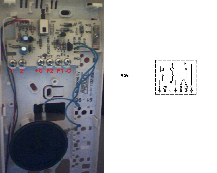

    hello,
    I bought a 'Urmet 1132/35B'.
    I have a problem with the port names.
    The names on the board are in conflict with the names of the instructions (see figure).
    Does anyone have any idea how to identify the port name?
    THX

    Hi, There are the same ports although not same names.
    So respectively:
    1- 1
    2- CA
    +G- 2
    P2- 6
    P1- 10
    -G- 9
    regards

    Hi,
    thanks for the quick response!
    I have tested the contact for the door opener (-G; P1), but these didn't match with the contacts (9, 10).
    Best regards!
