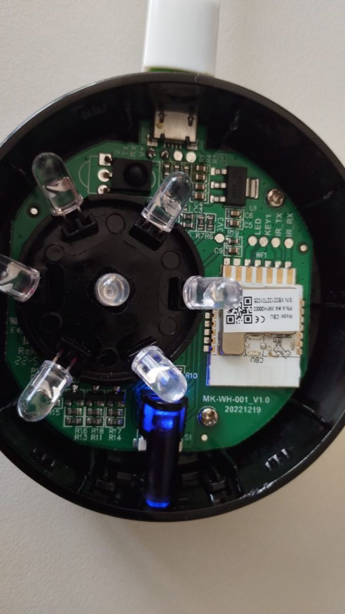

    The device below has a CBU module and was flashed with OpenBeken firmware.
    I'm trying to control an ELGIN AC. When I press the buttons on the remote control, the device recognizes it as a Samsung protocol. This is the message on the log panel:
    Info: IR: IR IR_Samsung 0xB24D 0x2929 0
    I tried to send this very same command as "IRSend Samsung-0xB24D-0x2929-0" but it doesn't work. It seems to be sending a 16-bit command instead of 32-bit, as the log panel shows:
    Info: IR: Delay 100ms
    Info: IR: IR send Samsung-0xB24D-0x29 protocol 18 addr 0xB24D cmd 0x29 repeats 0
    Info: CMD: [WebApp Cmd 'IRSend Samsung-0xB24D-0x2929-0' Result] OK
    I would like to know how to resolve this problem and how to register new controllers using the receiver.

    In the firmware documentation, the command format is as I sent. However, it seems to only work for 16 bits using the Samsung protocol. I don't know if this ELGIN AC really uses the Samsung protocol, but I would say I'm trying to add new controls and protocols, I just don't know how to do it. The way I think is, if there is a receiver, there should be some way to learn new commands from IR controllers and reproduce them when desired.
    Also, I succeeded in controlling an LG TV using the steps I mentioned (reading the IR with the device and sending the command I got on the log panel).
    This firmware is inspired by Tasmota, but there are some differences. I took a look at the code but didn't find a way to make this work.
