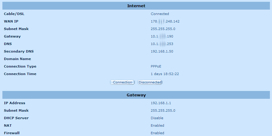

    Root router configuration
    Every now and then, it disconnects from the Internet and automatically recovers
    I disconnected the second router but I remember that DHCP was turned off and IP 192.168.2.1 was set

    Well, in the second router it enters the first LAN port and in the main router it enters the WAN socket.
  • #21 11471433
    bogiebog
    Posts: 24793
    Help: 2569
    Rate: 1530
    Router2
    - disable DHCP server
    - change LAN IP to 192.168.1.221
