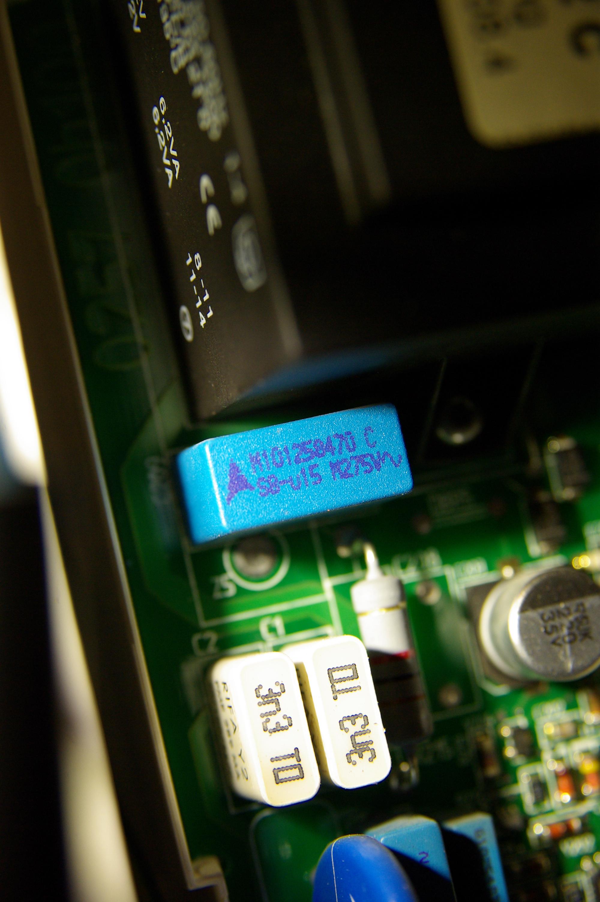

  • #41 18973178
    bigis3
    I warmly welcome.
    I am asking for an assessment if my diagnosis may be correct.
    WBS 22 C oven, started 10 years ago.
    A good two years ago I was cleaning the exchanger with taking out and rinsing.
    Last heating and summer season OK. Now the problem is growing rapidly
    Error 133 (no flame) and winter is just around the corner. Error only during ignition.
    At the same time, when it works only in the CO mode at low temperatures of about 35 degrees and low revs, it works well. Without any problems, after extinguishing, it lights up again and continues to heat the central heating.
    As soon as I turn on the hot water and the stove increases the temperature e.g. to 65 degrees Celsius. it warms as long as it is
    exceeds the temperature and shuts off according to the procedure.
    At this point, it does not want to fire anymore, despite the gas igniting with an equal flame on the burner, error 133 occurs and the blockage after a few attempts.
    Reset doesn't help. Recently from 3pm on Sunday to Monday and at 9am
    he just lit it.
    I also noticed that after unsuccessful ignition attempts in the furnace MENU
    (heat source diag.) despite the appearance of a flame on the burner,
    the ionization current is not 0.
    On Friday, the service technician replaced the electrode block as if he had set everything up and even
    the stove caught fire. Unfortunately, when I got home in the evening, the stove was already blocked (133) and it is the same.
    The question is, could it be this unfortunate capacitor?
    I watched the record and there is just such a blue one (pos.209), though this one
    has different markings in advance (in the photos) than those in your photos.
    Thank you in advance for a hint, a hint or an assessment of the situation.
    Because I don't know if I can count on a service technician
    greetings

  • #42 18973835
    krzyzak11
    Level 19  
    Posts: 245
    Help: 25
    Rate: 100
    Yes, this capacitor at the transformer is responsible for measuring the ionization current.
    The current is best compared in the diagnosis menu as you wrote with the real current on the meter

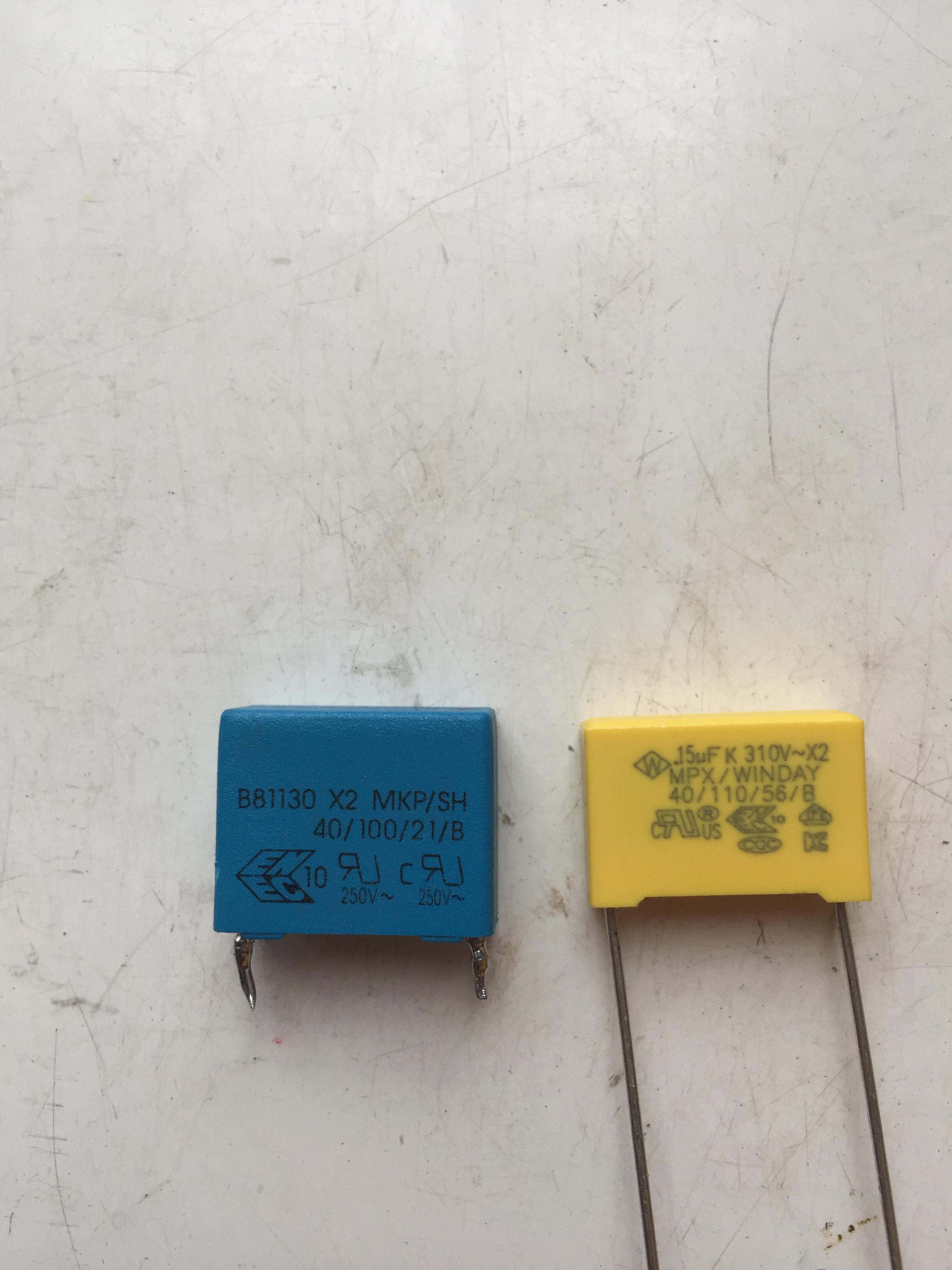

  • #43 18977177
    bigis3
    I warmly welcome,
    Thanks for your confirmation.
    Today I bought a capacitor in the store, it looks different, but apparently
    parameters and operation will be the same.
    Can you confirm that it is suitable?
    I post a photo
    Thank you and
    greetings

  • #44 18982907
    bigis3
    I measured the ionization current.
    During ignition and appearance of flame before the regulator cuts off the gas.
    For each of the many attempts, the meter shows a current of about 16uA per
    display in the oven zero uA.
    After a long time and even a dozen or so resets, the stove unexpectedly ignites and
    works normally.
    On the meter, depending on the speed and power, it is from 8 to 18uA.
    Similarly on the stove, but about 1uA less.
    So the ionization electrode works.
    I think that for the sake of peace of mind, I will first clean the exchanger with chemicals,
    then I will replace the capacitor. I hope there will be an effect.
    I have a question if the ionization current is of the right size
    greetings

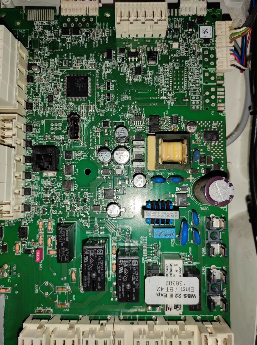

    I have a WBS 22E boiler, 10 years old. A similar problem happened to me. Namely, at start-up, the spark gives a flame for about 5 seconds, then goes out and error 133 pops up. The furnace tries to start several times until it finally gives up and only manually resetting the error causes another start-up attempt. In 2-3 times of manual reset, the boiler starts up. I bought an exchanger cleaning fluid, it was cleaned two years ago. I downloaded the maintenance manual and intend to do so in the coming days.
    I have a question, is there a capacitor on my board that needs to be replaced? From the posts above mine, I can see that the board is different and the description of the capacitor on the board is also different. Second thing, should the electrodes also need to be replaced after such a period of operation (heating DHW)?
    Broetje WBS2 22 Boiler - Error 133 Resolved, Post-Service Issues & Technician Insights
  • #52 20208133
    mindek7
    Level 4  
    And cleaned comprehensively, in accordance with the service instructions. I sprayed generously with the satin liquid, I recommend to protect the back wall with, for example, a thick foil. After undressing, there was a bit of this raid, cleaned with a liquid and a soft brush.
    The boiler starts every time.
