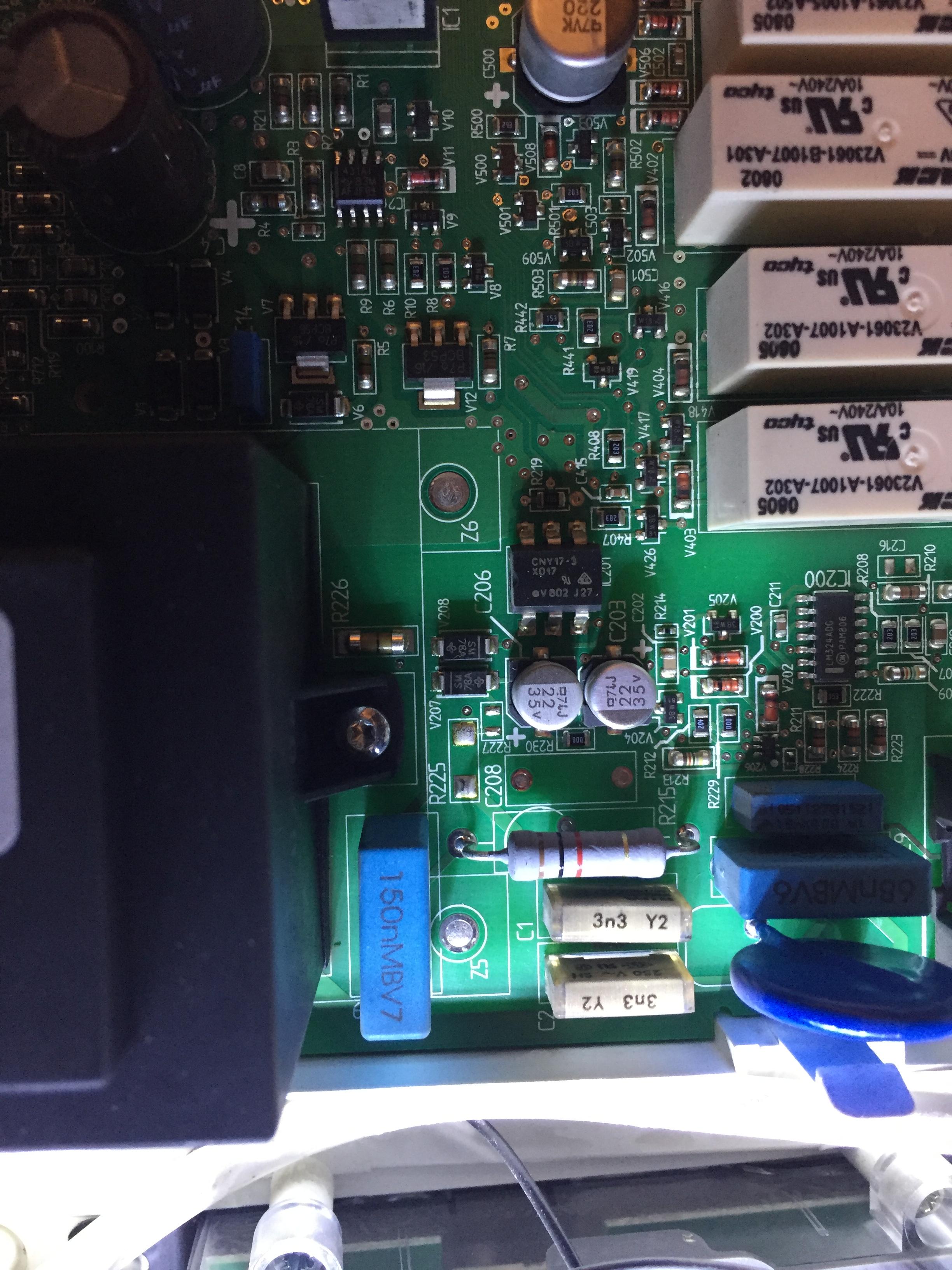

  • #7 14066545
    cody007
    Rate: 12
    The solution to this problem is the capacitor - position on the C209 board - it should be replaced and the boiler will work as it should. The cost of the tile is about PLN 60 net.
    I had the same problem, the stove turned on and worked differently - 30 minutes. 40 minutes until the burner is turned off and on again. The flame was there, but in a moment it was turned off, and so several times until the error E133, then E 153, even E 151, there was a service and it did not work. He suggested that the stove controller (PLN 1400 net), that the gas ramp (PLN 700 net). it turned out that the capacitor for 1.5 zlotys and 10 minutes. to exchange . Capacitor marking: 150nF275V ~ X2, I replaced it with 150nF305V ~ X2. More in the link - I think it's the French side - it's clean without worries (NORTON 360)
    http://www.forum-chauffage.com/chaudiere-chappee_luna-en_panne-code_erreur_e133.htm
  • #8 15012972
    Kristek
    Posts: 288
    Help: 8
    Rate: 39
    LMU64.002D100, BROTJE WBS22 stove - the same symptom as u cody007 - 150nF in the board had .... 37nF - the exchange did the job thanks cody007 !

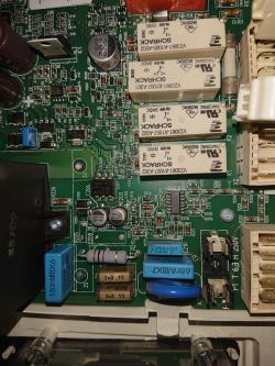

  • #9 16676923
    gramir
    Posts: 8
    Rate: 9
    Mates.
    Thank you very much for the hint, I had a similar error 133, replacing the capacitor pos. 209 on the board, the value of 150 nF 250V had the intended effect. The boiler is working properly. The photos show a capacitor.
    Greetings.

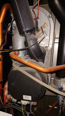

  • #15 17504409
    nikom17
    Rate: 12
    Hello, I wanted to refresh the topic a bit. I have a WBS22 boiler and I also have error 133. I am looking for the capacitor described in the post, but I have a different version of the motherboard. I am attaching photos, maybe someone will know where to look for it or what may be the cause of the error. The symptoms are exactly the same as described in the post.
    Broetje WBS2 22 Boiler - Error 133 Resolved, Post-Service Issues & Technician Insights Broetje WBS2 22 Boiler - Error 133 Resolved, Post-Service Issues & Technician Insights

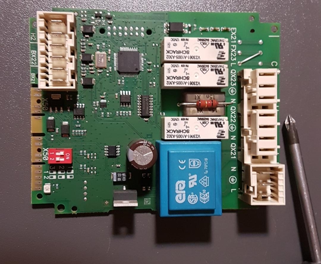

  • #26 17858501
    krzyzak11
    Level 19  
    Posts: 245
    Help: 25
    Rate: 100
    Check
    1. The color of this capacitor (blue bad, gray ok)
    2. Capacitor capacity
    3. Correct connection of phase and protective conductor
    4. Protective conductor on the electrodes, if properly connected
    5. Zayer, what kind of cauldron do you have? In the E and F series, the capacitor problem no longer exists

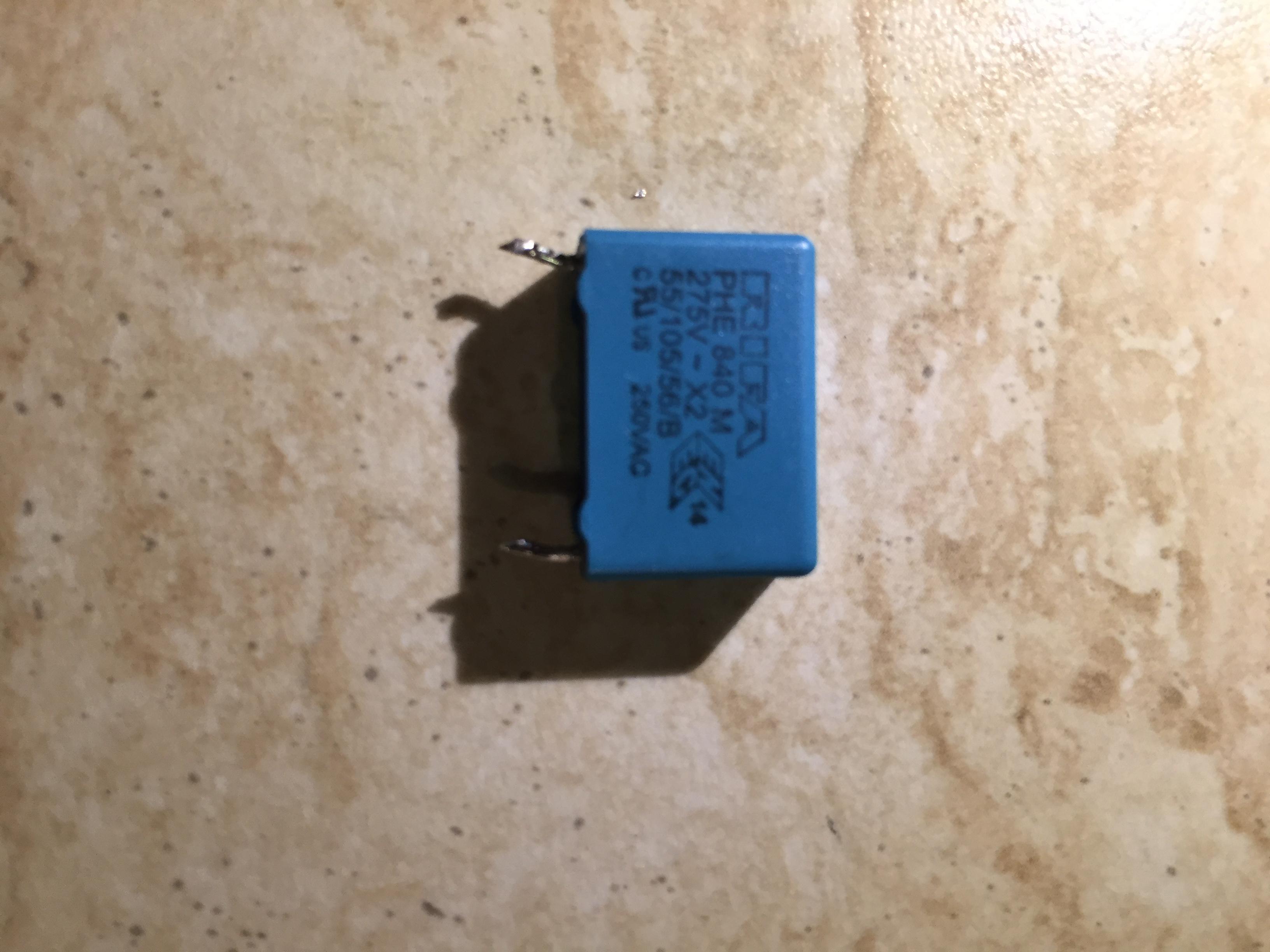

  • #27 17858680
    Zayer2
    Posts: 49
    Rate: 20
    Ad. 1 and 2 as in the attached photo.
    AD. 3. The furnace worked for many years and no one changed the poles. The fault progressed gradually.
    AD. 4. Yes, everything`s fine.
    AD. 5. Version C
  • #28 17859224
    krzyzak11
    Level 19  
    Posts: 245
    Help: 25
    Rate: 100
    Welcome,
    It is a blue capacitor plate.
    You need to check in the diagnosis menu what ionization current sees the boiler during operation and what it actually is (a meter)
    There is a special repair board for it, then you do not interfere with the motherboard. This is important because there are boiler protections on the motherboard. For example, before opening the gas valve, or controlling the burner modulation.
    One of them is broken, hence the error.
    The plate costs PLN 284,
    You can put it on, but on condition that it is definitely the fault of the motherboard, not the exchanger.
    You only put it under the motherboard.
    The new original album costs PLN 1,450.

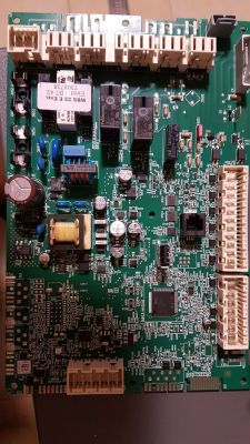

  • #30 17860365
    krzyzak11
    Level 19  
    Posts: 245
    Help: 25
    Rate: 100
    The only distributor of Brotje in Poland is BimsPlus.
    But they sell parts only to Authorized Service Providers - and this is the only channel for these parts.
    it is a rectangular blue capacitor at the transformer (black). It's marked 150nMBX6
