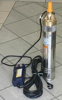

    I have a well (12 circles with a diameter of 1 meter) where the water level is 5 meters (spring and autumn) and 8 meters (summer) below the ground.
    I would like to put a pump into the well and use the water discharged from it to water the lawn using a garden hose and a sprinkler like this:
    Which submersible well pump – 8 m lift for lawn sprinkler?
    I was browsing the offers of stores and I am confused, because the pumps are different and I do not know which one to buy. Here are some examples that seem fine to my taste:
    - maximum water lifting height 8 m, so on the borderline, because one circle protrudes above the ground to a height of 1 meter
    Besides, if the switch is deep in the well, how is it turned on? Permanently the switch can be pressed and only the plug can be removed from the socket? Does she keep pumping until it hits the bottom?
    The second one I found looks like this:
    - water lifting height: 35 m, so much more than the one indicated above and there will be no problems with turning it on.
    The third is like this:
    Which of these pumps would be most suitable for watering your lawn using well water?
    With which technology, theoretically, would I have the highest pressure in my hose?
    If I wanted to use a 3/4 "hose, wouldn't it hurt the pump? Specs say 1".

    The catalog lifting height does not directly translate into the height / depth of the well. The losses in the water supply hose and the sprinkler itself must be taken into account. The first one has a head that is too low, you need a minimum of 15 m plus the pressure needed for the proper operation of the sprinkler. 1 atmosphere = 10 m water column.
    The second ALKO-Jet pump is not a submersible pump, theoretically it should be suitable because its maximum suction depth is 9m, but when the water level drops to -8 plus 1 drain above the level, it will be extremely and may not suck in.

    In that case, the submersible pump can probably be rejected, because I do not intend to spend ~ 3000 PLN for this purpose, and I can see that only such pumps have more than 15 m of lifting.
  • #4 12279110
    vodiczka
    Posts: 30251
    Help: 1185
    Rate: 4310
    In general, do not look at the head, but at the pump characteristics, because the maximum head means zero water flow - i.e. the pump will raise the water to the given height, but nothing will come out of the hose and the maximum performance is given at zero head - the pump achieves this performance when it pumps water over the same level.
    They are also cheaper, depending on the performance you are interested in
    Added after 3 [minutes]:
    You can buy Alkojeta, drill a hole 10 cm above the ground in the lining and pass the suction hose through it, it should be enough.
    Added after 18 [minutes]:
    See this ALKO product: TDS 1201/4 submersible pump about 700 PLN

    When designing irrigation, it is worth doing it from the beginning to the end so that there will be no disappointments:
    Every sprinkler (or a group of sprinklers in automatic irrigation) has a range of pressure at which it works and a range of efficiency -> For this, an appropriate pump is selected (giving the appropriate capacity and pressure at the level of sprinkler operation (not the maximum).
    The following are not suitable for irrigation:
    and) Submersible pumps like this one, for example that do not give the right pressure;
    b) Diaphragm pumps like this one which are not suitable for continuous operation and cannot be continuously submerged in water;
    Suitable :
    and) Submersible peripheral pumps such as this one , rather for small allotments;
    b) Submersible screw pumps such as this one , rather for small allotments;
    ... but the above is not suitable for direct work in a vertebral well.
    c) Submersible pumps such as this one ;
    d) Submersible pumps for operation in tanks, such as this one ;
    e) Single-stage suction pumps such as e.g. ta ;
    f) Multistage suction pumps such as e.g. ta .

Use a multistage submersible or a multistage surface jet. They deliver both the lift and 2–3 bar pressure a sprinkler needs. The AL-KO TDS 1201/4 cited in the thread supplies 35 m head at usable flow, enough for one rotating or two static sprinklers [Elektroda, vodiczka, post #12279110]

Can I leave a submersible pump in the well over winter?
Yes if the well never freezes and the housing is corrosion-resistant. Aluminium diaphragm pumps corrode; stainless multistage units cope well. One user removes the diaphragm pump each autumn to avoid damage [Elektroda, tzok, post #12287888]
How many sprinklers can one household pump run?
Divide pump flow at 3 bar by sprinkler demand. A 3 600 L/h pump at 3 bar will drive three 1 200 L/h sprayers. Attempting more causes low pressure and patchy coverage.
What happens if the pump runs dry?
Impellers overheat within minutes and the seal burns. Fit a float switch or electronic dry-run guard; many multistage submersibles include this protection [Grundfos, 2022].
