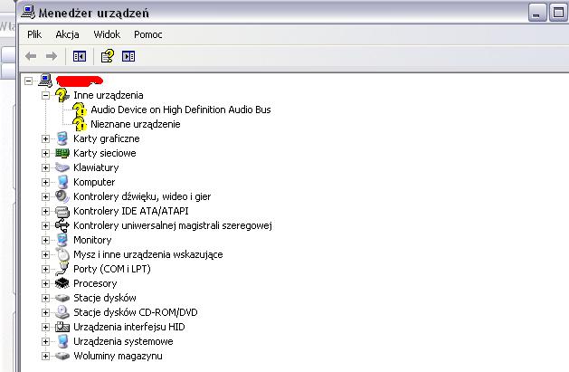

    I have this problem, yesterday I was connecting headphones to a new computer for the first time, and I noticed that only the left earphone was working. Before, both worked. What could be the cause?
    Atech keyboard headphones,
    Fatality creative headphones

    The sound drivers were not actually installed by me, but they started working after the installation: Realtek HD Audio Manager.
    I also have this problem:
    Sound in One Earpiece: Atech Keyboard Headphones vs Fatality Creative Headphones
    A Motherboard: MSI B75MA-E33 Intel B75 LGA 1155

  • #14 12292005
    michal7778
    Posts: 1290
    Help: 90
    Rate: 66
    In device manager, you have two devices marked with a question mark. You need to install drivers for them. You can find out how to do this from the link from my previous post.
  • #15 12292050
    carthmas
    Posts: 276
    Rate: 14
    Could you find it? :
    EQUIPMENT ID
    First question mark:
    HDAUDIO \ FUNC_01 & VEN_1002 & DEV_AA01 & SUBSYS_00AA0100 & REV_1003
    Second question mark:
    ACPI \ INT33A0
    * INT33A0

    Added after 2 [hours] 40 [minutes]:
    I downloaded the drivers to which you provided the link, nothing has changed. The question mark is still there. I would be grateful if you could find drivers for me also based on this manual you sent. I think I have given all the information I need above.

  • #23 12307216
    carthmas
    Posts: 276
    Rate: 14
    I have installed. No changes, driver according to Manager is still missing; p
    Maybe because I have 32 bit XP?
    Added after 1 [seconds]:
