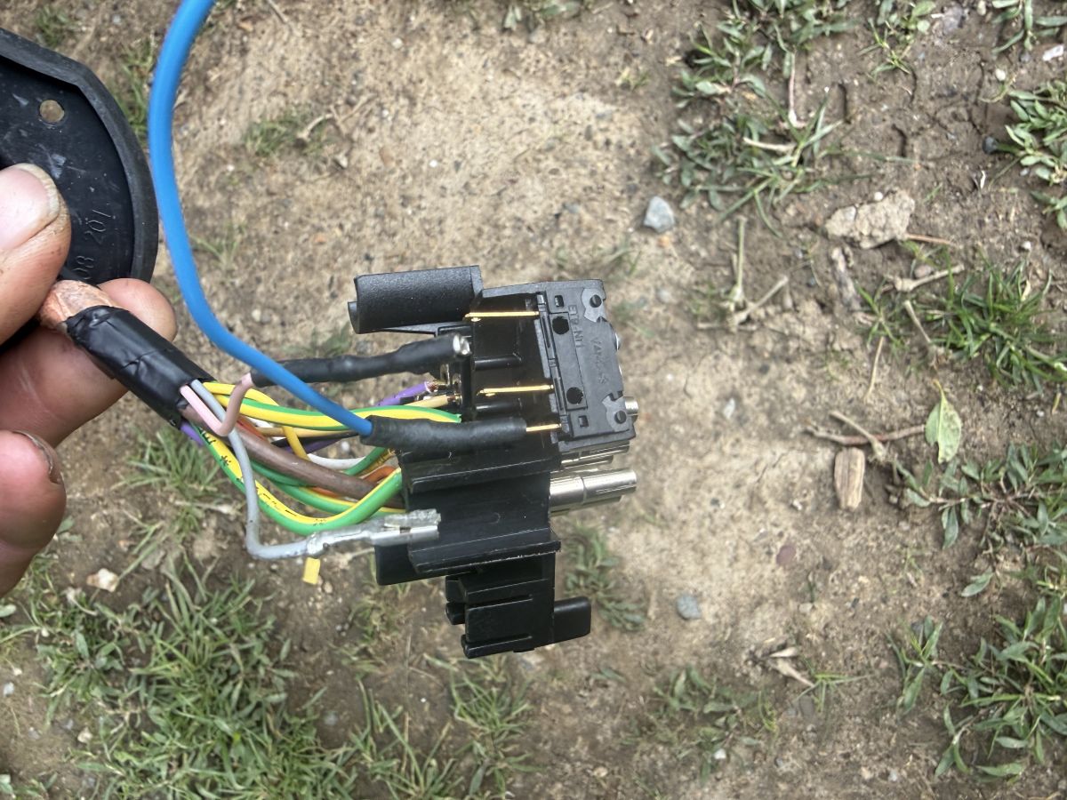

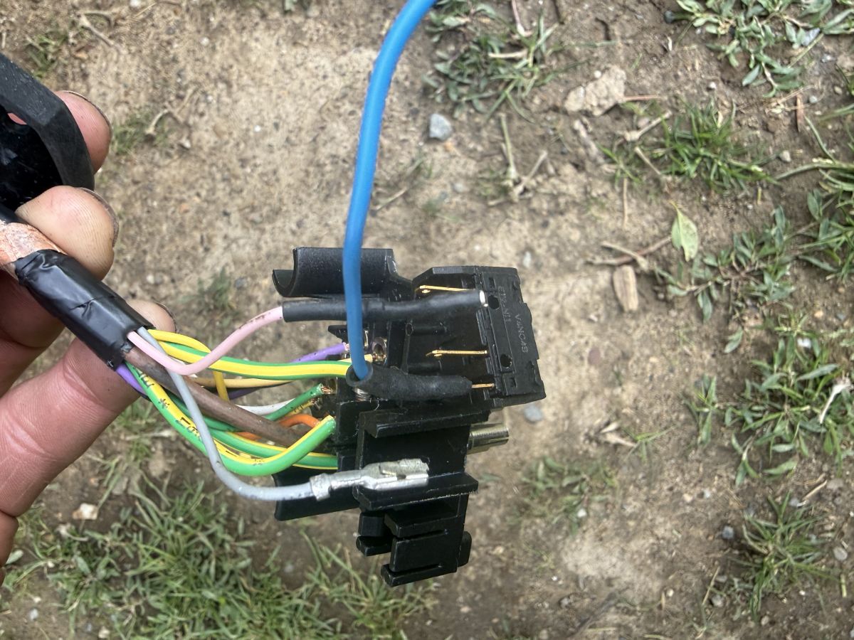

    Hello users,
    I have a request for help because I am unable to connect the plug to the 13-pin socket from the Brenderup trailer.
    All the schematics I found have the following description of the plugs/cable colors:
    1. Left indicator (yellow)
    2. Fog lamp (blue)
    3. Ground (white), pins 1-8
    4. Right indicator (green)
    5. Right position lights (brown)
    6. Brake Lights (Red)
    7. Left position lights (black)
    8. Reverse Lights (Red/Black)
    9. Constant Voltage (Orange)
    10. Charging terminal (purple)
    11. Empty
    12. Empty
    13. Ground (brown) pins 9-13
    Meanwhile, my beam - as you can see in the pictures has:
    - bridged (factory) cables 2x brown, 2x black, 2x red
    - there are 4 white (mass) wires, there are no "free" brown - mass wires
    - there is no single orange wire (there is one free one, gray)
    - there is no purple wire
    I connected brown, red and black stranded wires to pins 5-6-7 respectively, single yellow, blue and green wires to pins 1-2-4 respectively.
    I have no idea if these 4 loose wires are all ground - but assuming that I bridged them (twice under two white wires) and connected them to ground plugs, i.e. 3 and 13. Nothing works in this system (positions, direction, feet, number plate lights) except for the two side marker lights. The side marker lamps also do not work when the jumpered grounds are disconnected from pins 3 and 13.
    I also do not understand what the pin descriptions are on the occasion of the position of the mass wires (i.e. there was a mass of plug 3, pins 1-8 and a brown mass (which I do not have) plug 13 and pins 9-13).
    I have absolutely no idea what is going on here or how to deal with it / determine which wire is responsible for what.
    I kindly ask people with better electrical knowledge (and/or the ability to understand diagrams, because I have little to do with it) for any help and an indication of how to determine exactly what my 4 white "mass" wires are and how/to which plugs I have connect them, why the factory bridged the wires 2x brown, 2x red, 2x black (since the diagram indicates otherwise) and what is this one "free" gray wire, because I simply have no idea how it should be for it to work - because even these wires that have the correct colors and are in "their" pin numbers (i.e. yellow, blue, green) also do not turn on the lighting that they should - specifically, nothing turns on (except for the outlines mentioned after connecting the bridged, white wires to the pins 3 and 13).
    I appreciate any advice, thank you in advance!

    PIN 2a (fog light return) is used to automatically disable the fog lights on the car (why light them when they are already on the trailer or bike rack). I also throw up a description of the socket for those looking for this (the colours of the cables sometimes vary).
