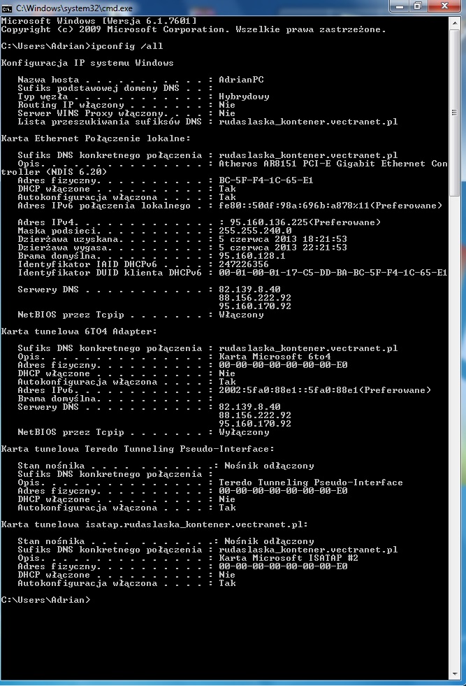

How do I properly configure a TP-LINK TL-WR842ND router with a CM900 modem when the modem shows orange fast-blinking online LED and there is no internet or Wi‑Fi access?
The router was most likely connected/configured incorrectly, so reset it to factory settings, disconnect the modem during setup, connect the PC only to one of the router’s LAN ports, and open the router’s web panel at http://192.168.1.1 using the gateway shown by `ipconfig /all` [#12385190][#12385554] Set the WAN type to Dynamic IP, then configure Wi‑Fi security/password and save/restart the router [#12385070] Nothing needs to be installed on the PC for the router to work; it should be configured only through the browser [#12386191] If the internet works directly on the modem but not through the router, the ISP may require MAC address cloning in the router [#12386396]

    And how do I connect what should I do?

    I wrote - screen ipconfig / all or trying to configure http://192.168.1.1 as long as you have the addressing from the router.

    Okay, give you screenshots

    Buddy, read my posts back again. I am not interested in your modem, only the tp-link router with which you have problems.

    Well, but when I connect the router to the network card, it only shows.

    At the moment you are connected to the modem from the provider, at least that's what screen looks like.

    I connected as you ordered and somehow managed to install correctly, there is internet, thanks for everything. :)

    So the modem cable in one of the LAN sockets is the same as the computer? This is not the correct connection, you will have a problem anyway

    I also connected the modem to the router after that and the internet and wifi work fine.

    To the WAN port (blue) in tp-link?

    This last screen is from this configuration? Because somehow I don't think so, but it's okay if it works well. Greetings.

    Before installation, I checked ipconfig again and the ip from the router showed up, then I tried to install and it worked, thanks for the help.

    Do you not realize that you did not do anything right and only reset the router helped? You did not read with understanding and did not do what was written to you - you had a modem connected to your computer, not a router, and you "configured" the modem and you wanted to log in to the modem. Finally, you showed data from the modem, not the router. Error on error. Besides, no installation of anything is needed for this and other router to work properly! Nothing installs, the router works from the moment it is plugged in. Like a light bulb. A configures only and exclusively via a web browser - entering the data received from the operator in the WAN section and individually, according to his own settings, configures the WIFI section and other sections (depending on the needs).

    From what I understood, there is internet after connecting the modem to the computer with a cable. If so, do you sometimes need to clone the MAC address of the network card in the router? After this treatment, you will be able to access the Internet via a router.
    I do not know how it is in Vectra, it can use MAC address protection. For me, at least in the cable TV from the housing association, in order to be able to divide the Internet through a router, I had to clone the MAC address in the router.
