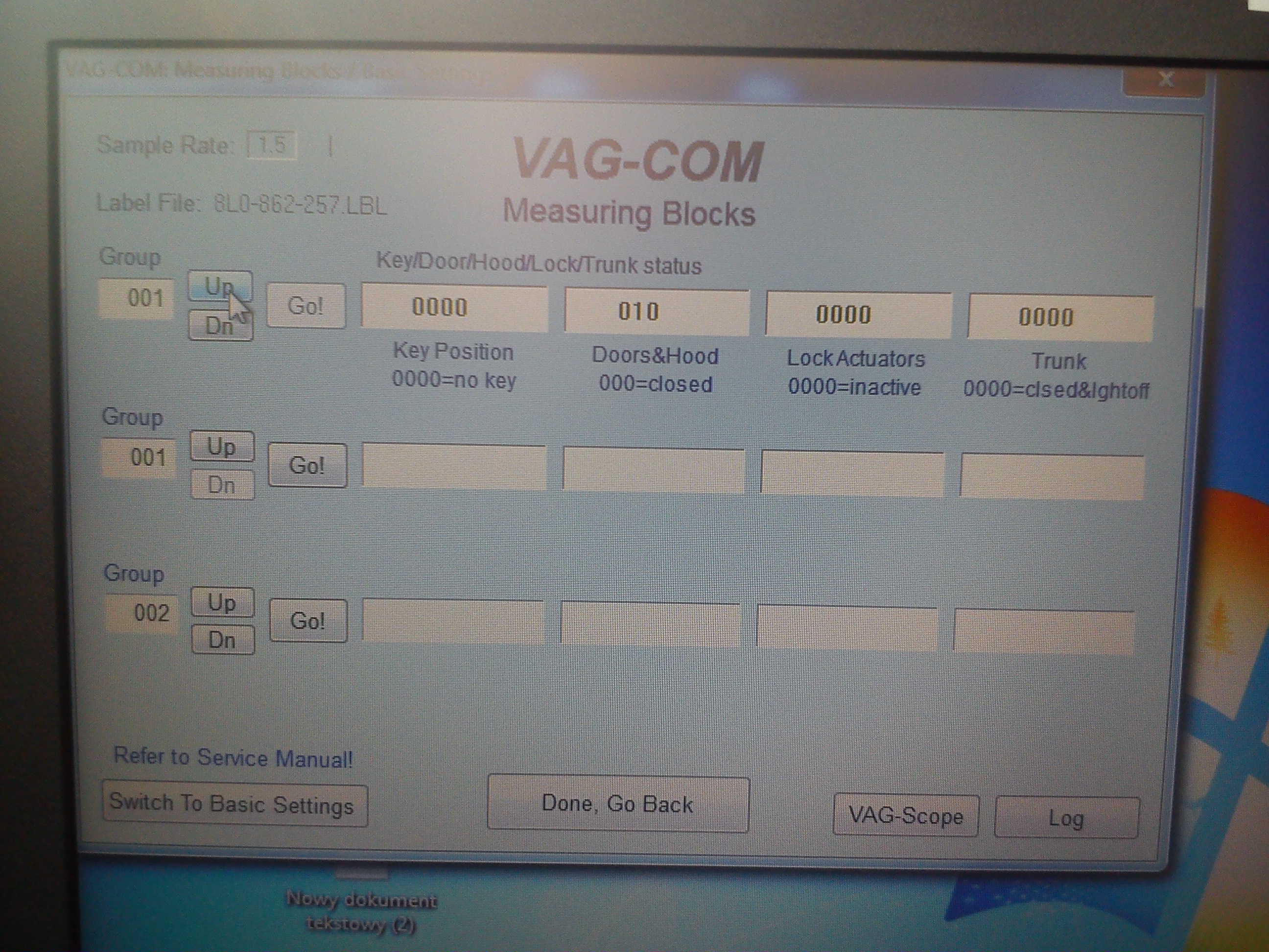

    I have a problem that some users have already had, but I haven't found the answer to it.
    I have one key (pocket knife) in which the remote control has worked flawlessly for the past two years but recently had a poor range, I decided to replace the battery and lime (of course, battery replacement was successful, but the remote control was unprogrammed)
    now I have to open the door with the key because I can not program it in vag-com too much.
    everything is nice beautifully connected via 35 central locking / measuring blocks 08 / group 003 you can see there that the remote control is working (values change after pressing the buttons)
    but after switching to adaptation in channel "01", "21" after pressing read, Error pops up. and so on every channel except "00"
    anyone ever solved this problem?
    is it possible that due to too many unsuccessful attempts I blocked the option of adding a new remote control?
    I will add that I connected it with a vag (no cable at that time), a familiar "Szpec" tried to program it with the auto com program and the second time you can say that he succeeded, but when approving the changes, the touch pad jumped to cancel and since then whether his program or vag has an error / error.
    Unfortunately, I do not have a second key and I cannot check whether the method with the ignition key and the second one in the lock will work.

  • Clarifying key position during remote recoding
    #4 16350150
    Cortez79
    Posts: 8
    Audi a3 8l Remote Control Recoding Issue: Unsuccessful Attempts and Error Messages
    Coding as above
    I generated a pin from eprom (I checked the hex calculator for certainty and it matched)
    But after entering such a message appears
    should the key position change after turning or removing the key in the ignition or is it a door lock?
