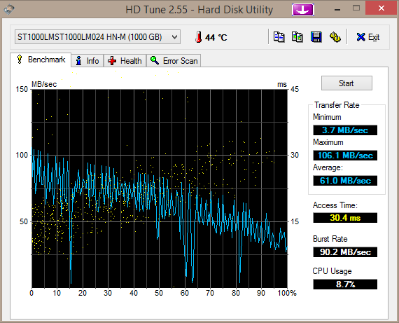

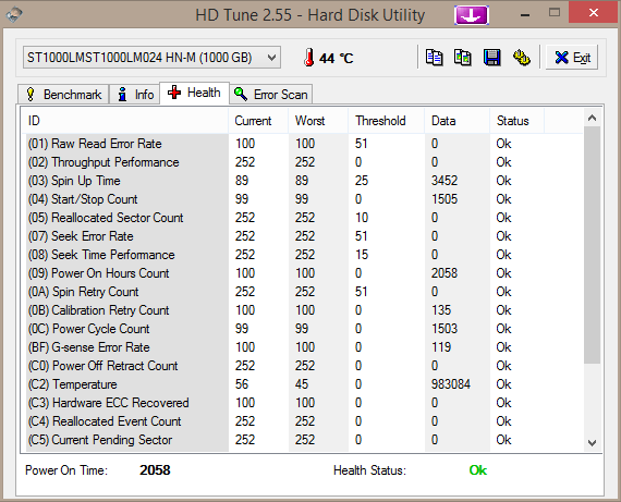

    I have a laptop with a 1 TB drive, ST1000LM024 HN-M101MBB
    And lately kompile something zamula and slow thinking copying also takes a lot of time from drive C to D, the same physical drive I have speeds from 3 - 10 MB / S ??
    I did the hd test
    Annual disk and whether such results are acceptable and whether the disc is suitable for complaints ?? Samsung - Is the drive to be replaced? ST1000LM024 HN-M101MBB (read HD tune, HDD Samsung - Is the drive to be replaced? ST1000LM024 HN-M101MBB (read HD tune, HDD Samsung - Is the drive to be replaced? ST1000LM024 HN-M101MBB (read HD tune, HDD

    Put in all SMART, because you only gave a part. Perform a surface test in MHDD. The results from Windows are unreliable. Perhaps something uses the disk during the test, such as an antivirus monitor, etc., hence such poor results.

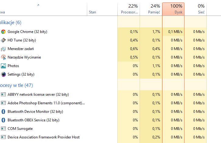

    Gentlemen, this shitty Szajsung I got hung up and only this I managed to copy, is it possible to draw the earlier result from this program?
    Oh, I'll add that in the task manager drive all the time has a 100% load

    HDDScan SMART Report
    Model: ST1000LM024 HN-M101MBB
    Firmware: 2AR10002
    Series: S2RQJ9GD301218
    LBA: 1953525168
    Report By: HDDScan for Windows version 3.3
    Report Date: 2014-09-27 17:14:46
    Num Attribute Name Value Worst Raw (hex) Threshold
    001 Raw Read Error Rate 100 100 0000000000-0000 051
    002 Throughput performance 252 252 0000000000-0000,000
    003 Spin Up Time 089 089 0000000000-0D8A 025
    004 Start / Stop Count 099 099 0000000000-05E2 000
    005 Reallocation Sector Count 252 252 0000000000-0000 010
    007 Seek Error Rate 252 252 0000000000-0000 051
    008 Seek time Perfomance 252 252 0000000000-0000 015
    009 Power-On Hours Count 100 100 0000000000-080F 000
    010 Spin Retry Count 252 252 0000000000-0000 051
    011 Recalibration Retries 100 100 0000000000-00877,000
    012 Device Power Cycle Count 099 099 0000000000-05E0,000
    191 G-sense Rate / Servo tracking 100 100 0000000000-0077 000
    192 Emergency Retract Count 252 252 0000000000-0000,000
    194 HDA Temperature 054 045 46 C 000
    194 HDA Temperature Maximum 054 045 55 C 000
    194 HDA Temperature Minimum 054 045 15 C 000
    195 Error Rate 100 100 0000000000-000000
    196 Reallocation Event Count 252 252 0000000000-0000,000
    197 Current Pending Errors Count 252 2500.00000000-000000
    198 Uncorrectable Errors Count 252 252 0000000000-000000
    199 UltraDMA CRC Errors 100 100 0000000000-0001,000
    200 Write Error Rate 100 100 0000000000-002A 000
    223 Load Retry Count 100 100 0000000000-00877,000
    225 Load Cycle Count 099 099 0000000000-3A4B 000

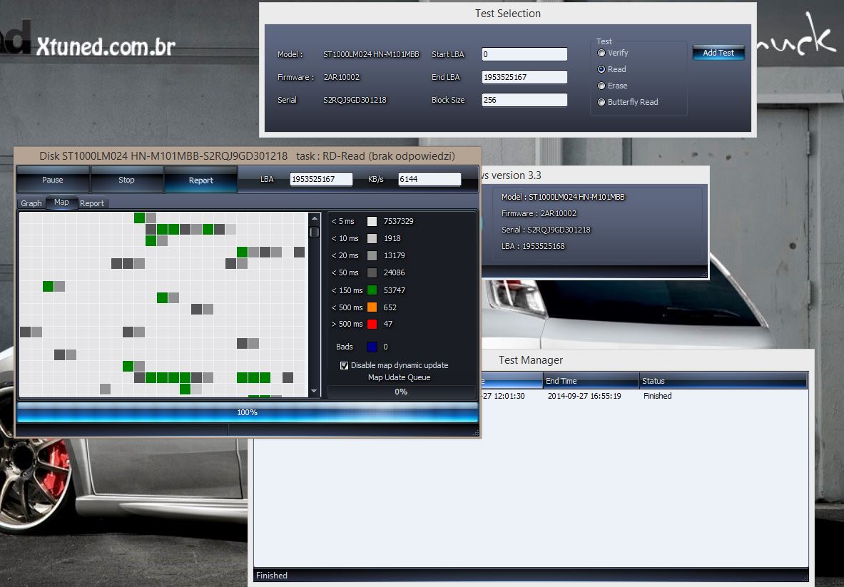

    #9 13995714
    mati211p
    Posts: 16923
    Help: 2585
    Rate: 1133
    The scan needs to be done in MHDD, HDDScan does not show anything right now, because there are free sectors, but whether they result from disk problems or from the fact that the test performed under Windows is not entirely clear. The disk has 100% usage as you do the test, it's normal, unless later also. The only thing you can find fault with are recalibrations and write errors that may indicate problems with disk mechanics or heads. Now the reading speed has increased by 10 times compared to the previous test.

    Disk consumption often has 100% even if I do nothing on it?
    And why when transferring files from a C drive to D transfer is 3-8 MB / s ??
    And someone noticed that the disk is heating up? why is it warming up when nothing was done during the anti-whirl test?
    And do you think this disc is a guarantee because I have not got a whole year ")

    I will do it well with the driver's pen, but now tell me how much such an operation lasts for a long time and how many hours will it lock my computer?
    It probably is not to be taken in; with this pendrive to boot from it
  • #13 13996276
    daniello1704
    Level 21  
    Posts: 506
    Help: 35
    Rate: 31
    Depending on the disk status: a few dozen minutes to a few hours, start with SMart in mhdd. As it will be disturbing, it is known that the sector reading will be longer, but it is worth doing as a complement to the smart analysis.
    Photos smart and scan sectors to post on the forum.

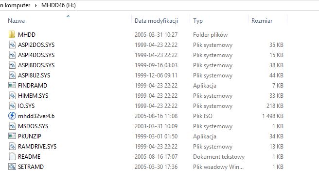

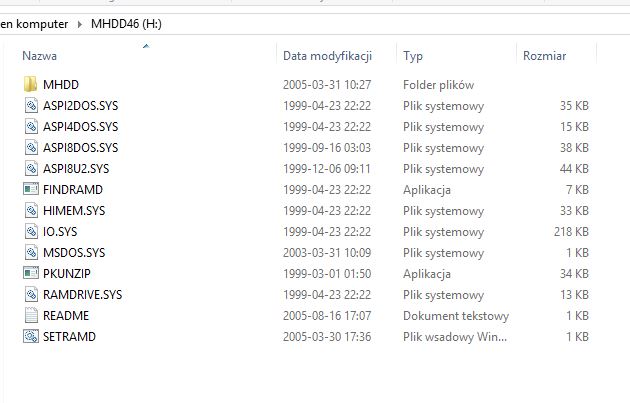

    I do not know what is going on, the program recorded it on the pen and there was a message that it was fired positively.
    I throw a screen what is in the pane
    If you have any suggestions, give it and if it does not make sense, it's terribly dirty: 0

    daniello1704
    Level 21  
    Posts: 506
    Help: 35
    Rate: 31
    I do not see the files responsible for the boot.
    You do not throw any folders on the pendrive before you win - it's pure formatted. When working with Ultra iso, you choose the source mhdd.iso and follow the instructions.

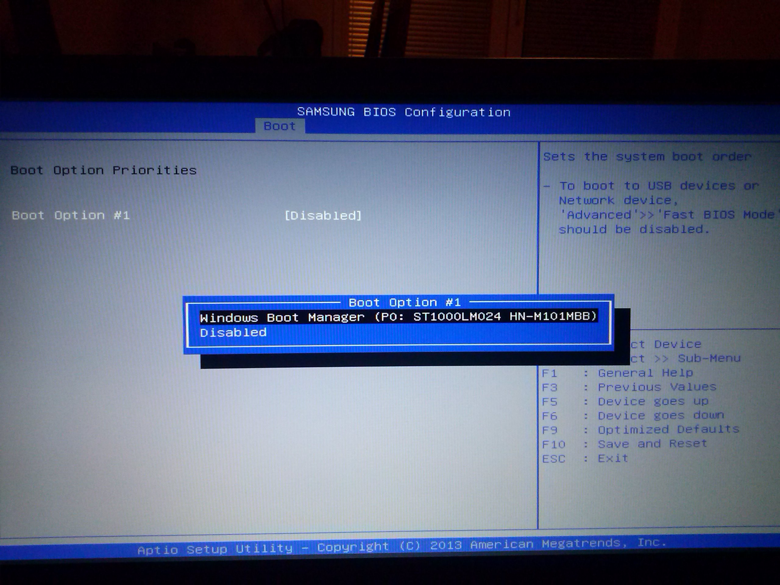

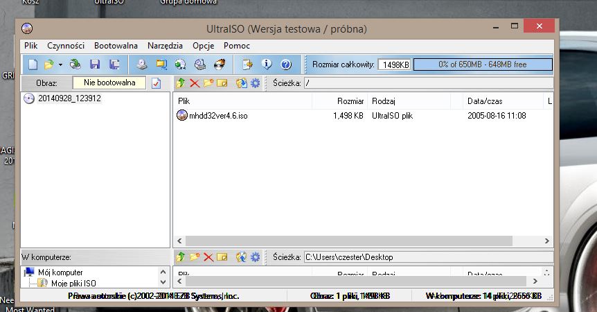

    See screenshots I do not know what runs all the time does not start with pen? by bios
    And in ultra iso I do as you wrote - botowalna and save the disk image on the pen?

    What recording method> Should be USB HDD
  • #22 14001695
    pateffon
    Posts: 101
    This is the USB HDD method I do not know what does not play but it's strange that during the boot does not see CD ROM? can only see the windows drive, maybe you need to change something in Bios?
