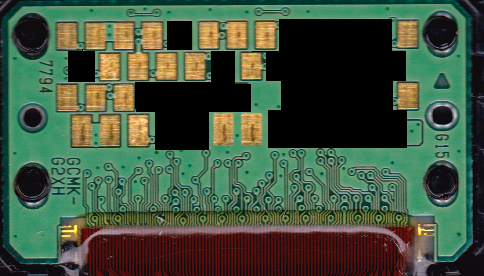

    I taped yellow and green and blue pins at the bottom and the printer only works with PGBK :cry:

    For me the printer (mp540) started working after sticking the PGBK. From poverty it can be - I have an additional black one in the color set.

    Gentlemen! I glued the contacts according to this diagram and the B200 error disappeared. When printing, it prints white pages to me without any text. Any ideas? I unblocked the head before the contact sealing treatment - as you can see, it is even worse.
    edit: Mg5350 printer

    I have a printout for the third case (third from the left). And the pins are glued like on Color (dye off - fig 3) but without the lower beam.
    As a result, I print perfectly black text from word, but I can dream about colors and shades of gray.

    If I use "grayscale printing" and double-sided printing, then printing such a "rainbow" is like a scan on the other side. I understand that I have to say goodbye to color printing on this printer and theoretically I will not need color inks anymore?
