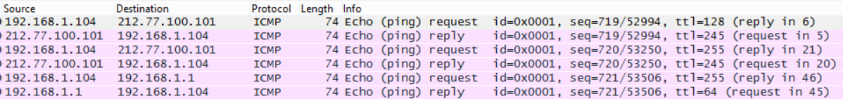

    These are return packets set by the device that responds to your ping (ICMP protocol) - your packets (pings) die when they reach the device.
    Another thing is that intermediary devices can impose their values.

    You're right, I did a short test with suspicion in wireshark of the results. For simplicity, I made 1 Echo packet each and changed the default TTL value, as you can see in the picture.
    The conclusion is that no matter what TTL value I send (as long as it is not too small for the packet to reach), what counts is what value the responding host will send and the TTL displayed in the ping response is the TTL value minus the number of hops, right?
