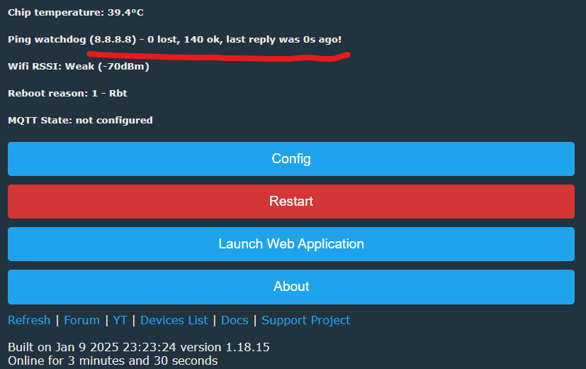

    I've done some testing with BK7231N. With 1.18.15 Ping watchdog is counting down on GUI page
    Text “Ping watchdog (192.168.137.1) – will start in 8!” on dark background

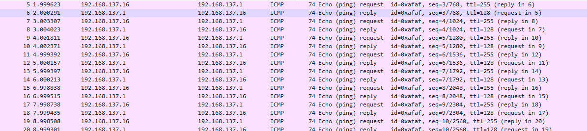

    and wireshark logs ICMP
    List of ICMP packets between IP addresses 192.168.137.1 and 192.168.137.16
    it stops working in 1.18.16 where a lot of changes were made to reduce built file size - no GUI countdown and no wireshark logs
    https://github.com/openshwprojects/OpenBK7231T_App/releases/tag/1.18.16
    https://github.com/openshwprojects/OpenBK7231T_App/pull/1500
    try 1.18.15 - does it work for you?

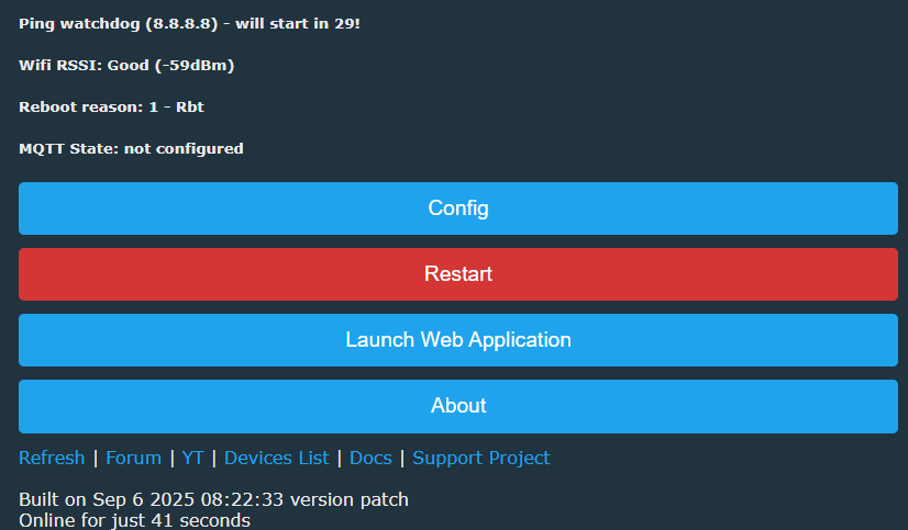

    with
    PW works again
    Device control panel with buttons: Config, Restart, Launch Web Application, and About

    I pushed change to hide ping watchdog commands if it's not enabled in build:
    https://github.com/openshwprojects/OpenBK7231...mmit/9cc5519b7ce7c65e9e348b8b57e0ff7ded47b71b
    I also checked obk_config.h - it seems disabled on all platforms. Shall we enable it on every one?
