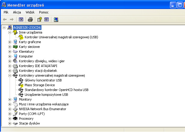

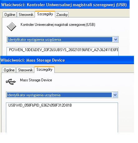

    Sorry for replying so late.
    Sounds checked. Only plug and unplug has one. The manager doesn't detect anything new.
    During this beep, it supposedly connects - mass storage device - generic usb sm reader usb device
    What is it from? mass storage? I guess that was what caused the beeping. Nothing happens after uninstalling. I'll let you know tomorrow if it's still there.

    According to the device manager, the driver for the USB controller on the CD is not installed.
    Look for the CD that came with your motherboard and download the NForce drivers from the manufacturer's website.
    The second item (mass storage device) is a card reader connected to the USB port. Driver installation will probably be required as well, but first enable the USB ports properly.
