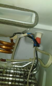

    The alarm went off in the Bosch KGN36A73 refrigerator (the diode and the sound as if the door was open). After some maneuvers, the sound was turned off, but the LED was constantly on. After a few days, it turned out that the freezer was cold and the top was not cooling. When I read about similar cases on the forum, I decided to dismantle the evaporator housing and it turned out that the entire evaporator is in a block of ice.
    After defrosting and dismantling, it turned out that the heater is working (probably from No Frosta), the temperature sensor as well, so my suspicion fell on the lack of power to the heater or a problem with the heater control. Then I also noticed that the refrigerator had not been firing for some time, i.e. it had not made noise every now and then (it was not heard at night). Can anyone tell me what and where else can I check?

  • #5 13023376
    gatik
    Posts: 43
    Rate: 22
    After disassembling the evaporator, there was no fuse on the ankle to heater wires.
    on the rear wall of the freezer, behind the evaporator, there is a rail with four colored cubes attached (fig. 2):
    - white - connected to the evaporator tube (photo No. 2)
    - black - connected to the heater
    - blue - connected to the fan
    - pink (orange in the photo) - sensor between the evaporator fins (probably the temperature) (photo no. 1).
    Resistance value on individual cubes:
    - white - break
    - black - 240?
    - blue - 31M?
    - pink - break
    What else can I check?

    #6 13023419
    iskrownik
    Home appliances specialist
    Posts: 2360
    Help: 378
    Rate: 733
    gatik wrote:
    - white - connected to the evaporator tube (Fig. No. 2)
    This is where the thermal fuse is located and from what you write it is damaged.
    gatik wrote:
    pink - break
    NTC got breaks or calibrated and the electronics turned on the heater for too long, as a result of which the thermal fuse fell.
  • #7 13026121
    gatik
    Posts: 43
    Rate: 22
    So I understand that the TNC temperature sensor needs to be replaced, which is located between the evaporator fins (in the shape of a white cylinder) connected with a pink cube and a thermal fuse that is connected to the condensate supply pipe with the evaporator (in the shape of a brown cylinder - attached with bands in the photo)

  • #9 14426864
    gatik
    Posts: 43
    Rate: 22
    I did not finish the topic by writing that after replacing these elements, everything is OK with the refrigerator (until today :) .
