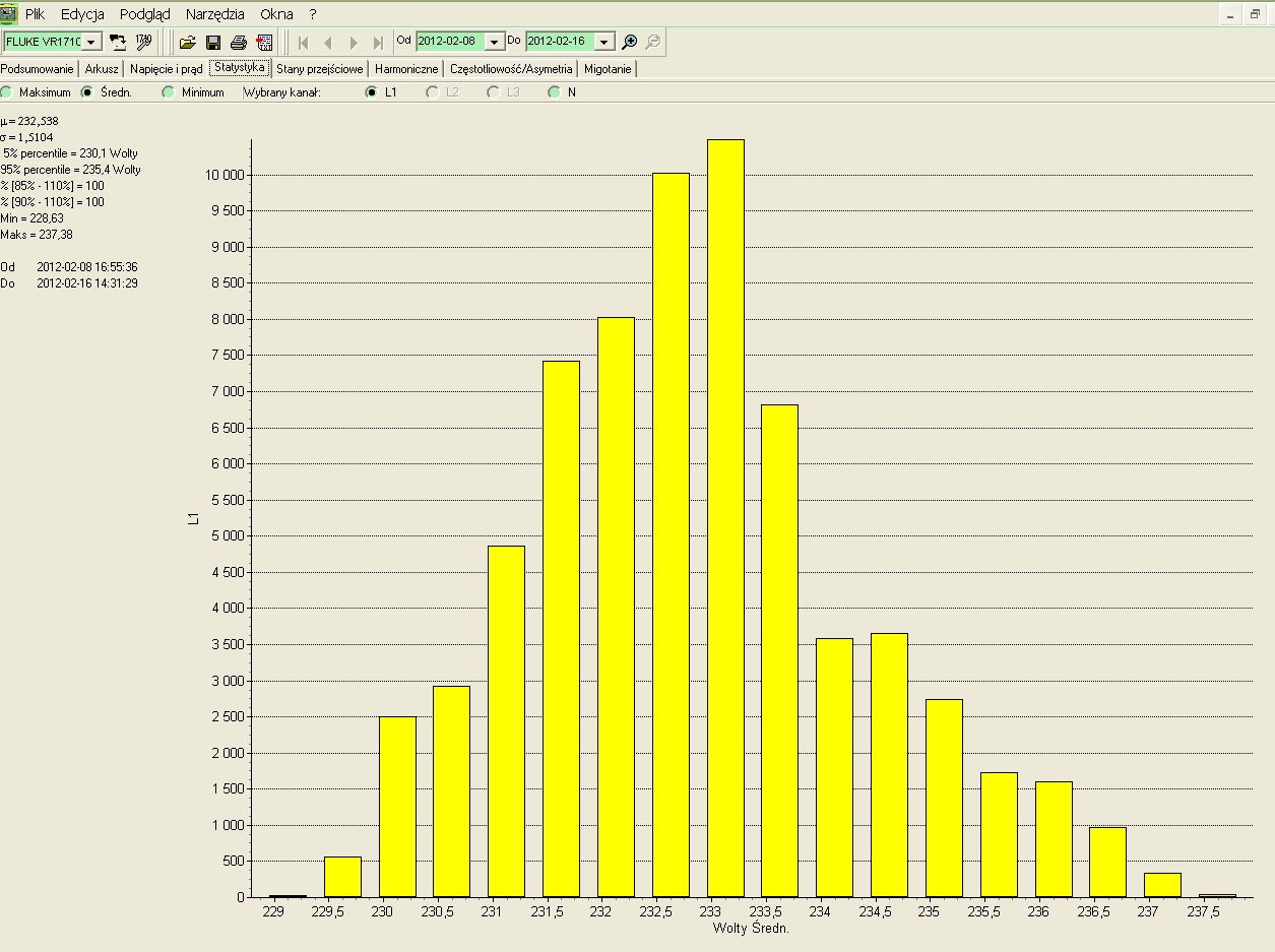

  • #79 13284987
    Piotr1971
    Posts: 8
    Bronek22 wrote:
    aksel_pl wrote:
    Can I pick it up with an oscilloscope?
    Yes and no. The oscilloscope has the ability to show, but you can't hunt it down
    You hunt.

  • #84 13285398
    Piotr1971
    Posts: 8
    If a colleague is determined to borrow such a thing, it used to cost 40,000 zlotys, today it probably costs 6,000 - 9,000 zlotys, probably for 200 or 300 zlotys you can rent them for a while.
    The program on the oscilloscope rather reports the values above the designated ones, from what I remember, the tektronix I played with had such functions.
    I assume that since a colleague wrote what he wrote on the forum, if he really cares, he will rent and check a machine with a disk and some intelligence or maybe export to a CSV file, and then you can have fun in Excel.
    No, not from me - ;) I don't have one, I also borrowed those a few years ago.
    As for what then - well, then it remains to submit a letter to ZE and wait patiently, but in their place I would immediately correct the situation so as not to aggravate the matter.
    Once, the insurer in a case known to me paid over PLN 200,000 to someone who got all computers and printers on fire. And there was no discussion, and no expertise was needed - 380V in the socket fried everything that was in the office. And no one looked at fault in the meter ;)

  • #90 13328147
    TyPeczek
    Posts: 771
    Help: 25
    Rate: 56
    jojo95 wrote:
    It is one thing to discover irregularities, the other is to prove that the fault is with the utility company. When writing an engineering thesis on the quality of electricity, I used an interesting recorder of voltage parameters from the network. It was the FLUKE VR1710. The evaluation of the parameters is based on the 50160 standard, which defines the permissible deviations, frequency, voltage and harmonic content.
    I do not see any irregularities in the chart you provided.
The discussion addresses voltage fluctuations observed in a 230/400V low-voltage network, with measured phase voltages ranging from approximately 195V to 225V, occasionally dropping to around 200V. According to applicable standards and EU regulations, voltage deviations of +10% to -15% from the nominal 230V are generally acceptable, meaning voltages between 195.5V and 253V fall within tolerance. Fluctuations can be caused by factors such as load changes, transformer aging, or network configuration, including new housing estate connections without completed transformer installations. Measurement accuracy and equipment limitations were considered, with suggestions to use devices like oscilloscopes with memory or network analyzers for detailed voltage quality monitoring. The importance of measuring at the ownership boundary to attribute responsibility was emphasized. Voltage dips may cause dimming of lighting and slower operation of appliances but typically do not damage CE-marked equipment designed to withstand short-term voltage variations up to 253V. Overvoltage protection devices and mains voltage controllers can mitigate transient spikes, though some impulses may still reach connected devices. Collective complaints and persistence in communication with energy suppliers are recommended for resolution. The discussion also touched on the impact of voltage levels on energy losses and consumption, noting that higher voltages reduce current and transmission losses, while low voltages may increase losses and affect device performance. Proving supplier fault for damages requires detailed, continuous voltage monitoring, often with specialized equipment such as the FLUKE VR1710 or Tektronix oscilloscopes. The overall consensus is that the observed voltage levels, while at the lower end of the acceptable range, are within regulatory limits, and that infrastructure upgrades like transformer replacement may be necessary for long-term improvement.
