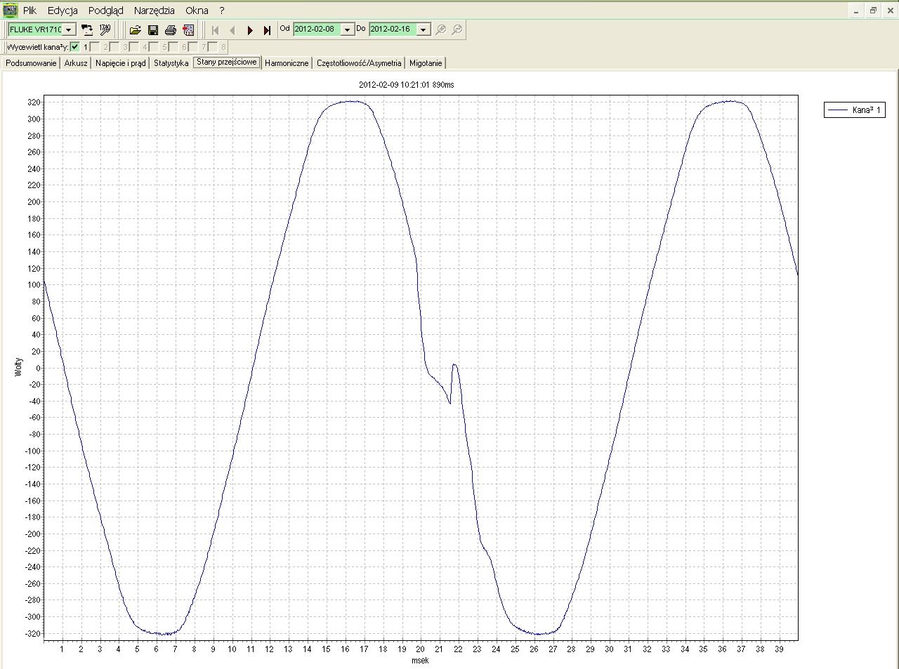

The discussion addresses voltage fluctuations observed in a 230/400V low-voltage network, with measured phase voltages ranging from approximately 195V to 225V, occasionally dropping to around 200V. According to applicable standards and EU regulations, voltage deviations of +10% to -15% from the nominal 230V are generally acceptable, meaning voltages between 195.5V and 253V fall within tolerance. Fluctuations can be caused by factors such as load changes, transformer aging, or network configuration, including new housing estate connections without completed transformer installations. Measurement accuracy and equipment limitations were considered, with suggestions to use devices like oscilloscopes with memory or network analyzers for detailed voltage quality monitoring. The importance of measuring at the ownership boundary to attribute responsibility was emphasized. Voltage dips may cause dimming of lighting and slower operation of appliances but typically do not damage CE-marked equipment designed to withstand short-term voltage variations up to 253V. Overvoltage protection devices and mains voltage controllers can mitigate transient spikes, though some impulses may still reach connected devices. Collective complaints and persistence in communication with energy suppliers are recommended for resolution. The discussion also touched on the impact of voltage levels on energy losses and consumption, noting that higher voltages reduce current and transmission losses, while low voltages may increase losses and affect device performance. Proving supplier fault for damages requires detailed, continuous voltage monitoring, often with specialized equipment such as the FLUKE VR1710 or Tektronix oscilloscopes. The overall consensus is that the observed voltage levels, while at the lower end of the acceptable range, are within regulatory limits, and that infrastructure upgrades like transformer replacement may be necessary for long-term improvement.
