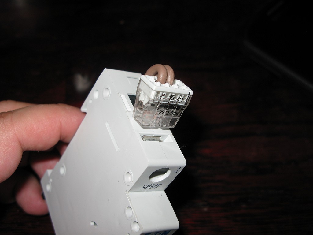

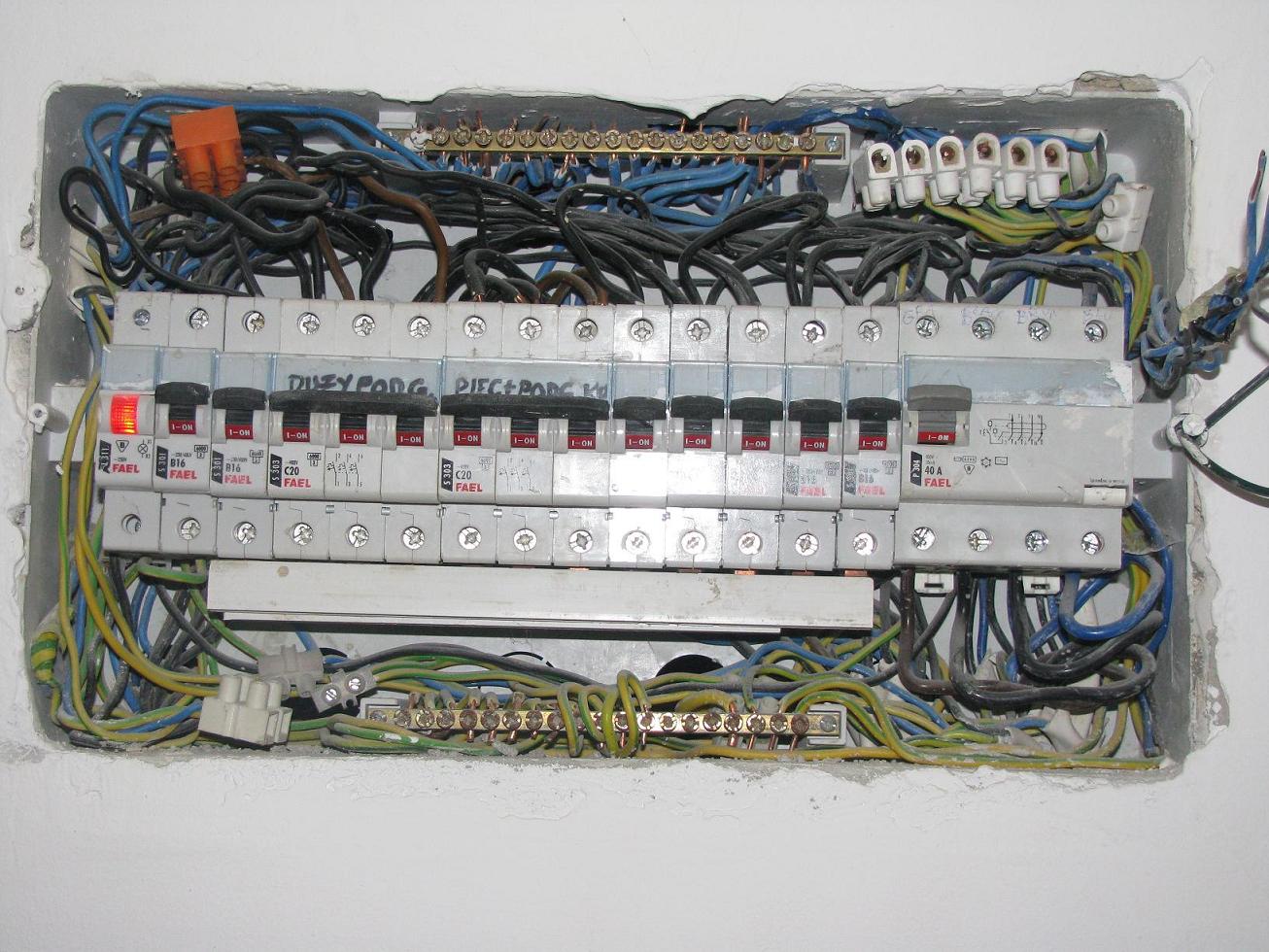

    Dear,
    I found old threads about this both here and on the sep forum. Some people even proved by loading with weights that you can connect up to 3 wires of the same cross-section, and others that this should be avoided like the plague.
    From my tests on 2.5mm cables, it turned out that two (I note: of the same cross-section) hold very well and three poorly. (If they stick tightly, it's only apparently, one can be easily moved and removed). Twisting here doesn't help, it even makes it worse, they all move. Maybe soldering twisted...
    Anyway, are there any professional methods for this? One of the regular users of this forum said that WAGO connectors. how? So loose over the switch?
    I also found these small insulated strips on the net:
    http://www.empiriakk.pl/lpi-6_czarna_listwa_rzylaczeńowa_izolacyjna_a18-0038,428,3555.html
    http://www.empiriakk.pl/lpi-14_czarna_listwa_przyl_izol_a18-1038,428,3559.html
    but it takes up one field in the switchgear.
    It's important to be insulated. In Castorama, Leroy and Grognie they have only blue and yellow non-insulated.
    Any other suggestions?

    Coming back to WAGO connectors...
    I connected it double 2.5mm2. Very rigid construction. The wire in the switch is bent and returns to the connector. It sits very tight. And there are 6 free ones in the connector :D

  • #17 13311529
    kkas12
    Posts: 17400
    Help: 1076
    Rate: 4312
    Each wagtail praises its tail buddy.
    First of all, this should not be done from the junction box switchgear.
    Is it not possible to run the installation in such a way that the circuit starts with one wire (or two) in the switchgear?
    And secondly, what's the point of placing the connector right above the circuit breaker?
    Is there no better place in the switchboard?
    And how will you connect the protective and neutral wires?
    Do you also put the connector under/above the rail?

    One of them was also doing this in the switchgear, but he used not Wago, but multi-circuit strips.
    Effect -
    Connecting Multiple 2.5mm Cables to One Circuit Breaker: WAGO Connectors vs Insulated Strips

3-step how-to: Crimp two 2.5 mm² wires into a twin ferrule.
  1. Strip 10 mm insulation from each conductor.
  2. Insert both ends fully into a 2 × 2.5 mm² ferrule until copper is flush with ferrule mouth.
  3. Place in square crimp tool and squeeze until ratchet releases; tug-test each wire for security.
