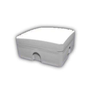

  • #6 14458867
    pol102
    Posts: 3085
    Help: 163
    Rate: 369
    The TH rail strip costs a staggering PLN 7 per item ... the sleeves are a penny thing. Crimper you say ... half of this forum clamps with flat tongs and cutters or does not tighten and tighten sharply on the strip.

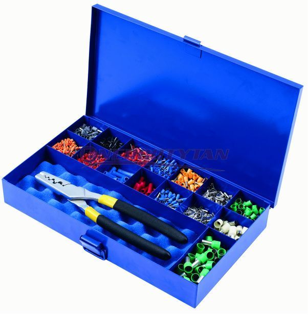

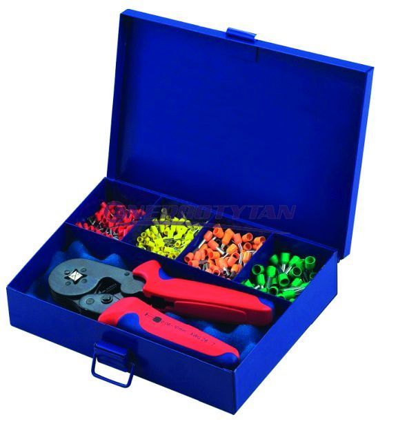

  • #11 14472955
    tomiok
    Posts: 2233
    Help: 133
    Rate: 292
    Examples of crimping tools:
    Efficiently Organize & Bundling Multiple Cables: LED Power Supplies, Halogen Fittings, & More
  • #12 14477931
    Galaxy Mark
    Posts: 27
    Cool pictures of boxes ;)
    it is a pity that you did not include some details about the tool itself - what should you pay attention to when choosing?
    The item posted in my previous post is described as "CABLE CRIMPERS FOR CABLE CRIMPERS" so what is missing in it?

  • #15 14478795
    jack63
    Posts: 11792
    Help: 851
    Rate: 2822
    To throw this crap away for scrap.
    Enter "HI crimper" in google and you will get thousands of results.
    A decent crimper has an adjustable crushing force. It is profitable to buy for "larger" jobs. Over PLN 100.
    Personally, I do not support crimping tools as in the second photo of my friend @tomiok . They knead quickly and HI ends "fly out" like a Pawlak lock.
    In principle, you should not use ferrules and wire crimping tools. Only a line!
    The wire is screw joints or something like WAGO. A few lines can be securely tightened with a good crimper after inserting them into a larger, preferably a double HI sleeve.
    HI sleeves are up to 35mm2 (then so-called flails), so with your 1.5 you can choose a sleeve depending on the number of wires you connect. The method of insulation may vary, depending on whether you only make a "flower" like the Americans or connect it further with, for example, wire.
