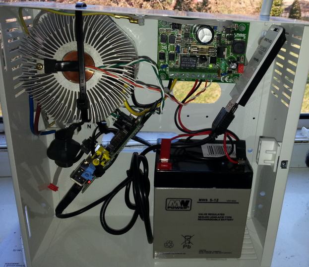

    It's not that difficult, you run a web server with php on the pi, rrdtool - for graphs and you're done. Here, for example, a box with a buffer power supply for temperature measurements running over wifi.
    http://lipowa.net:150/temperatury2.php

    If you have a file with the measurement result, you periodically upload it to the database. The rrdtool tool generates a graph which you link to yourself on the page.
