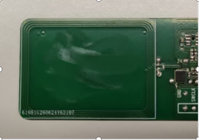

PCB Onboard Antenna
It is formed by etching PCB copper-clad laminates, featuring flat structure, low cost, and high dimensional accuracy. Its thickness ranges from 0.5 mm to 1.0 mm, depending on the PCB substrate thickness, and the NFC chip is mounted on the same circuit board.
It is suitable for meeting room door signs, desktop nameplates, flat electronic shelf labels, and fixed flat-panel devices. Its advantages include stable mass production consistency, vibration resistance, no extra assembly required, and compatibility with isolation designs for metal enclosures.

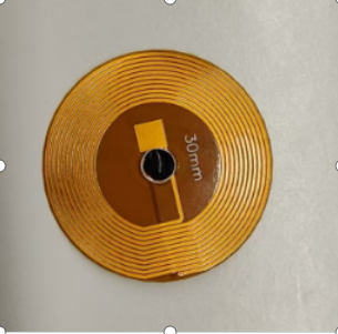

FPC Flexible Antenna
It is made of FCCL flexible copper foil with a minimum thickness of 0.08 mm. Bendable and conformable to curved surfaces, it can be directly attached to the sensing area via 3M double-sided adhesive, and connected to the main control board through 2-pin pads or connectors.
It boasts stronger compatibility and higher sensing tolerance. Ideal for curved wearable devices, narrow inner spaces of phone cases, curved door signs, and special-shaped passive tags such as smart rings and e-ink phone cases.

All three types of antennas mentioned above are widely adopted in the market. If you pursue low cost and have sufficient space on the PCB, you can choose the PCB onboard antenna. It requires customized design, yet most EDA tools now come with dedicated plug-ins for NFC antenna design to assist you in rapid layout development.
If your housing has limited internal space and curved structures, the FPC flexible antenna is your ideal pick. It can be bent and customized into special shapes to fit different housing contours.
