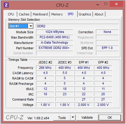

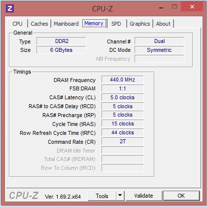

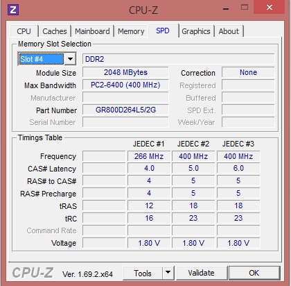

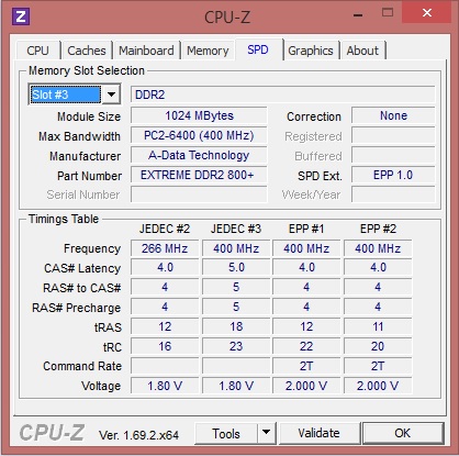

    I use 4 dice: 2xadata extreme vitesta 4: 4: 4: 12 1GB + 1x adata extreme vitesta 2GB + some kingmax with 5: 5: 5:15 timings. All dice are clocked at 800MHz.

    maciwi3 wrote:
    And record a video for you
    No, but show the "memory" tab from the CPU-Z program

    #8 13642643
    maciwi3
    Level 19  
    Posts: 496
    Help: 21
    Rate: 35
    Did you read the wiki article yourself? Somehow I don't think so :)
    Motherboards based on modern chipsets also support dual channel mode when we use two pairs of memory with different capacities (e.g. 2x256 MiB + 2x512 MiB). - Quote from the wiki
    Here you are, screenshots from GPU-Z
    Mixing 4GB Goodram With 4GB Samsung RAM—Is It Compatible in One PC? Mixing 4GB Goodram With 4GB Samsung RAM—Is It Compatible in One PC? Mixing 4GB Goodram With 4GB Samsung RAM—Is It Compatible in One PC? Mixing 4GB Goodram With 4GB Samsung RAM—Is It Compatible in One PC? Mixing 4GB Goodram With 4GB Samsung RAM—Is It Compatible in One PC?
  • #9 13642664
    kokapetyl
    Posts: 13445
    Help: 1787
    Rate: 2105
    OK, you are right, so far I thought to get "dual" memories must have the same capacity. (this is what I have on my PC, different capacities do not give the dual effect)
