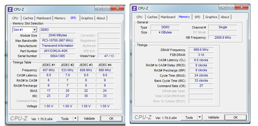

  • #17 13850983
    safbot1st
    Posts: 21951
    Help: 2719
    Rate: 1585
    rawison wrote:
    I will take a risk and take kingston in 1 bone 4gb.
    Okay, your "supposed" decision should work. I forgot to write about timings - frame latency (this refers to the type / manufacturer of dice and chips as mentioned by a colleague crazy ). Namely, the bone you are buying is the CL-9 as you can see. The question is, what CLs have the bones you already have. They should also work on cl9.
    Paste the screen from the SPD tab and the screen from the memory tab from the cpu-z program.
  • #19 13851015
    safbot1st
    Posts: 21951
    Help: 2719
    Rate: 1585
    Ok, your ram is currently working on CL9 - this kingston bone should move, but I do not give a guarantee as I wrote above ...
