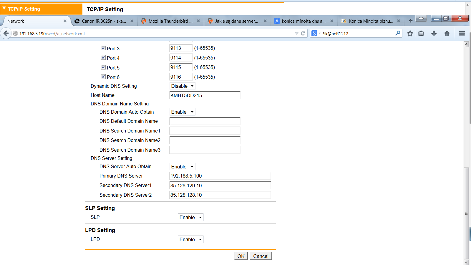

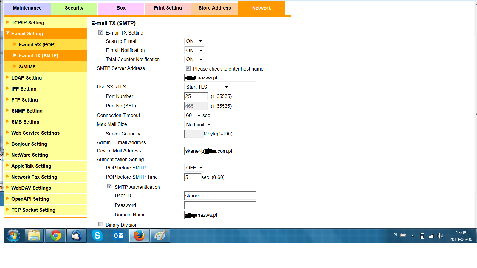

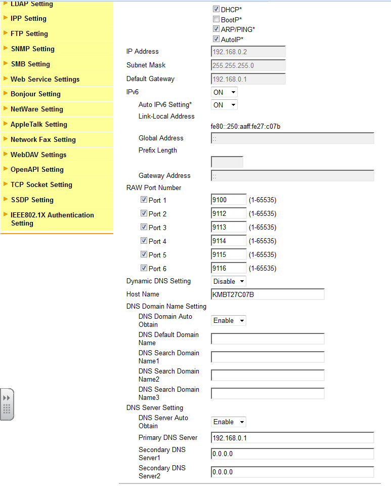

    I got a new device for my company and I have a problem with setting up scan to email. When you try to scan to e-mail, the device displays the message "Sender`s address has not been set. Cannot send. Specify the sender`s address."
    The company has an e-mail account at nazwa.pl, I set the e-mail address skaner(_at_)xxx.pl on the printer
    When I connect via HTTP to the printer, the network tab and email seeing menu are as shown in the attachment
    Please help.

    Enter the machine`s email in maintenance as the administrator`s email.
    it should work

    One problem solved :) Now I just get a message that the configuration is incorrect. In the attachment in the first post should I correct something for the account on nazwa.pl?

    Two things:
    1. Enable SSL
    2. Instead of the hostname, I would enter the server`s IP address to be sure

    Have you entered the DNS server addresses?
  • #6 13691372
    szeli33
    Posts: 18
    DNS server addresses of nazwa.pl or in the company network that we have?
    Added after 27 [minutes]:
    I entered the local DNS address as primary and then entered the pl DNS name and it still does not scan to email :<
    This is what the printer`s network settings look like
    https://obrazki.elektroda.pl/5851996800_1402297500.png
    https://obrazki.elektroda.pl/1313611900_1402297501.png
    Added after 2 [hours] 12 [minutes]:
    Problem solved. It turned out that I also had to change the TCP/IP settings. I`m closing the topic

    I`m sorry, I didn`t behave nicely, but it was out of joy, I`m already correcting my mistake.
    Network tab
    - Email TX (SMTP)
    SMTP Server Address - here I provided the server`s IP 144.76.xxx.xx
    Use SSL/TLS - Start TLS here
    Port Number - I entered 587
    Device Mail Address - here I provided my email address
    SMTP Authentication - I marked yes
    User ID - here I provided my email address, the same as in Device Mail Address
    Password - email password
    Domain Name - I left it blank
    earlier in what I couldn`t find:
    Tab: Maintenance
    - Machine Setting:
    Admin. E-mail Address: I provided my e-mail address.
    and everything started working. I hope everything is clear now

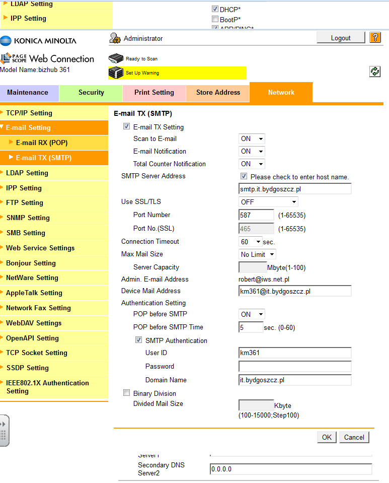

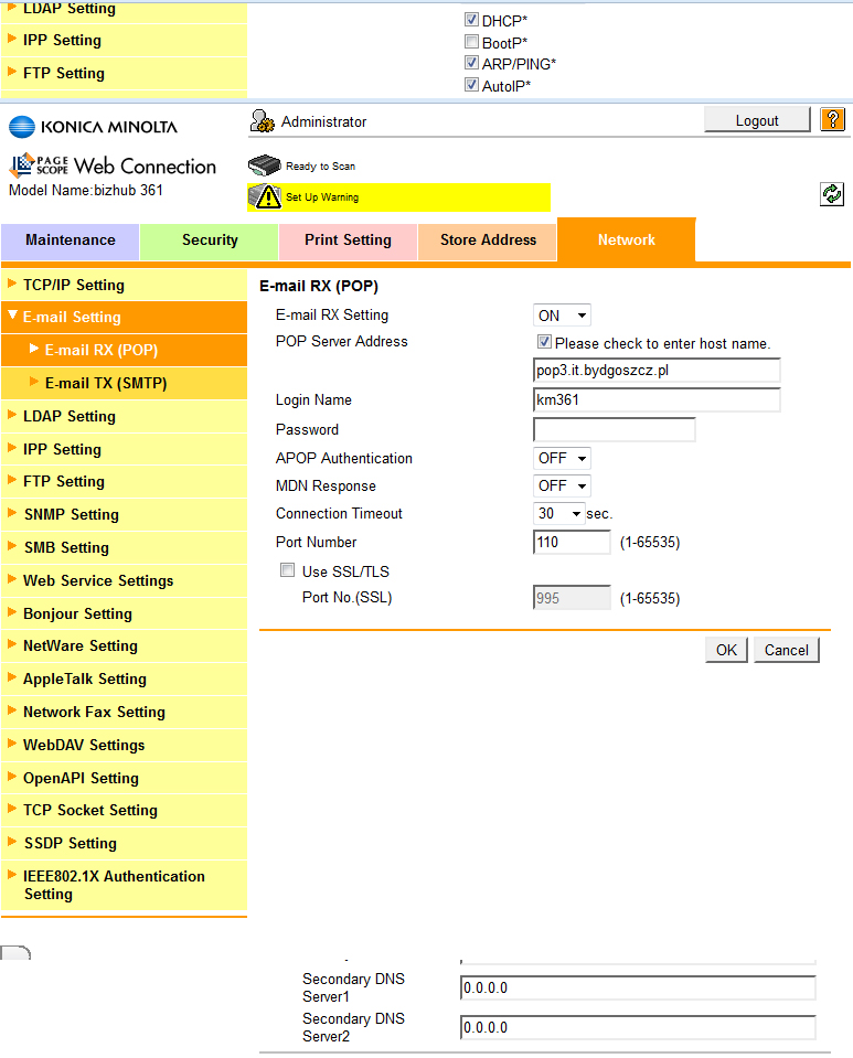

    To put it mildly, I`m fed up with this device.
    I have e-mail set on the domain.pl server, the address works, the settings are correct
    network settings:
    Setting Up Scan to Email on Konica Minolta C253 - Sender's Address Not Set Error
    email rx
    email tx settings:
    network settings to auto.

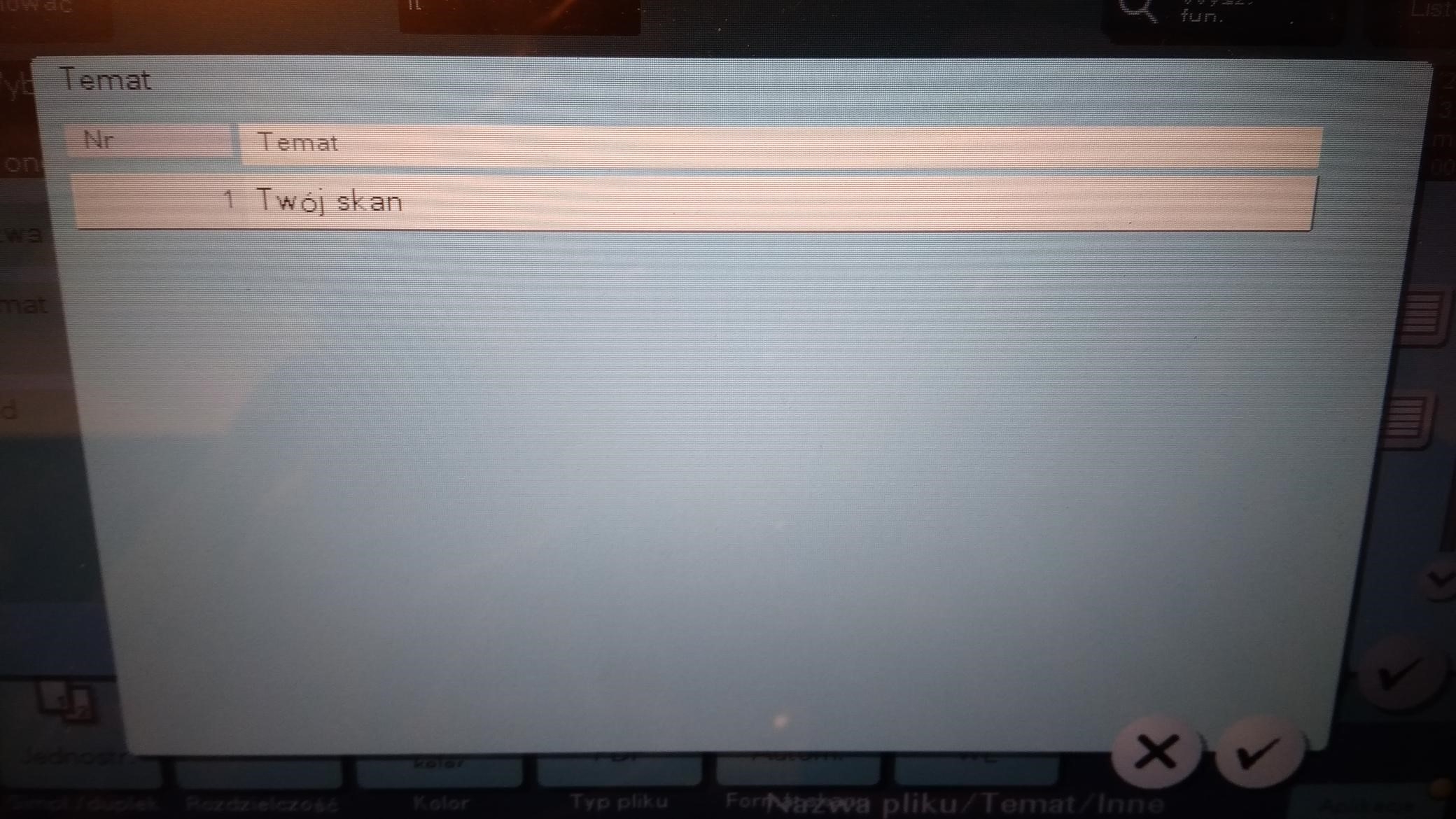

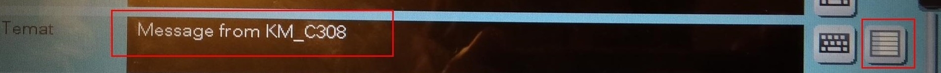

    This is me talking about how to change the email subject globally, without having to select from the menu on the printer.
    I receive emails from `Device name` - it`s ok, `Document title` - it`s ok (my name + date + number of pages)
    But the subject of the message: "Message from KM_C308"
    If I add it manually in Store Address -> Subject and then select it from the list, it`s ok, the topic I saved.
    But I want the subject to be, for example: `Your scan`.
  • #23 17744451

    Pan IT
    I checked at the beginning, it doesn`t work.
    By default, when scanning, "Message from..." is selected.
    You can choose your own message titles from this list on the printer in the window.
    and some pictures of what it looks like:
    Setting Up Scan to Email on Konica Minolta C253 - Sender's Address Not Set Error Setting Up Scan to Email on Konica Minolta C253 - Sender's Address Not Set Error
    and this is what it looks like after the user logs in:
    The option to select a topic appears only after clicking on the `menu` on the right
